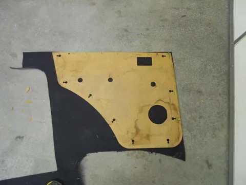

Alright guys here's a little more detail on the panels.
Strip the OEM panel down to the bare board.
Lay the board on the head liner/backing material and cut tight to the board perimeter and cut out any speaker, door latch, etc... tight as well.
Here's an up close pic of the head liner material I used.

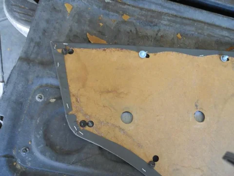

Once the head liner material is cut ... Lay it down on the vinyl and cut the perimeter so you have about 1.5"- 2" over run on the vinyl to the board all the way around.
Spray the Loctite adhesive around the perimeter of the panel making sure you get the panel and the vinyl. Let dry for just a minute before you start pulling and stretching the vinyl around the panel board. Apply a staple about every 6-8" and more in the radius areas. Trim the excess where approx. 1" is overlapped around the perimeter.
Finished panel with door handle, speaker, and door latch installed.......
