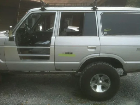

I really like the half doors. Good Job!.. Black would stand out on your cruiser for sure. I think the light grey quartz is too light. I'd lean toward the medium quartz as my first pick and then pyroclastic. That's looking at the online samples and toggling back and forth. The pyro looks like it'll stand out but, of course, not like black..
I'd like to see the chips up against it..

Paint chips have arrived from left to right (LQ,DQ,Pyro,BK) im leaning towards Pyro :beer:
