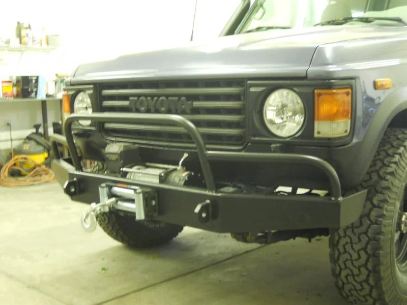

Got the front bumper and winch on but, that's it for today... Also a side view of Marley with the Monstaliner as well.

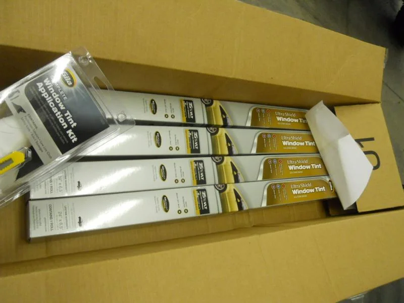

It's gonna look trick with tint. You going as dark as legally possible?
35% on the tint. Be dark enough for me. I went with the Gila Ultra Shield tint again. Like the UV protection as well as it really keeps the inside much cooler than most others I've used.

How difficult is it to apply tint yourself?
Johnny, it's not hard just time consuming. Our cruiser door windows are easy because the edges are completely framed, therefore a little room for error and the full frame helps hold the film in place better when working the tint IMO. The cargo and rear glass are a bit trickier. Leave a little extra around the perimeter and use the install tool or a credit card. Use vast amounts of soapy water, johnsons baby shampoo etc.., new razor blades and take your time. I've done a few tint jobs now and I enjoy doing it.
If you have an old door glass laying around go buy some cheapo auto supply store stuff and practice a little first. It is intimidating at first but, it gets easy quickly..

Okay, you were right, the Monstaliner looks good. You might be able to go into business building these rigs and selling them.
Looks amazing man!:beer:
Thanks Trapper.. Can't wait til I'm out with Marley on a trail, H**L I'd settle for a trip to the store with her at this point.
I love the line you went with, seems like most guys go with the front fender line instead of going with the width in the rear. I want to do the same to mine but im afraid the contrast will be to severe with my color, yours looks money, great work rev
Monstaliner has some great colors, a desert tan to be exact, request some color chips/samples. Magnetman will send you a few to look at against your cruiser. Can't say enough about this product, I'm thoroughly pleased.
Hmmm, not sure on the complete restoration scenario but, I would however, entertain the idea of getting back into the fabrication game again... :grinpimp:
