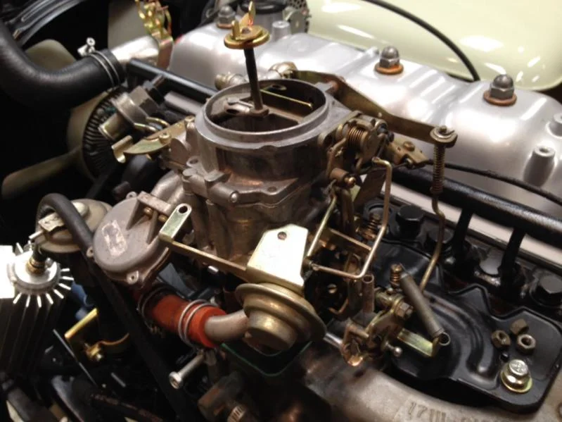

I got my carb all cleaned up and back on, also all my radiator hoses with correct oem clamps

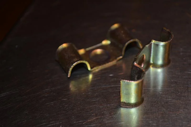

Got my hard fuel lines all in and cleaned up. I shot them with some clear engine enamel for protection by suggestion from a forum member here, thanks again.

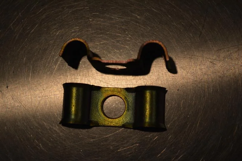

I cannot locate my factory fuel line clips so I used some I bought from the hardware store which actually do a better job, but since I'm a purist I need to track some factory ones down . Anyone willing to sell some let me know.

Fuel Line Clamps
Don,
I checked Toyota today for these and they are no longer available. I probably could source you some to keep it all original. Your 40 is looking great.
That's them! Let me see what I can find on the classifieds, thanks Colorado. Thorslc1977, thanks for the offer, I'm sure I will be taking you up on that shortly.

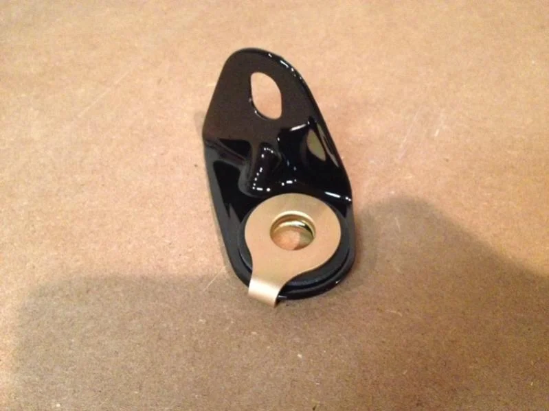

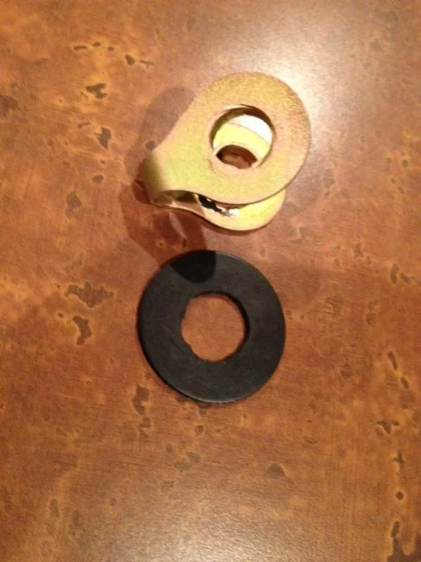

For those interested, when I disassembled my air cleaner I took off the rubber bushing brackets off and had them bead blasted and re zinc coated yellow. The rubber was brittle and fell apart.
I found some thick rubber washers at the hardware store and with a little trimming they fit right in and look factory. Here are a couple pics of the cut washers and with it sandwiched by the bushing bracket on the powder coated air cleaner part.

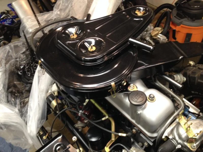

Replaced my valve cover gasket and valve cover seal washers with oem and got my air cleaner on.
Not too happy with the lid, this was powder coated by the guy that did all my blasting and is not near the quality of all my other stuff that was done by an old high school buddy. Still have to drop more stuff to be powder coated so this will be getting redone also. Might as well look perfect before I stick one of Shane's repro air cleaner stickers on it.

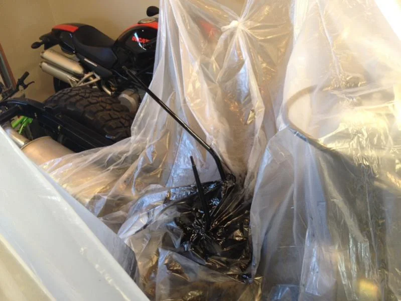

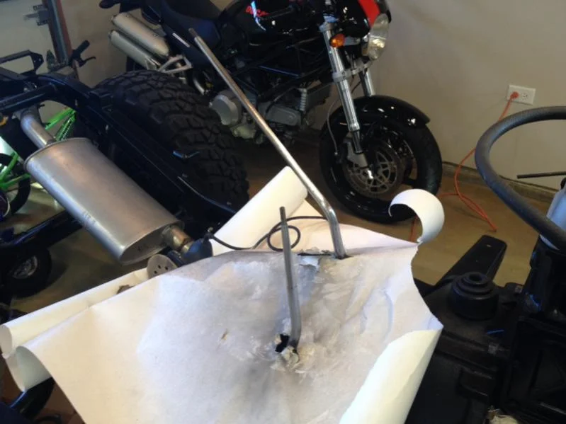

Also sanded down my shifter arms to bare metal and laid 3 coats of an industrial enamel on them. Felt like a Dexter laying out the plastic for over spray.

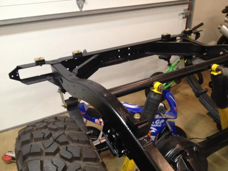

Tomorrow I have 4 buddies coming in the morning to set the tub on the chassis! Took some time today laying out the new body bushings so I wasn't scrambling with my buddies holding the tub.
