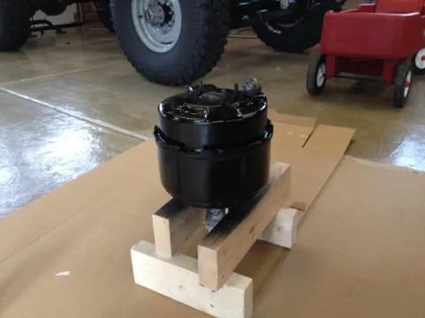

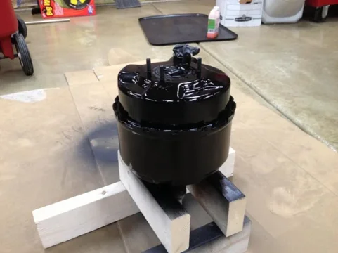

Finished restoring my brake booster here a couple of shots of the process...
I chemically stripped it down, sprayed a rust inhibitor and than a final coat of semi- gloss engine enamel.
I used Rustoleum Engine Enamel, it sprays and lays down very well and has the best protection aganist heat and solvents but cost a little bit more. I trie the VHT but it was little more flat that I wanted. Thanks-
