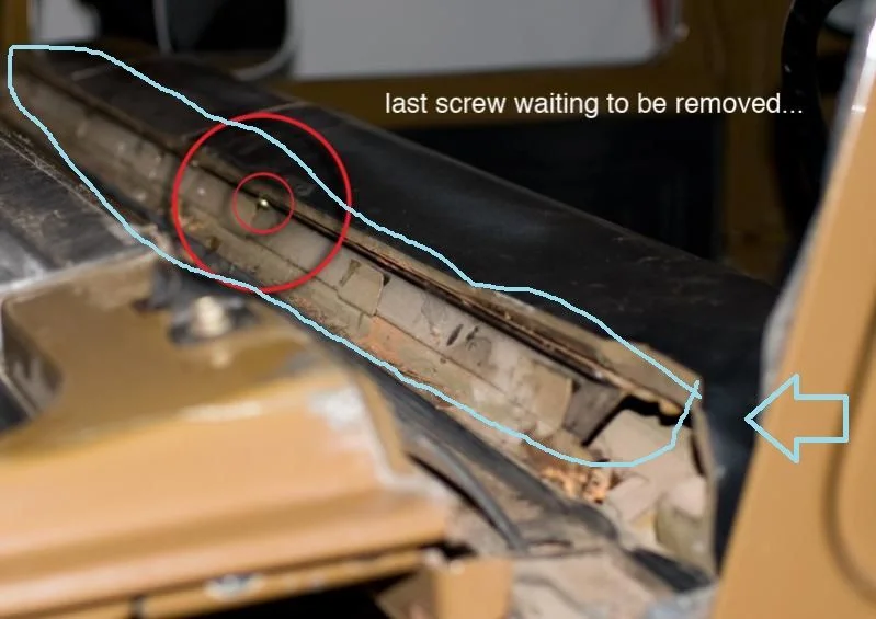

hmm i don't know what you mean by that? you ask in another post if you have all the pieces required for a dash pad - the answer is yes! It looks like everything is there to me
you're still missing the dash knob spacers though

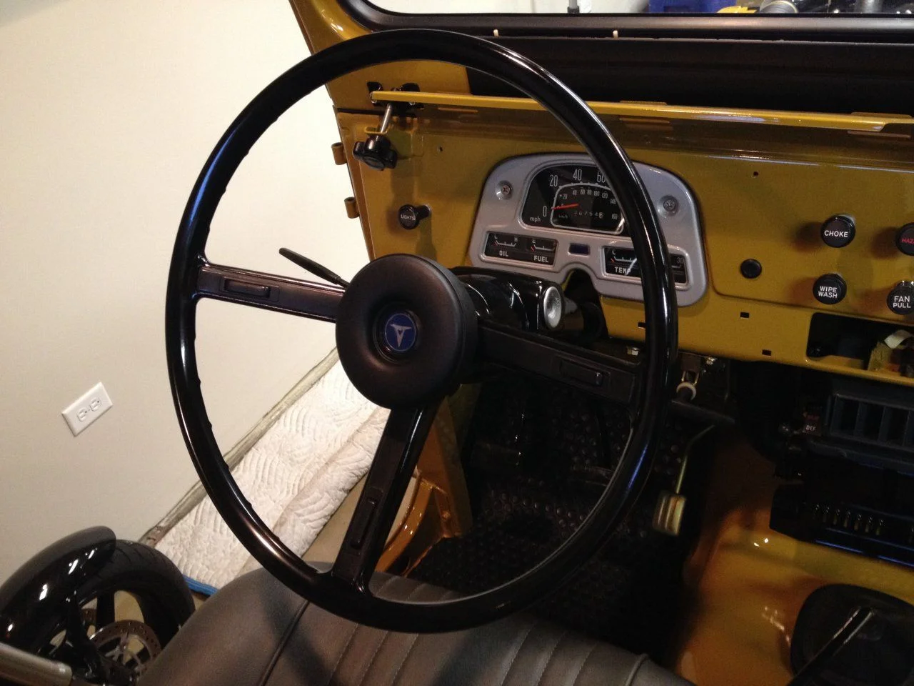

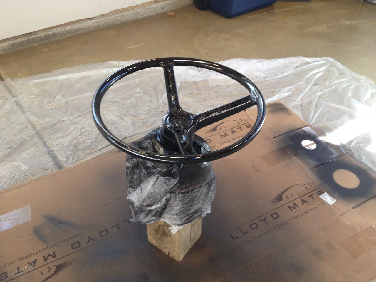

Finished restoring my steering wheel and I'm very happy how it came out. Cleaned it up well, filled a couple hair line cracks with a 2 part epoxy and than laid a couple coats of Eastwood 2K primer and finished with Eastwood 2K in gloss black. Little wet sanding and polishing with a buffing compound and voila! Also tried my new horns for the first time and they sound great, nice and loud.

I looking for this sheet metal piece, my first body guy threw it with my old dash. I have it circled in capri blue. Borrowed it from another forum member's thread.
