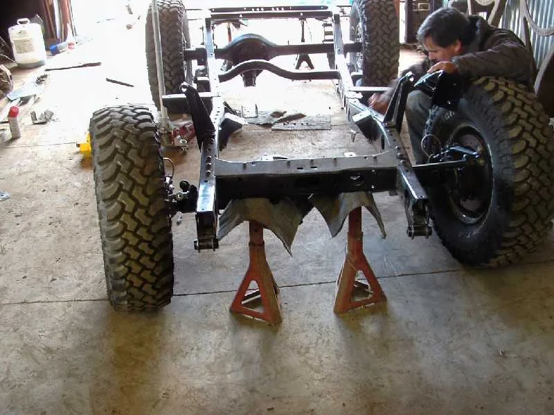

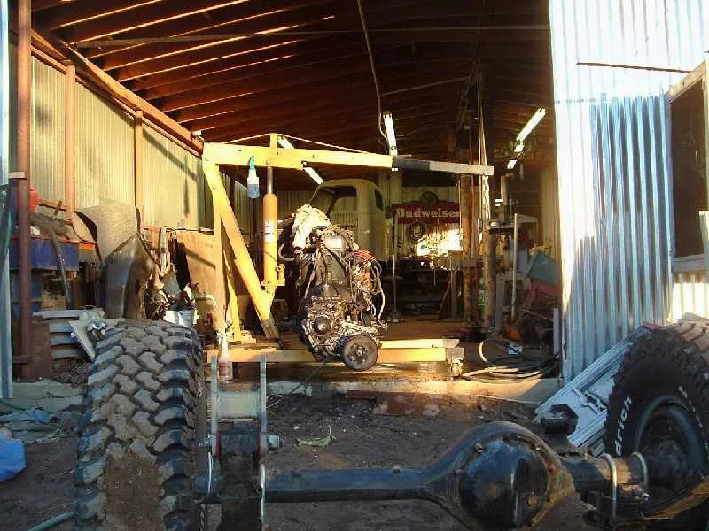

It all started last November, the 11 th to be exact.

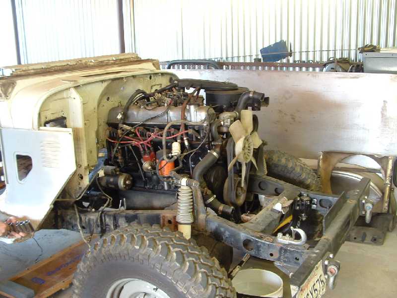

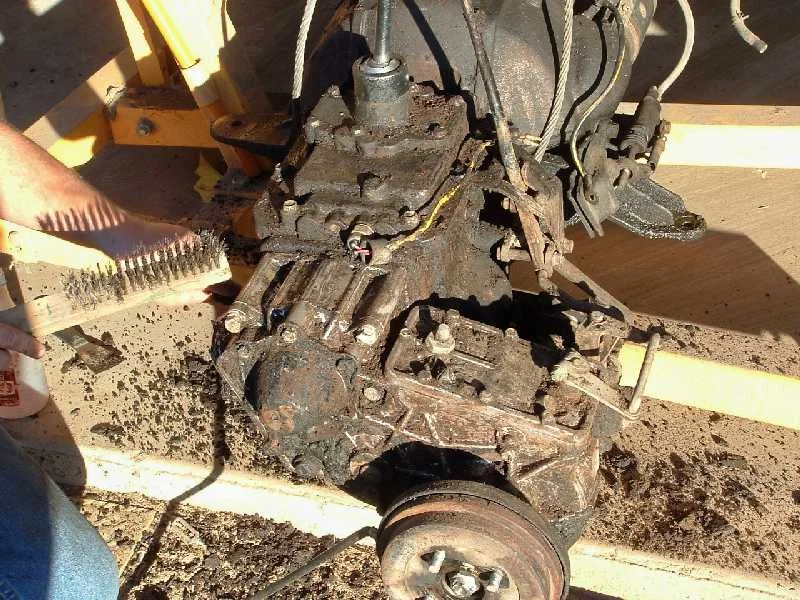

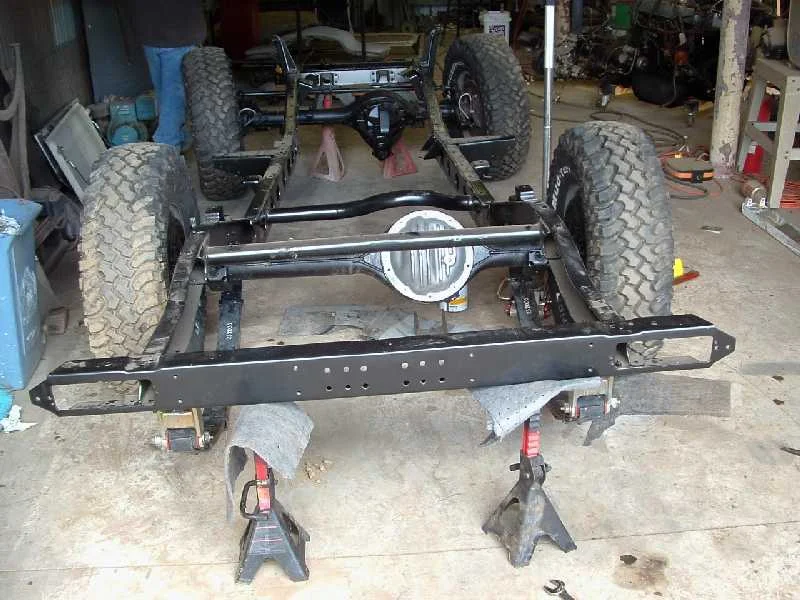

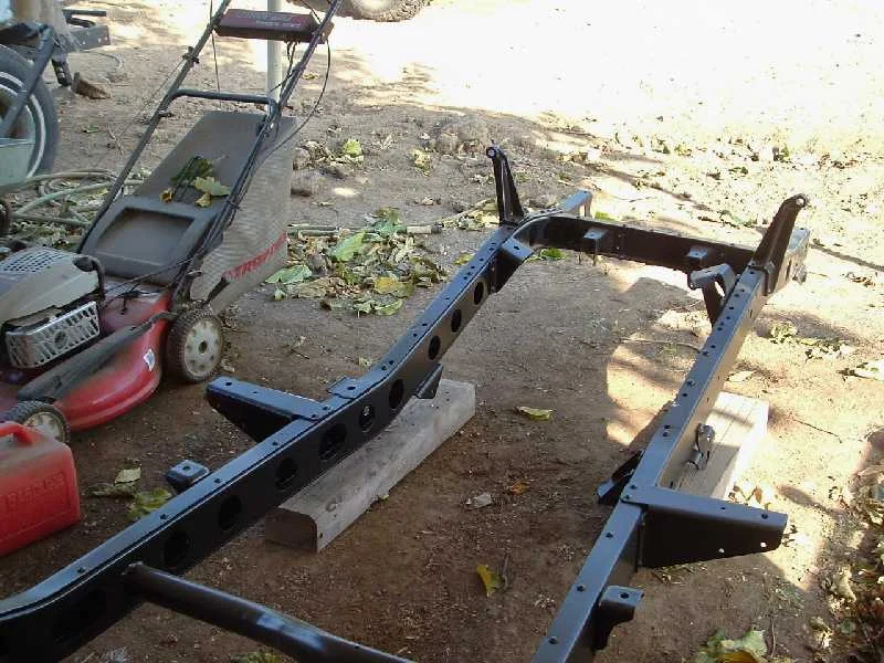

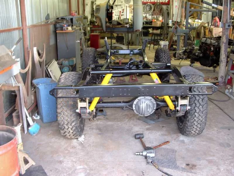

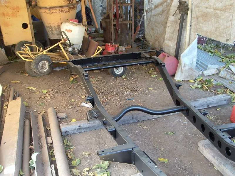

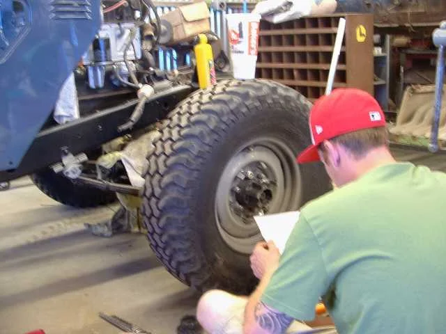

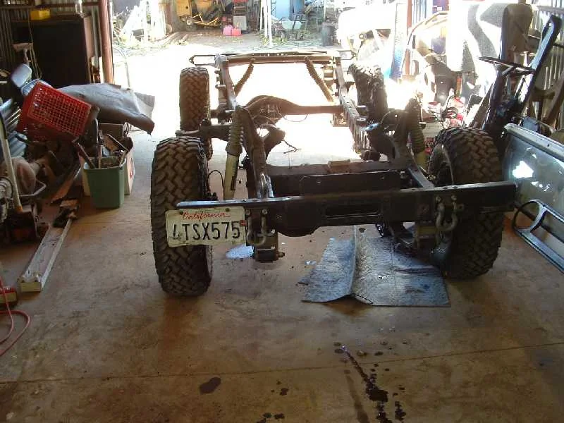

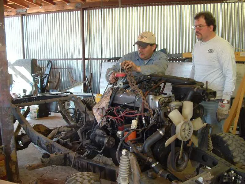

Called my friend Brendon and told him I was ready to take the cruiser down to the frame. Without hesitation he said "bring it on over". Within three days we had it pretty much apart.

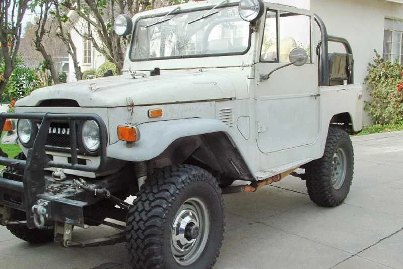

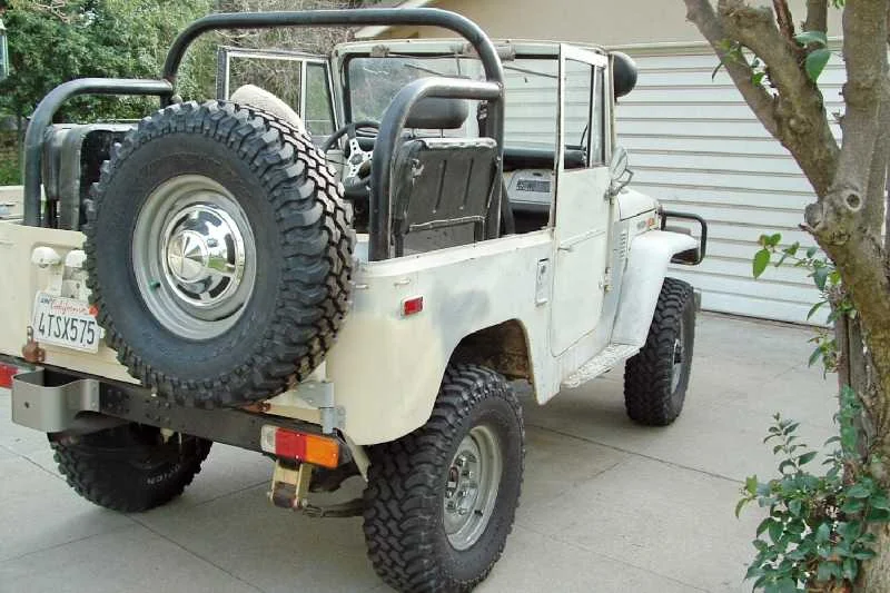

Here's what we started with...

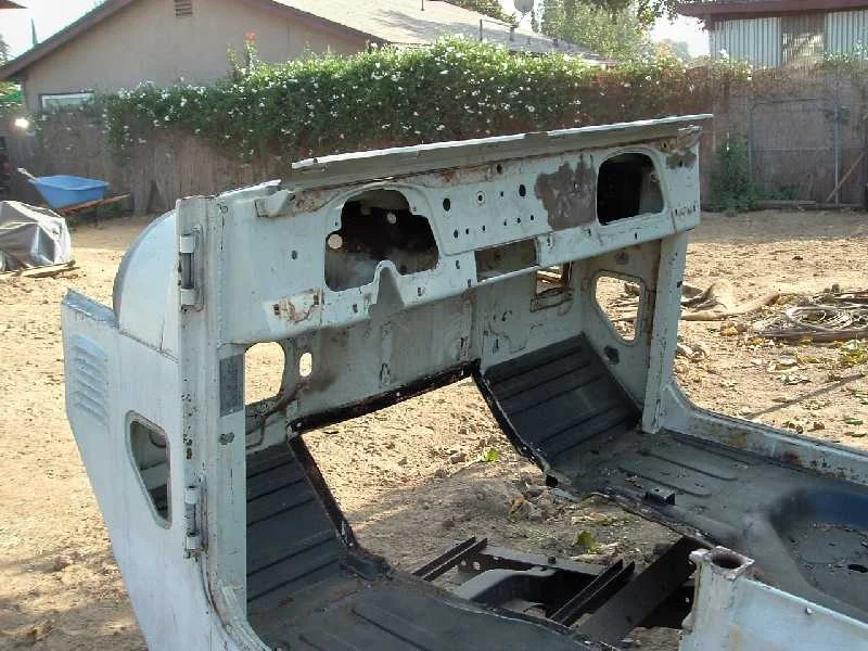

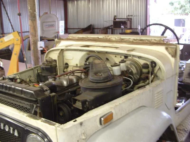

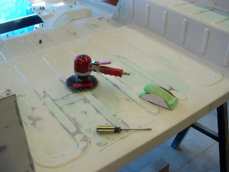

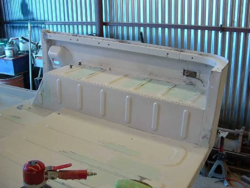

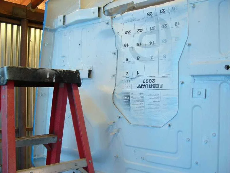

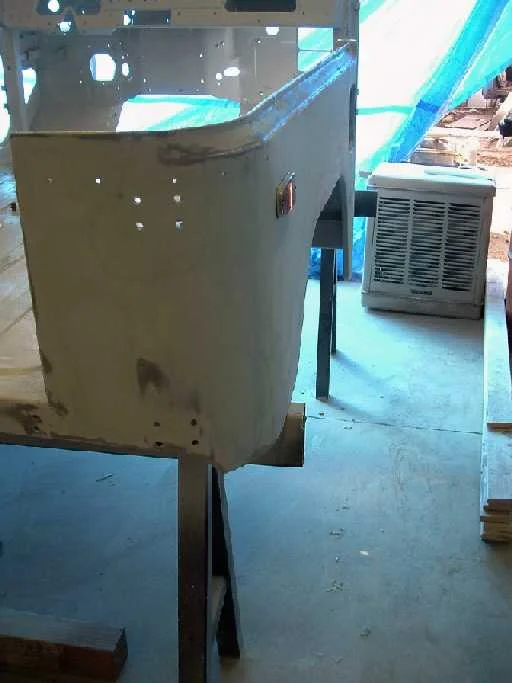

Some of the rust removal.

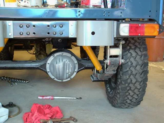

Most of the rust was removed prior to the frame off--mainly the rear sill.

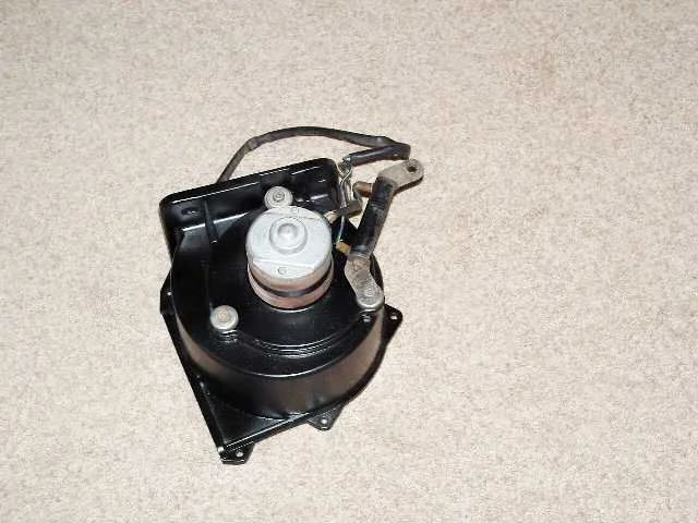

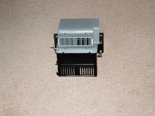

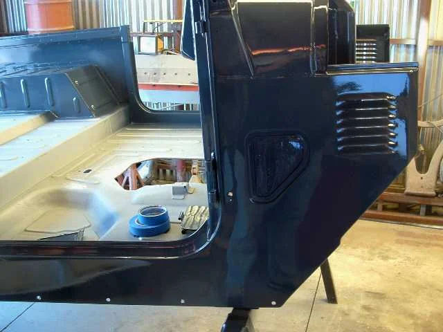

The heater was taken apart, cleaned, powder coated and put back together with Shane's rebuild kit. The blower was taken apart and cleaned as well then rattle canned.

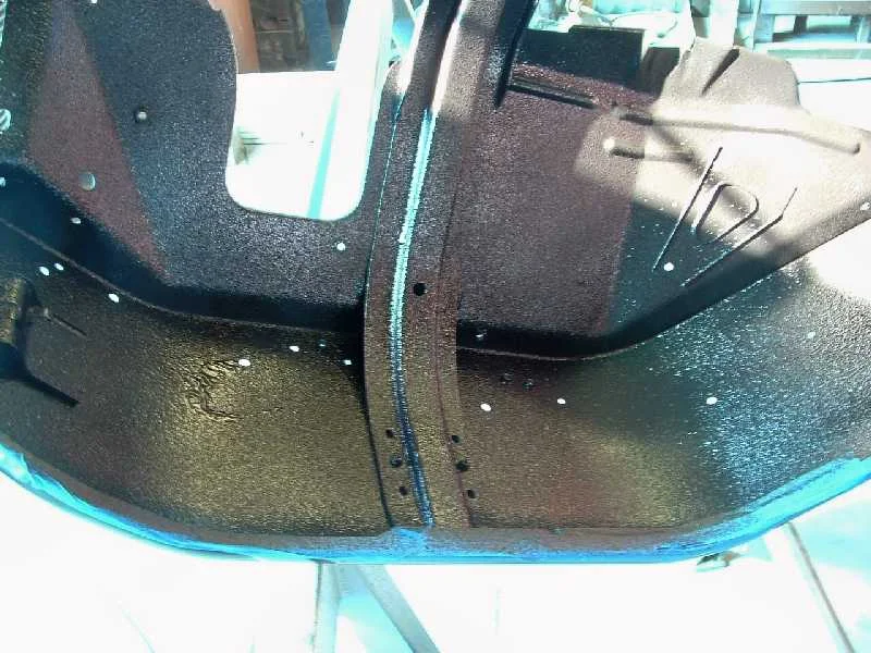

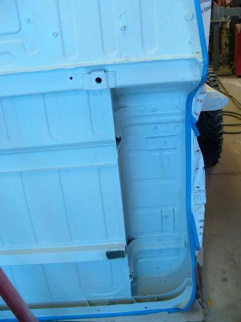

Seam sealer, thick and sloppy! Keep that rust at bay! HA!

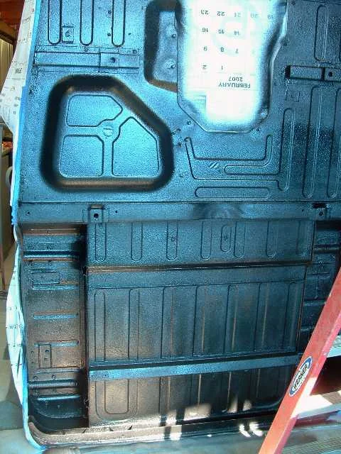

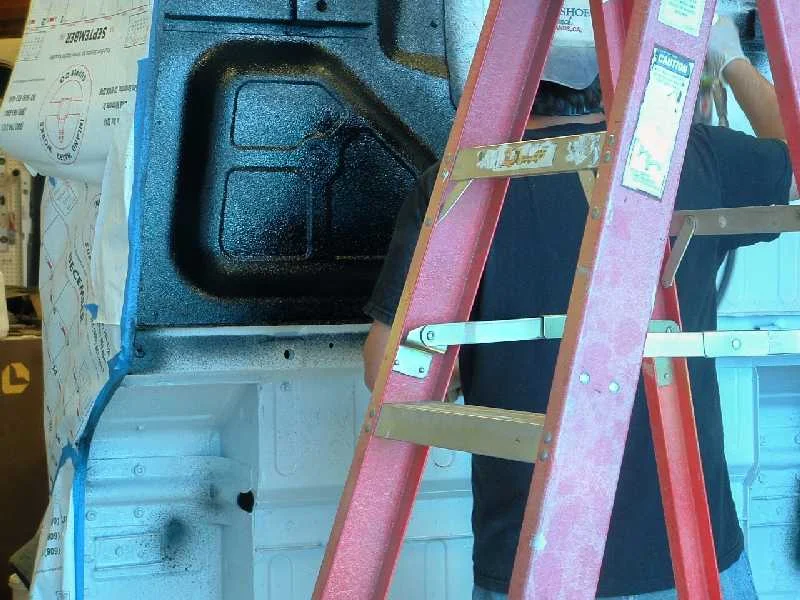

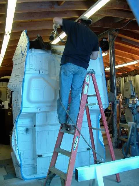

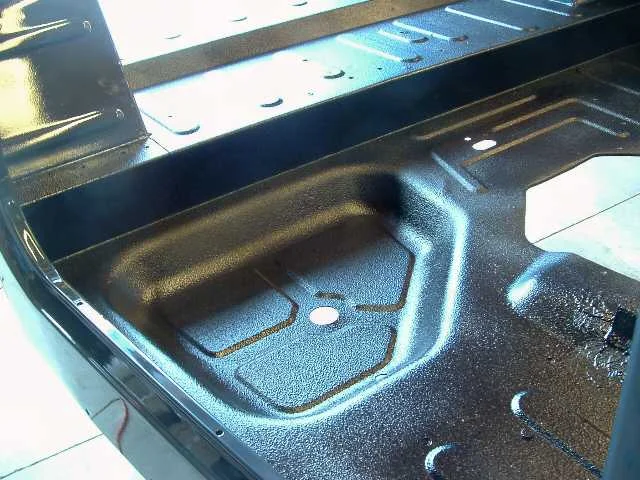

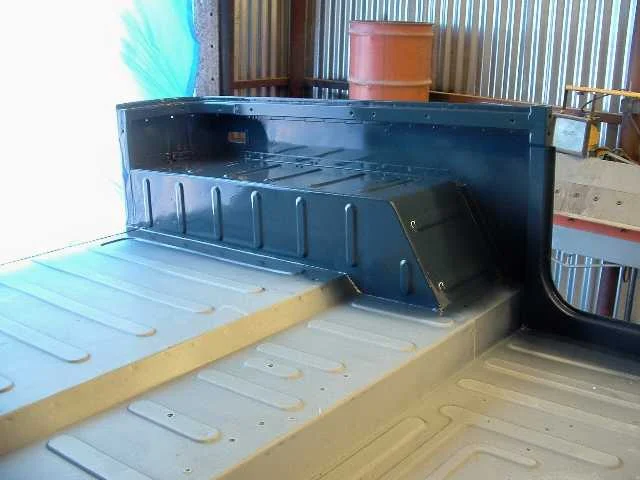

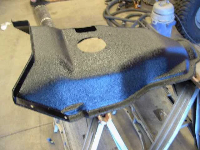

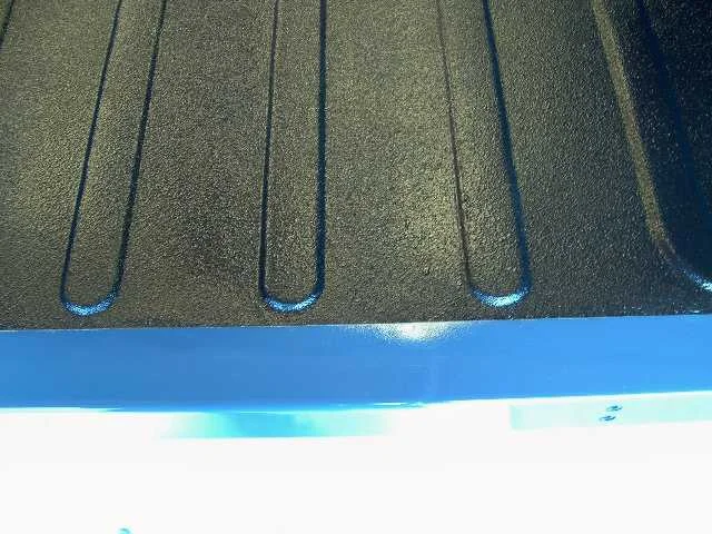

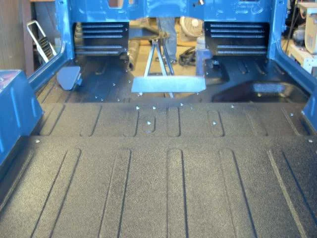

Now for the bedliner to cover all the sins. Bought this stuff off E-Bay called U-Pol Raptor. Pretty cheap and it covers 125 sq. ft. with a gallon. About $100 including the gun. It's not very thick, but it has a good texture ( bumpy but not rough- does that make sense?).

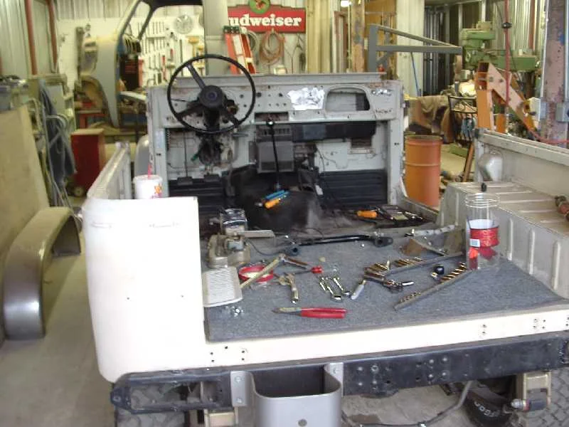

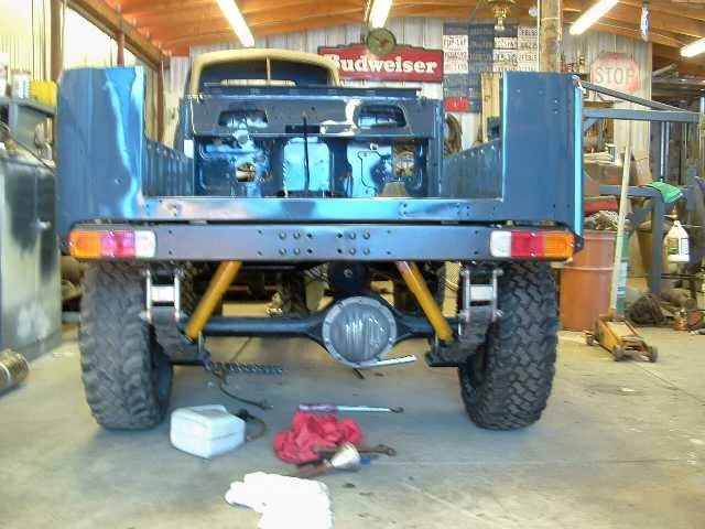

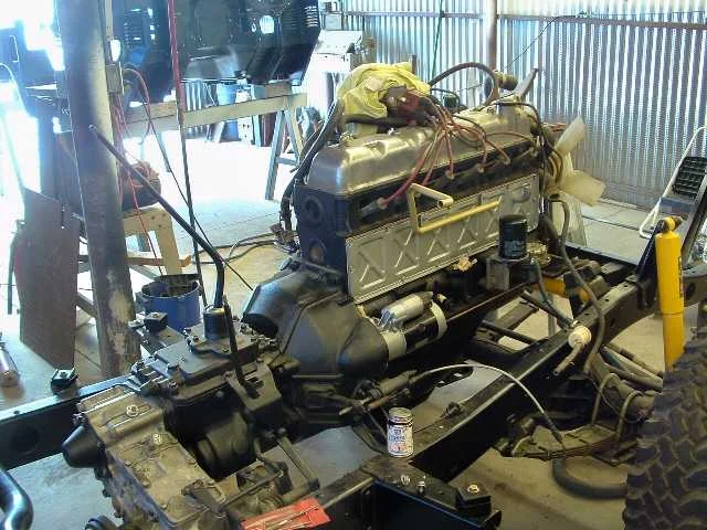

cruiser update
It's been awhile, my silverstar expired among other things, but here's an update.

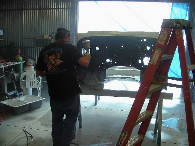

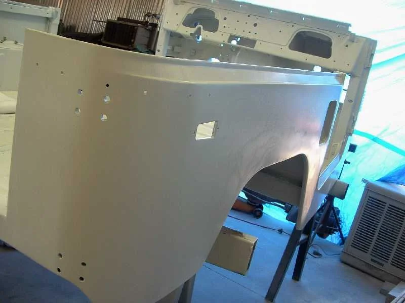

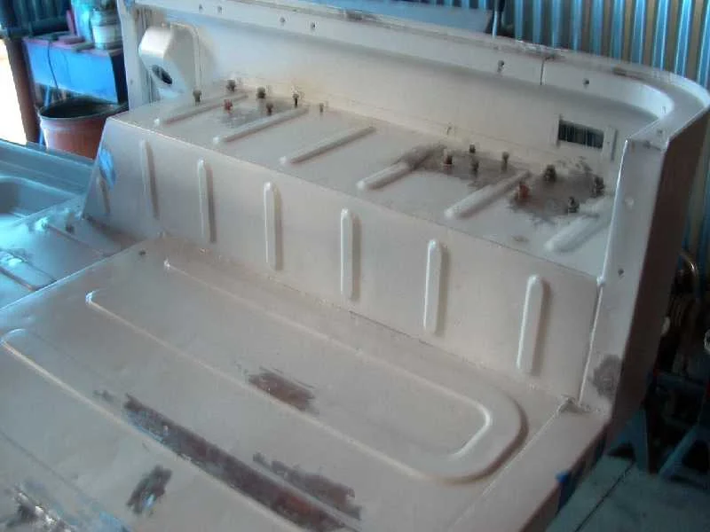

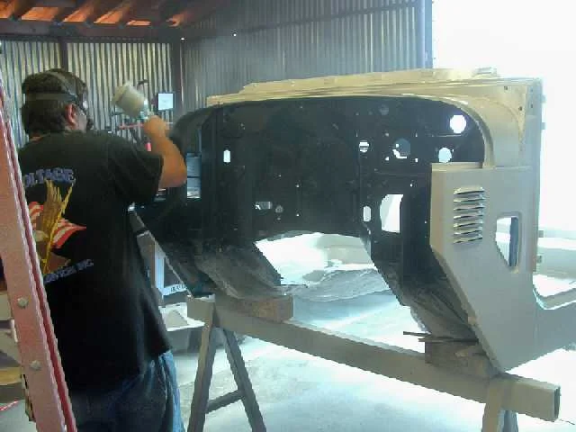

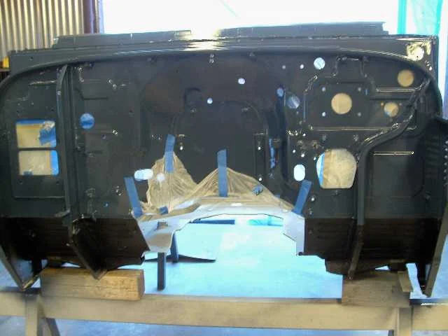

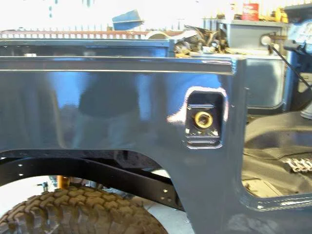

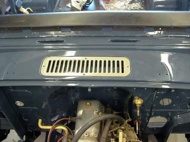

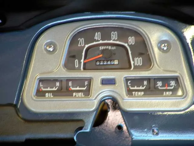

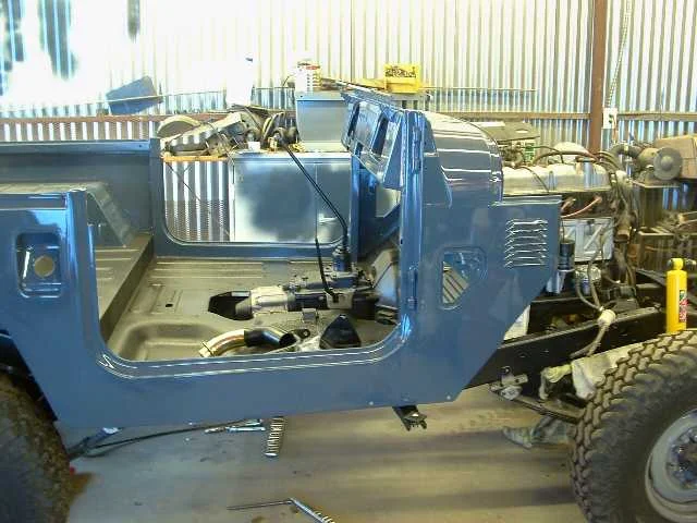

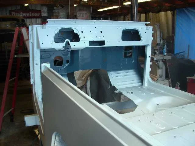

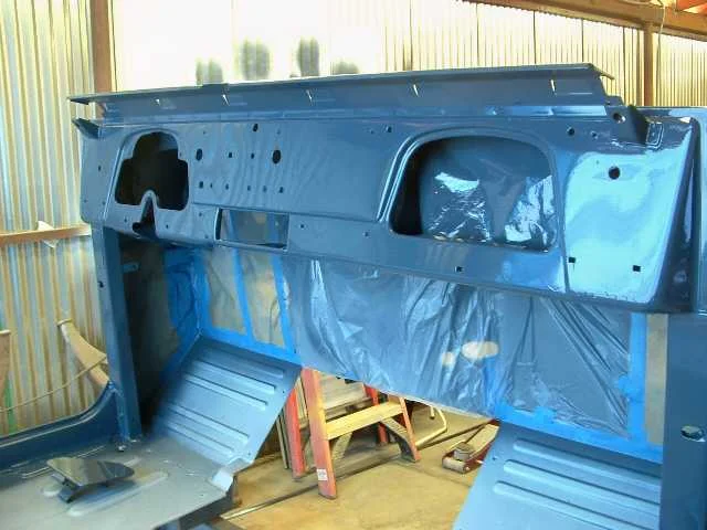

June 2, started painting the firewall and the dash.
