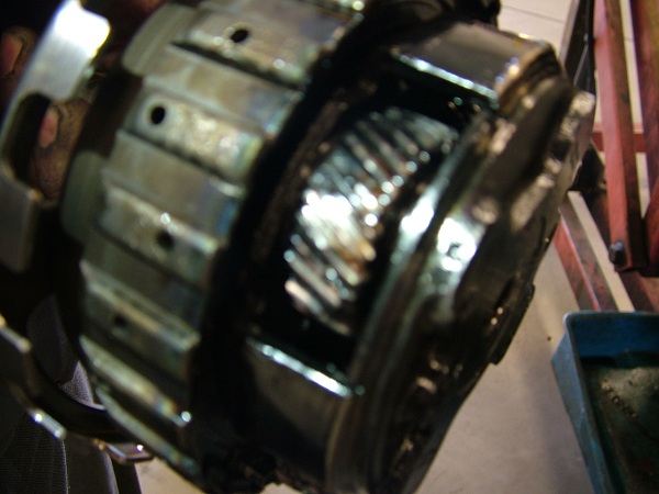

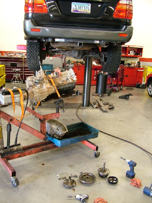

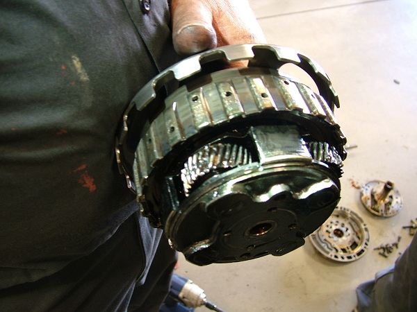

It's official, the transmission is gone...
To be very specific, the planetary gears self destructed in a most explosive fashion spreading shrapnel throughout the entire tranny. I just got the call today from Camelback Toyota (located in Phoenix AZ - mystican). The technician first attempted to troubleshoot the issue without removing the transmission. Once all potential electrical issued were ruled out the tech dropped the tranny pan (something I did not have time or means to do yet) and found a shocking amount of metal. At this point it was decided that the transmission had to come out. Upon disassembling the transmission, initially assuming the forward pump had disintegrated only to find the pump in perfect working order, it became obvious as to the transmissions demise.
The failure is ultimately due to overheating. So much heat in fact that the planetary gears were blue and purple. Due to the fact that the fluid that was in the transmission was not burnt and looked really good, we can theorize that the destructive heat that burned out the tranny occurred before I owed the 100. As many of you may recall, I physically checked the temperature of the transmission with my hand upon failure and discovered at that time that it was not any hotter than it should have been, temperate enough to allow me to place my hand on the transmission case. My guess is the previous owner ran the tranny low on fluid and overheated it, swapped the fluid and went on with life. It just took this long for the heat damage done to the gears to cause a failure. The center planetary gear was completely stripped to the point it was nearly smooth, thus not allowing transfer of power beyond that point in the transmission.
Everyone can rest assure that their tranny is safe as this failure is strictly due to abuse and poor maintenance.
A few photos provided by Eric @ Camelback:
All that being said, a re-man tranny is on its way and will be installed this week. I am still pretty damn pissed off about the whole situation, but that is just related to bad luck and not anything having to do with Cruisers in general. I did think about getting the cruiser back and installing the re-man tranny myself, but for the smallish $500 labor charge for R&R of the tranny, it is just worth having Toyota do it. Since there does not seem to be any other drivetrain damage, the Cruiser is gonna be sticking around for a while longer, I thoroughly enjoy 100's!
I am still extremely confused about the manner in which it failed after seeing the carnage, with zero noise... :confused:
