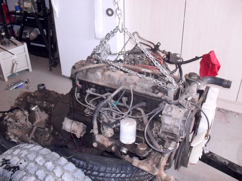

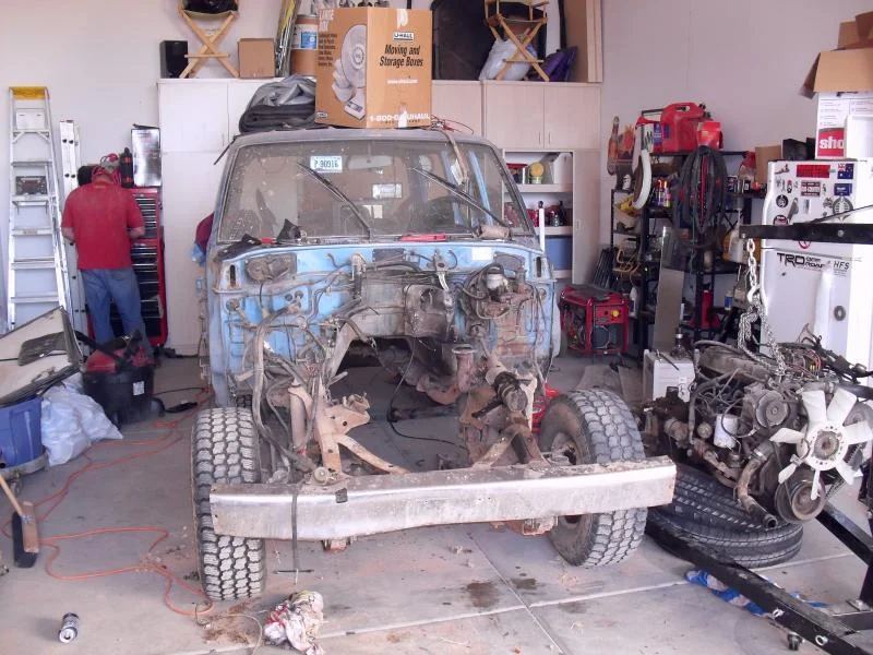

So yesterday in the span of a few hours, we got the 2f fired up and then pulled. The adventure had begun.
I'm sure that both Joe and I will be on here to pick the brains of those of you who know. As of now, our plans are to use the the engine, tranny, and tcase from the '83 and get it into the '79. I'll ask more specific questions as they come up, but feel free to throw out any advice you may have. We are unsure of whether or not to use the front and rear from the 60 or keep the 55's. That and we don't seem to have engine mounts on the bell housing from the 60. Those are our biggest questions for now.

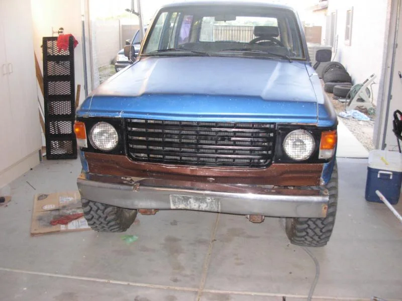

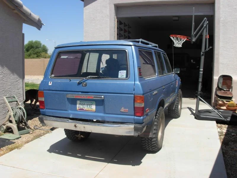

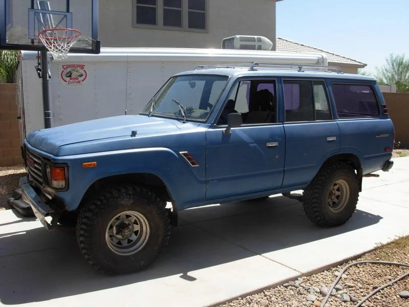

And no build up thread is complete without pics, so here's what the 60 started out as before I started taking it apart. Enjoy.

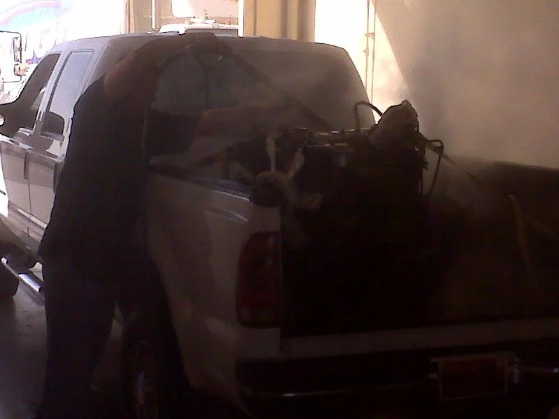

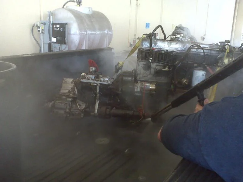

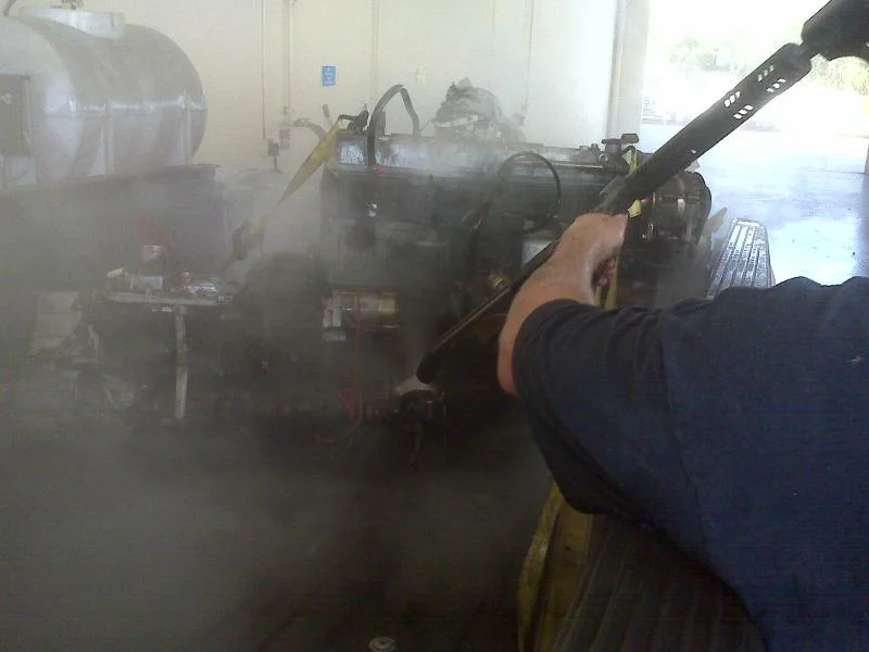

but it's something. In the few hours we were able to donate to the project this weekend, we loaded up the 2F, tranny and transfer into the bed of Joe's pick and took it to the car wash. Joe wasn't satified with the amount of gunk that remained after about $8.00 worth of the the pressure washer, so we decided to see if the guys at work would let us borrow a the bay with the steam pressure washer. Sure enough, they did and it worked great. It ended up being a lot prettier than I thought it would.
Still a lot left to tackle, and we really need to get the ball rolling while the weather's nice.

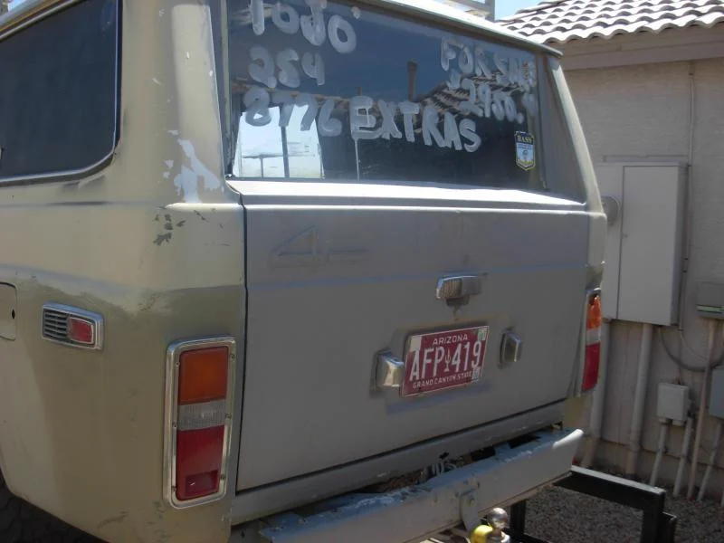

Oh, and your 55 is looking good. I found changed out my taillights to Trailer LED lights the ones that I put in aren't a great fit, but I found some just after I did it that fit perfectly.
