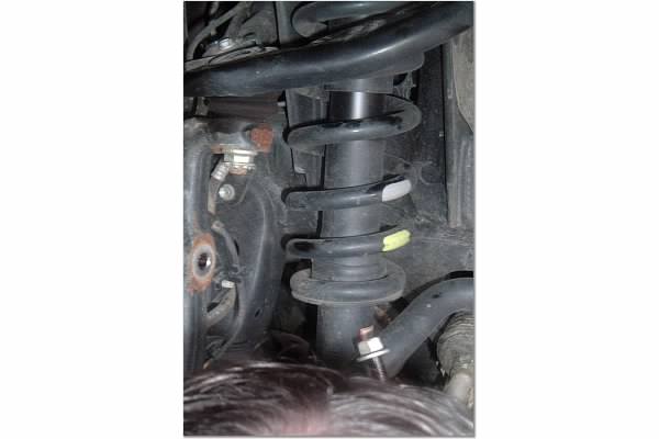

after alot of agrravation.. and cursing at skyjacker... and just deciding to do what looked like the best option.. skyjacker strut installed
47b6d601b3127cce98548817ca3b00000007100IZMWzVsyZMS
spring hitting UCA (at full droop) because were not 100% sure we got it all right, but its the only way it would have worked

Una,
Are you re-using the stock front coils? Is the uca hitting with the swaybar & tre's connected? You should be a-ok once everything is hooked up.

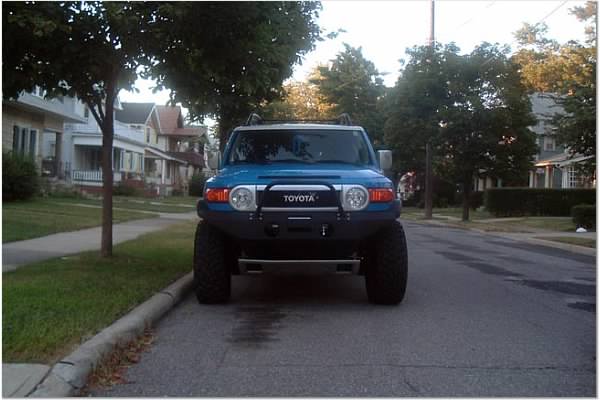

FJC is looking good, that stock skid plate has to go! :grinpimp: but it is great to show how much more clearance you get with the All-Pro bumper!
it rides great, and its WAY better than a spacer kit IMO. and its priced pretty competitively with spacer kits.

you re-use the stock front coils, put them on the skyjacker strut, which is taller and the mounting plate is higher on the shock body.

Is the front shock valving a bit firmer than stock? Any sway issues when driving?
Point of concern is the droop with the UCA hitting the coil. How long is the strut assembly compared to stock?
It is difficult to tell from the pics, but it looks like they used a strut to do what most spacer lifts do. Add some preload to the coil and also some lenght to the total assembly. Definitely cleaner than most spacer kits though.

The total shock body length is probably about 1.5" longer than stock. The valving is SLIGHTLY firmer.. not much of a difference though honestly from what I could feel.
It drove pretty good considering my alignment is shot to hell LOL
