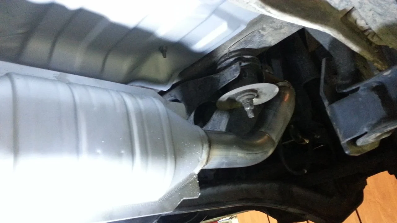

Then the cat had to be rotated 90 degrees and tucked in close to the frame rail...

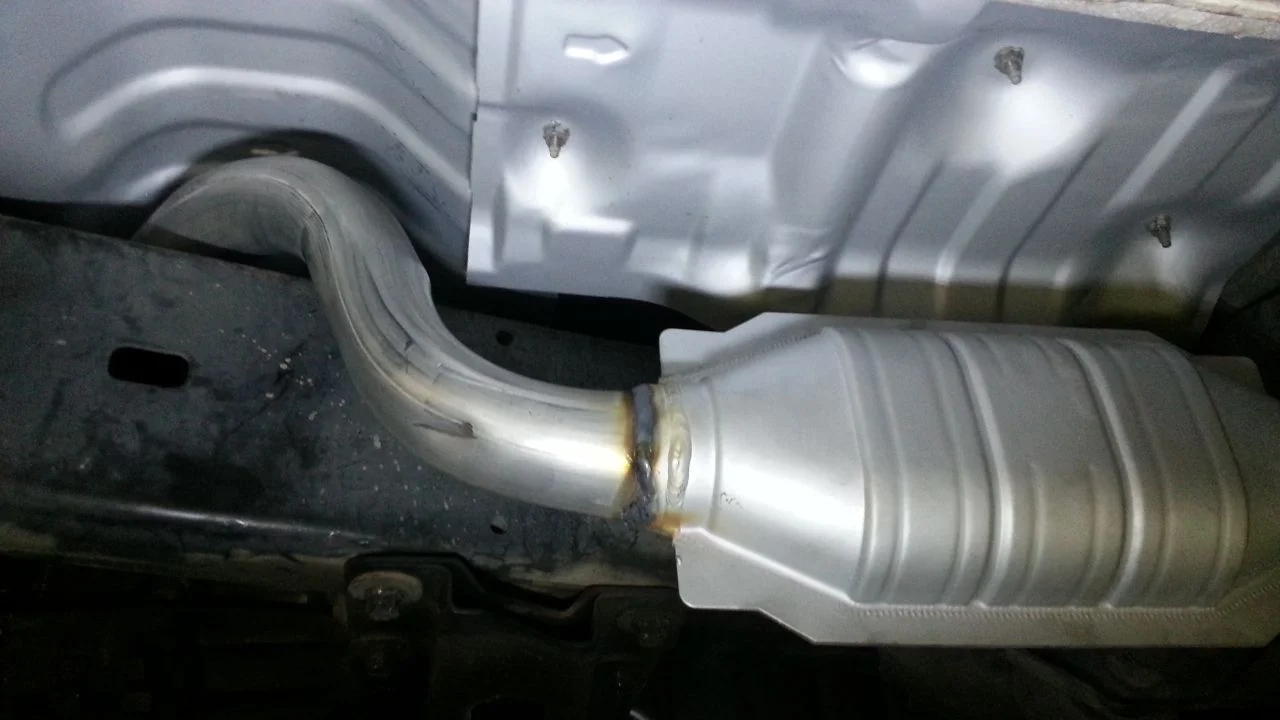

...and a new section made to run from the cat over the frame rail to mate with the new Bosal KIT6486416 muffler/exhaust kit for the '93 Land Cruiser. The factory outside frame rail exhaust hanger/bracket assembly was deleted and a new hanger installed inside the frame.
Now that this is done, there is about 6.75" between the cat and the inside of the body rocker. The non powered bracket should just fit.
