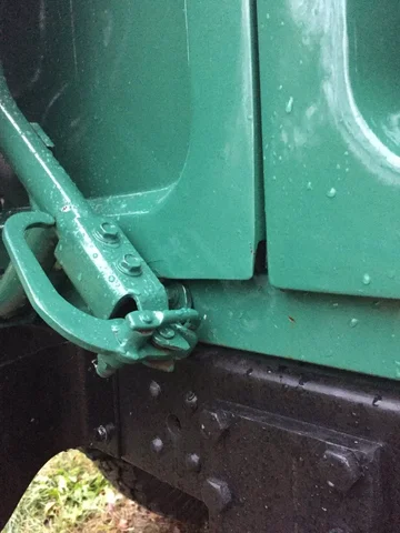

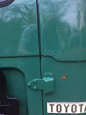

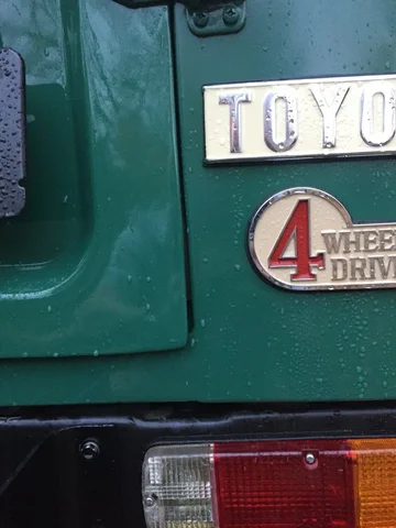

Can anyone tell me what's going on with these doors? I picked up this 40 up over the weekend and can't figure out whats going on. Needless to say the bottom of the doors don't latch. The top looks fine, has a 1/4 gap between door and roof.
Any help would be appreciated.

If the striker is there, then know that you can loosen all the JIS screws on the top and tub sides of the hinges, and there are sliding captured-nut plates behind them that slide up and down an inch or so that will give you room to move the doors up if needed.
The striker is there, the left door doesn't come close to latching at bottom. Its about 1/2" away... I will take a picture tomorrow. The top gap looks pretty good but I will try and move the doors up tomorrow anyway, Thanks guys.

i'm guessing the tub was redone. the one pic that shows the had top to door gap, shows the gap growing as it moves up.
Sorry, a little background on the truck might be helpful...1978 all original with the exception of the body work..
The guy I bought it off said the metal behind the seats on back was all new. The paint job is terrible but the frame was sound so I took a chance.
The good news is that it is easier to make the doors shorter than it would be to stretch them....;)
It is odd that the doors are not the same length??? Looking at your pics, my thought was that they replaced the rear quarters and let the top rails sag a little creating a smaller door opening. I don't see how you could push the door up enough to clear at the bottom.
Be happy to measure door lengths for you tonight if someone doesn't do it first...
I have one at 40 5/16 and one at 40 1/16....God only knows what they have done? I plan on painting the truck another color next year so might revisit this with the body shop then.
