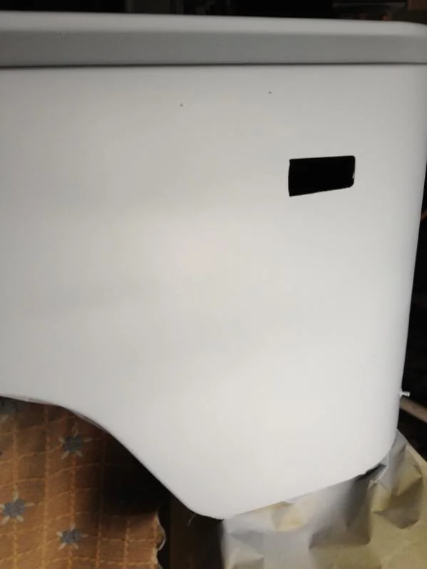

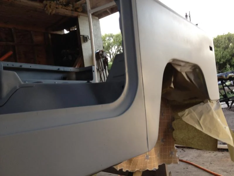

Im not sure if my paint/air mix is off or if it is merely my technique. Or is this normal for a high build ppg mp282 which has afive minute recoat time?
It was a bit breezy.
This was after one coat of epoxy mp170 and 3 coats of mp282. I assume this will be fine after block sanding?
Is that PPG's waterbourne primer system? If so, I believe you are supposed to have a constant direct air flow when spraying. That's why I would never spray a waterbourne paint system (as long as uerthane still exists that is) in anything but a real-deal paint booth.
Does the areas in question have a rough texture feel to it? If so, it's what you call "smoke" in the primer which is usually caused by having the air pressure up too high. The primer basically bounces off the panel and then settles back down causing that rough texture. It's really common to get on hoods/tailgate or panels you lay flat on something. Also alot more common when using siphon fed guns since the material goes airbourne alot more because of the extra air pressure needed to push the primer out. You can normally block it out, but you will definitely have to re-prime which I'm 99% sure you were going to do anyway. If it's not the case (hard to tell by the pics), you may just have to adjust your spray pattern knob or you are overlapping too much.
All in all though if you are going to block sand the primer do not worry. I'm assuming you are going to use a sealer before paint after you block it? If you performed alot of bodywork on the outside panels I would put a guide coat on before you start blocking. Just go to Home Depot and buy the cheapest can of black paint or primer spraybomb and dust it all over the exterior of the tub. This will let you see the highs and lows as well as the sand scratches during blocking. It's a VERY good tool to get your panels looking good before paint. You have to keep in mind when doing autobody work that if you don't do the proper prep work the best paint in the world will still look like sh!t!!

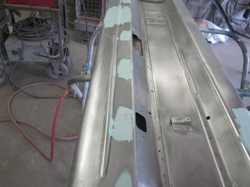

Her's a pic of an early bronco tailgate I did a TON of body work on and put the guide coat on after the first coat of high build primer.

Thank you for the detailed post.
It is not waterborne.
My pressure was 32psi (I could not push anymore than this)
I was planning on doing a guide coat this weekend and block sanding.
I am going to do a sealer coat with reduced epoxy mp170 per everything I have read and everything the paint shop suggested. Do you have a percentage recommendation for reducer?
I have not felt it, and in hindsight it doesn't look bad. I am glad it seems ok after sanding to you guys as I am extremely happy with the build of this primer and smooth it looks.
