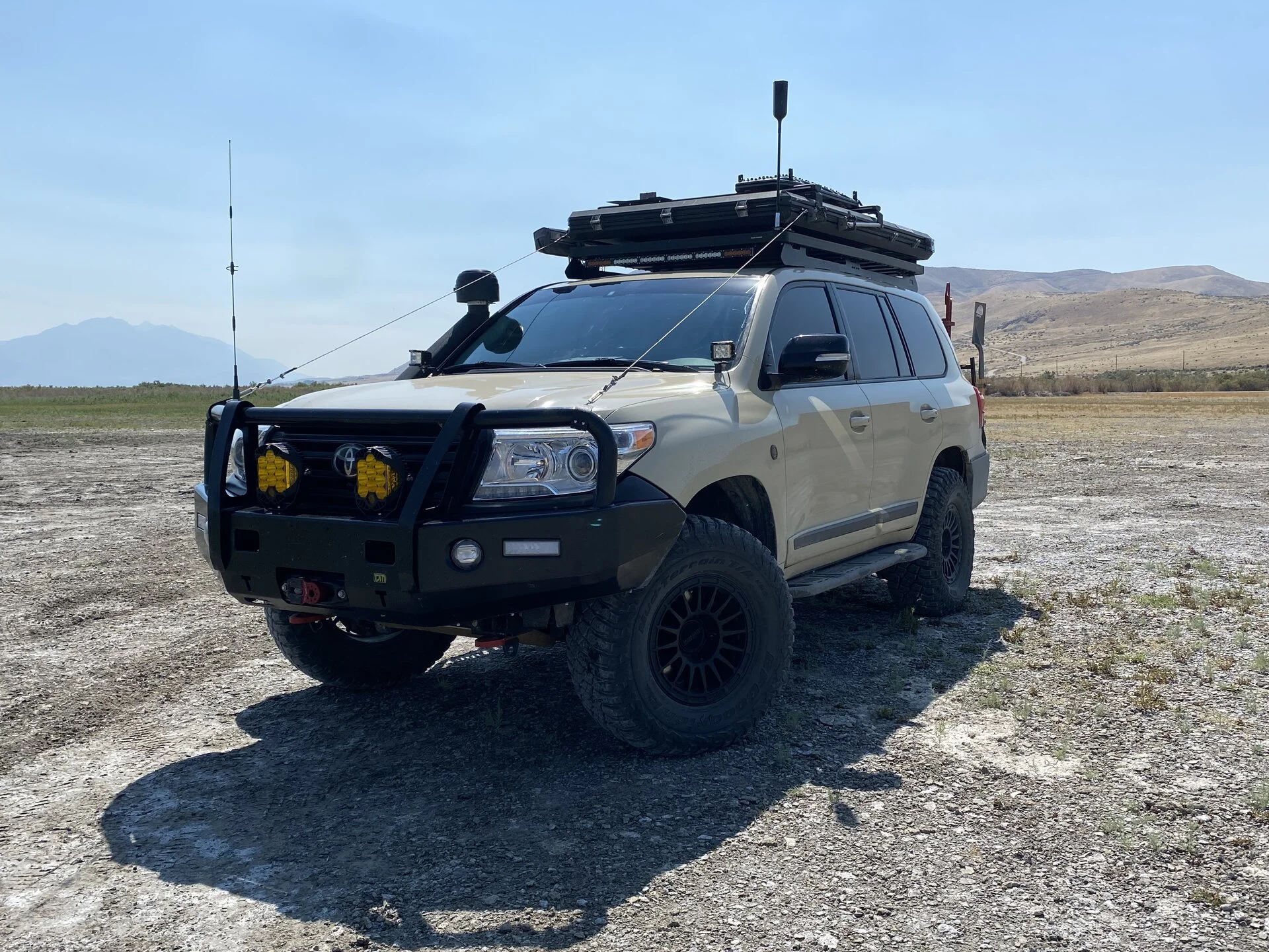

I do a lot of off-roading and overlanding, often in the high temps of the desert SW. My 200 is heavy with lots of aftermarket add ons, bumpers, skids, sliders, rack, etc. My OEM radiator is at the end of its life. I’m looking for a quality aluminum radiator that can provide better cooling. Anyone know of a good current manufacturer?

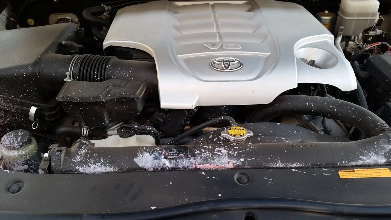

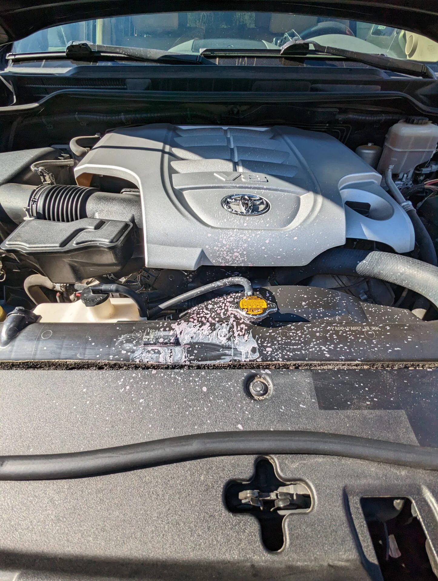

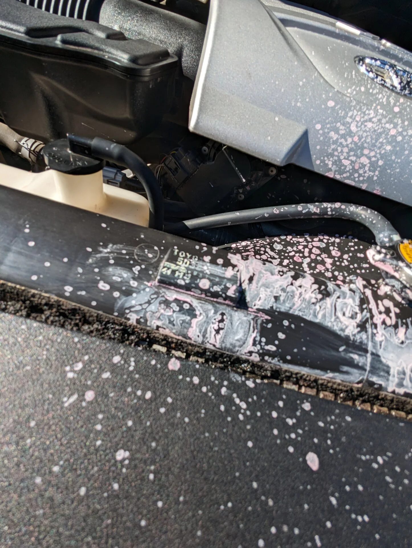

My radiator cracked at the head at 85K! Not sure if this was a result of any other fault. Car seemed to be working fine since my few weeks of ownership. I had not noticed any overheating and it still isn't overheating but definitely interested in getting the best radiator I can since I am going to be adding bigger tires and extra weight.

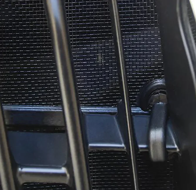

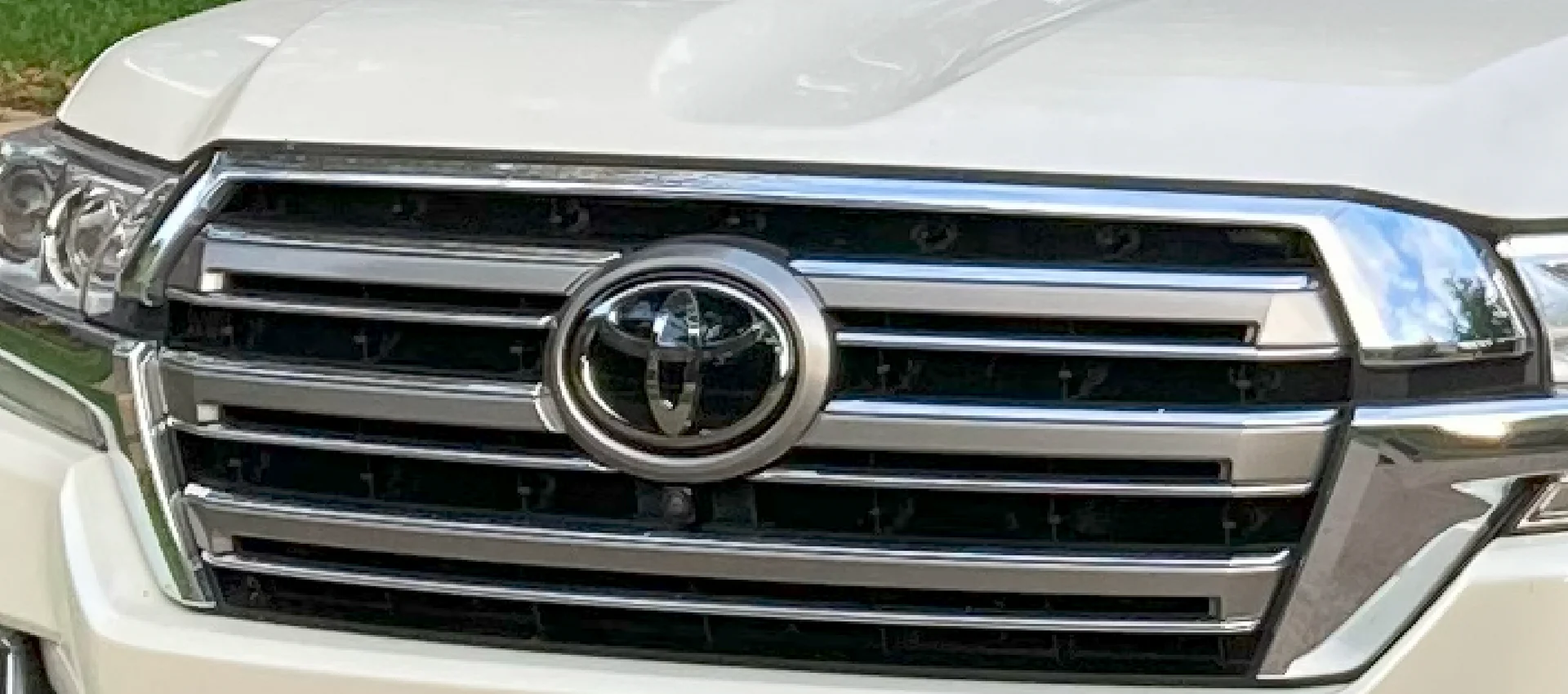

Related to cooling, perhaps consistent cooling with time, I have opted to install this mesh behind the grill shortly after I purchased my LC at 5 miles to prevent bugs (there are lots of them) and any stones (unlikely, but possible) from hitting the radiator, oil cooler and AC condensor. Everything important still looks brand new 2-1/2 years later.
Very happy with it and cleaning, including removing bugs has become really easy.
Incredibly common. The updated Genuine Toyota part solves the issue.
Thanks for the link. Yeah I guess it is common. So is there a need for additional cooling capacity for heavier rigs in general?
Have pics?

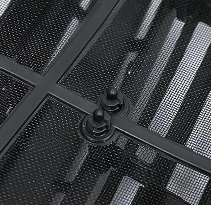

Have pics?
Low resolution pic (zoom in of existing photo) of the insect screen mesh which I bought on aliexpress.
Had to trim it to fit around the logo/radar setup. With a bit of search there maybe one which already has a cut out for it.
Even though low cost, made of plastic (mesh insert is actually stainless steel) and basic mounting setup, it has stayed in place with zero issues for the last 2-1/2 years.
At purchase back in Dec 2020 I was thinking if it works, great, then it keeps everything clean and neat and if it does not, say it goes lose, it will just sit in front of the radiator without the risk of touching any moving parts. Been perfectly fine though including driving in heavy rain and wind conditions. One of the best low cost upgrades I have applied.
In firefighting we sometimes use a tactic called positive pressure attack, where we'll point a very powerful fan into the front door and break the window of the fire room, at which point the fan creates a flow path taking much of the smoke and heat out of the rest of the house. It's pretty dramatic how quickly the conditions can improve inside while the fire is still burning, making the rest of the structure more survivable for victims, much easier for us to operate to find victims and find & put out the fire. It is ultimately making a very very low, but still increased, pressure situation at the front door to force the air/smoke out the lower pressure environment outside that window.
Having a screen on the fire room window cuts that flow path down dramatically. Like 75% reduction or more. Granted, this is a very low pressure scenario, but I'm not sure how much pressure is created at the grille either. Or how much that restricts flow compared to the already restrictive condenser/radiator/etc.
Our cooling systems are very robust.. I don't think having that mesh grille guard would cause any real temperature concerns, but my gut is telling me it will have an impact and the fan is going to have to pick up the slack. Edit: whether this is a significant amount of slack pickup or not probably has to do with other elements of a build.. how much harder is the vehicle having to work to go 75mph from front bumper, rack, tires, etc.
With that low pressure of a fan/system you might be right on the cusp of laminar-ish vs turbulent airflow or something like that. Given the number of aftermarket mesh or sort of enclosed grilles on the market, I wouldn’t sweat it too much. At higher speeds you’re ramming a ton of air into the front of these rolling bricks. At lower speeds, make sure your fan clutch and fan blades are in good condition and I bet it’s totally fine.
I don't think putting a mesh there is a good idea and more than certainly will compromise airflow at speed. It's solving a problem that isn't there IMO. If towing at all, or using it in any high load situation, I would really recommend taking that off. Speaking as someone that works in the aeronautical field.
Again I don't think it'll necessarily overheat the truck, but I do believe it will make the fan work harder than it would otherwise.
Plus yes the airflow is much greater, but so is the required horsepower which moves far more heat through the cooling system than low-speed driving.
The 80-series put a ton of strain on the fan clutch just from having lights on the bumper spaced multiple inches out from the grille. There would still be a ton of air ramming into the grille at freeway speeds even with the lights.
