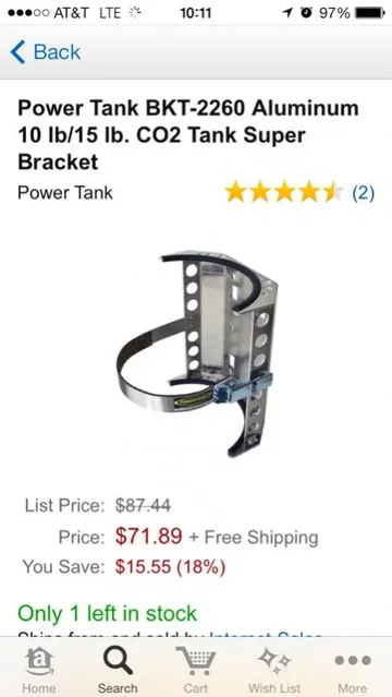

I haven't built one, but I think the PowerTank brackets might fit them.
^ I had a Powertank and bracket like the one you linked...without measuring I'd be surprised if the diameter matched...

The one from Power tank does have adjustment in it...Another 1-1/2"?...not sure...I'll take a picture to show the difference in length
