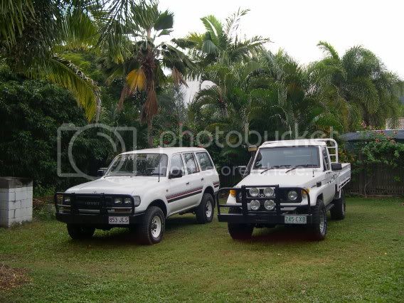

Compare the bought bar on my 80 with the workshop made bar on my HJ75 LOL tin and steel..:beer: :beer:
