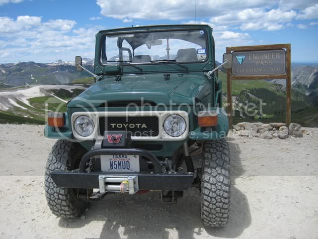

My 1980 came stock with a High Altitude Compensation system that adds another 6 degrees of additional advance to the ignition timing and bleeds more air into the carb circuits above 4,000 feet elevation. I've had it up to 13,000' without any problems, but like @Tancruiser said, you're going to lose oxygen and power no matter what. It can be slow going up a steep highway pass in 2nd or 3rd gear.
If you're going to be driving at elevation for more than a day, just advance your distributor another 6 degrees. If you don't have a dial-back timing light, then wait until you get up at elevation and advance the distributor by hand until it runs good but doesn't ping under load. Make a mark where it was, and set it back to that when you come down from elevation.
