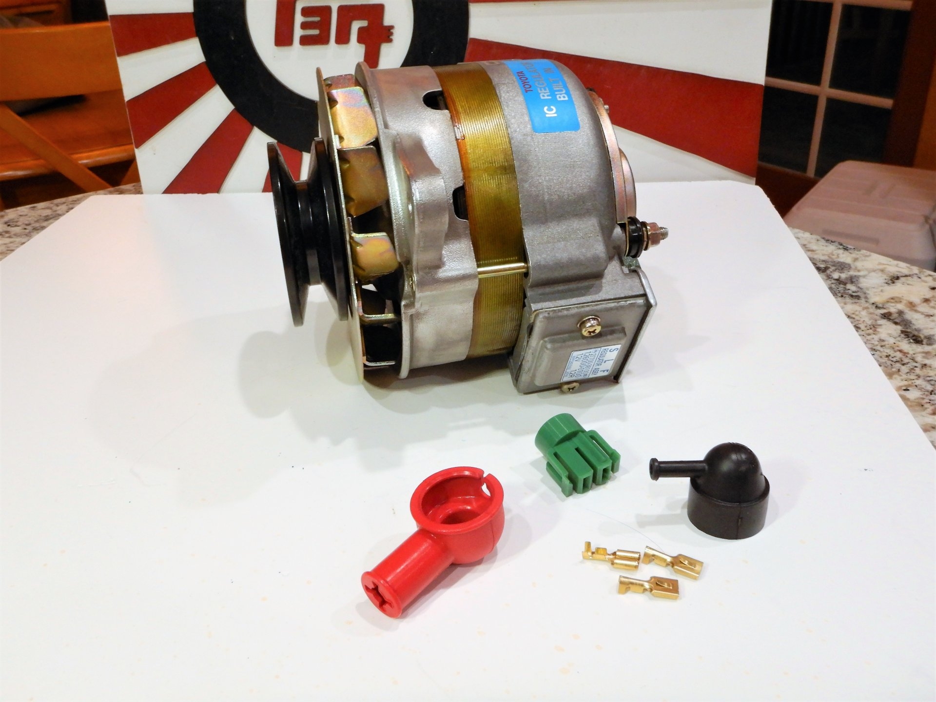

this is a NEW FJ60 2F unit
55A amps
these are extreely relaible units too including the regulators
55A amps

I have a FJ62 80A unit NOS if you still need one ?
27060-61090
