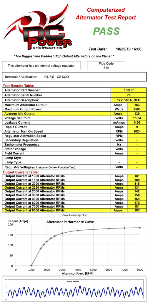

For all practical purposes its a 130A product. Peaks at 180A near redline.

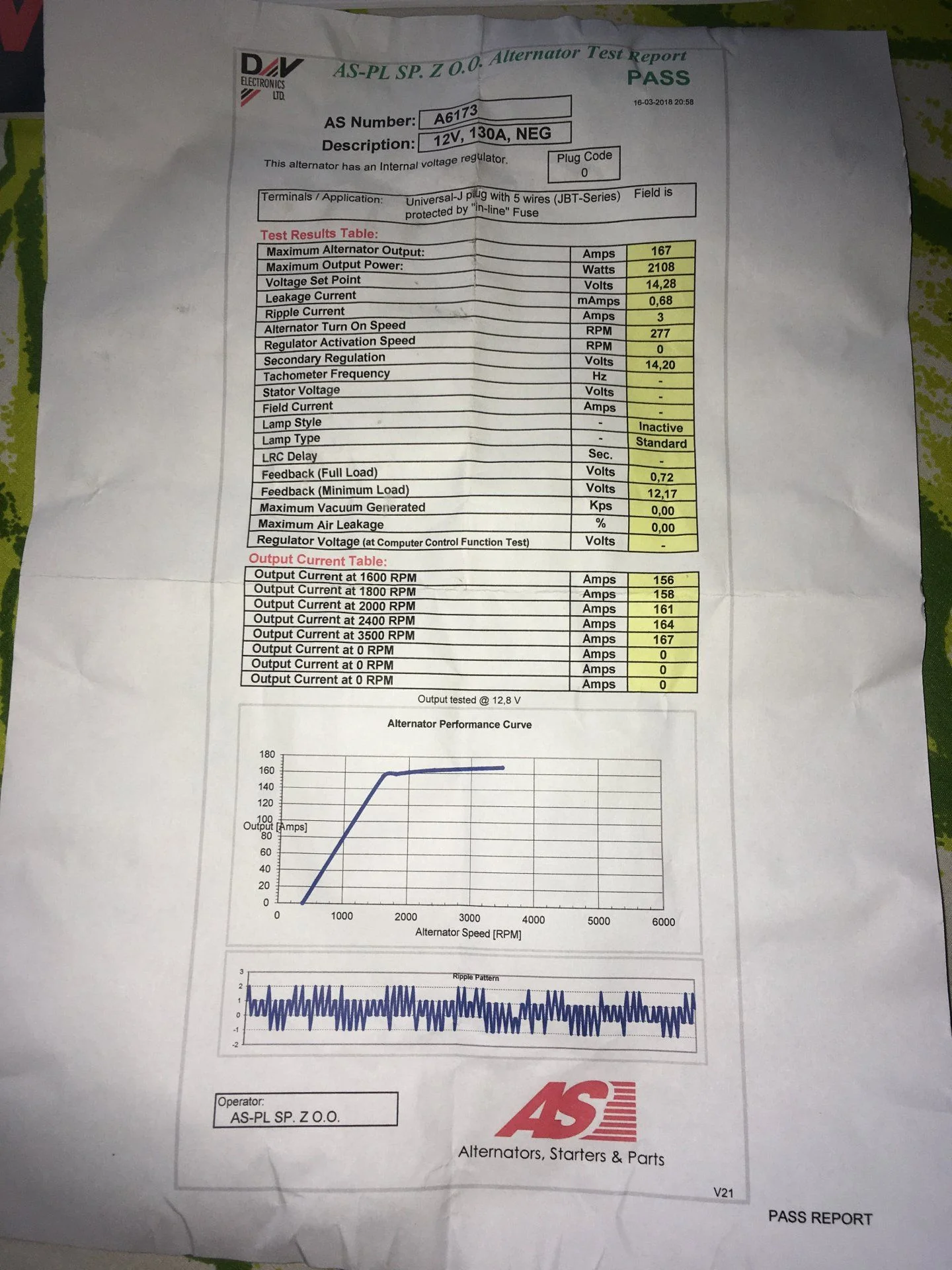

Looks quite similar like my AS A6173:
This particular alternator - after actually reading the details in the test, would never make it to my truck. I'd send it back. 15.24 volts will boil a wet cell battery in no time, and destroy an AGM in months if not weeks.
The 130A alternator with a 14.2 volt output is actually AGM compliant.
