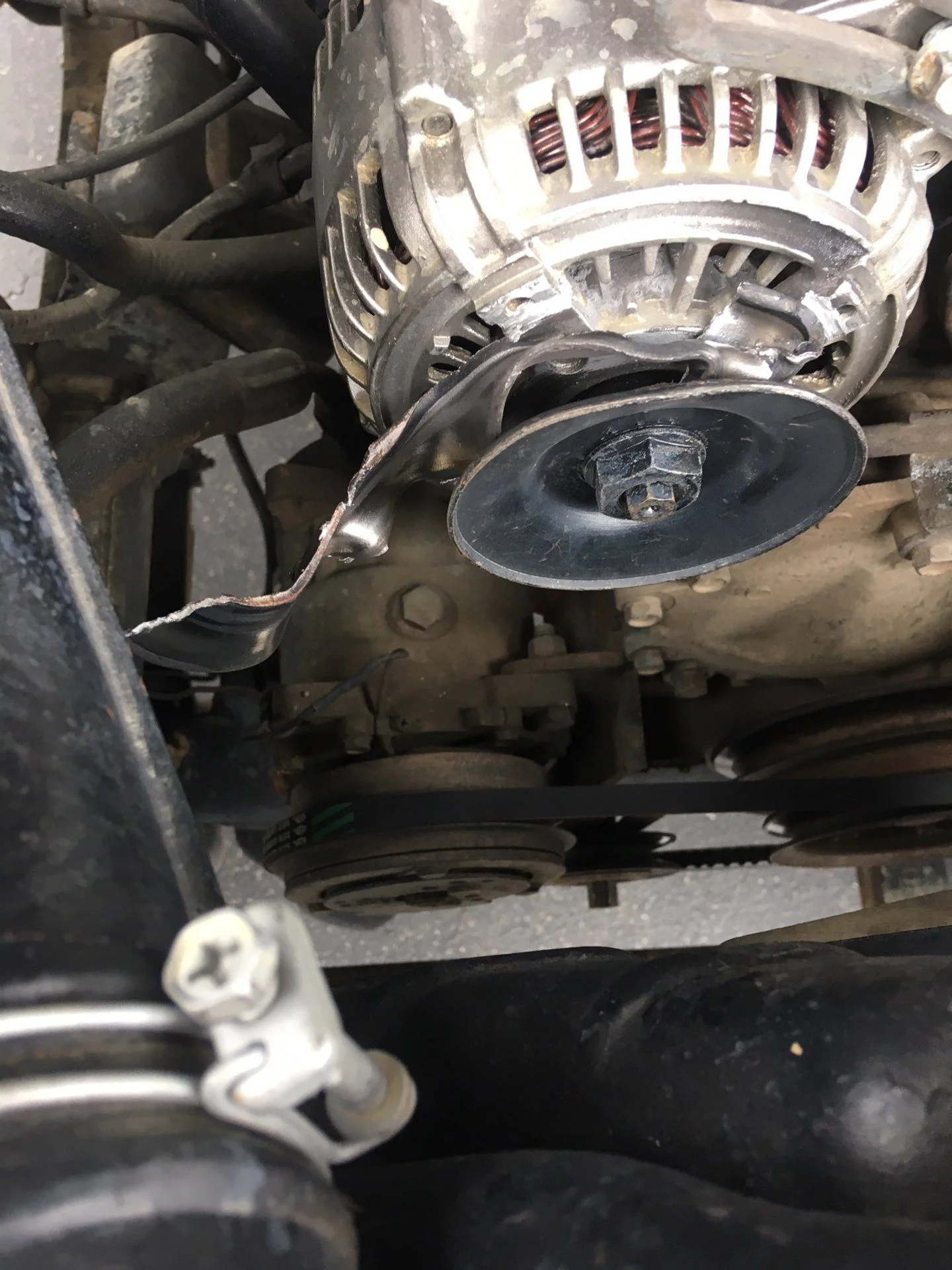

Had a pretty terrifying breakdown yesterday and curious if anyone has experienced this before. Was driving on the highway when what’s displayed in the image occurred. Started with a loud pop and then dash lights coming on. I was able to shut the engine down by disconnecting the battery, because it wouldn’t respond to the key.
Couple questions
What's the probable cause of a pulley ending up like this? The alternator is a denso 100amp that was rebuilt a couple months ago (poor rebuild job, belt tension too tight, wrong pulley size?)
The temperature rose to just below the red before I got it shut down. The engine ran for 3 minutes at most after the incident. Is it possible that any overheating related damage could have occurred during this time? Haven’t restarted since, but there was no obvious signs of overheating like steam or coolant boiling out everywhere.
What’s the best way to shut the engine down in an emergency like this? Much more familiar with the OM616 which has a manual shutoff lever w/"STOP" printed on it and it would not shut off by disconnecting the battery. Is there something like this on an 89 3b2 (no edic)? Pressing the throttle lever backwards did not shut it off and If the terminal had been tighter I don't know how I would have shut it down without pulling off a fuel line - I don't think Toyota would have designed this engine with those as the best options for emergency manual shutdown.
With the picture you posted above..... I can imagine the alternator bearing(s) ceasing up; the power of the crank shaft continuing to drive the belt destroying the alternator pulley which ended up looking like that...
A pair of vise grips pinching down on the rubber fuel line should stop the engine.
Thanks, both good ideas. I’ll keep a set of vice grips in the glove box from now on too, In case I don’t have room to stall. Regarding the bearing seizure, that sounds logical to me. I’ll have to check out the alternator again to see if there is evidence of that. Could I fault this to the rebuilder? Trying to decide if I should fight for a refund.
