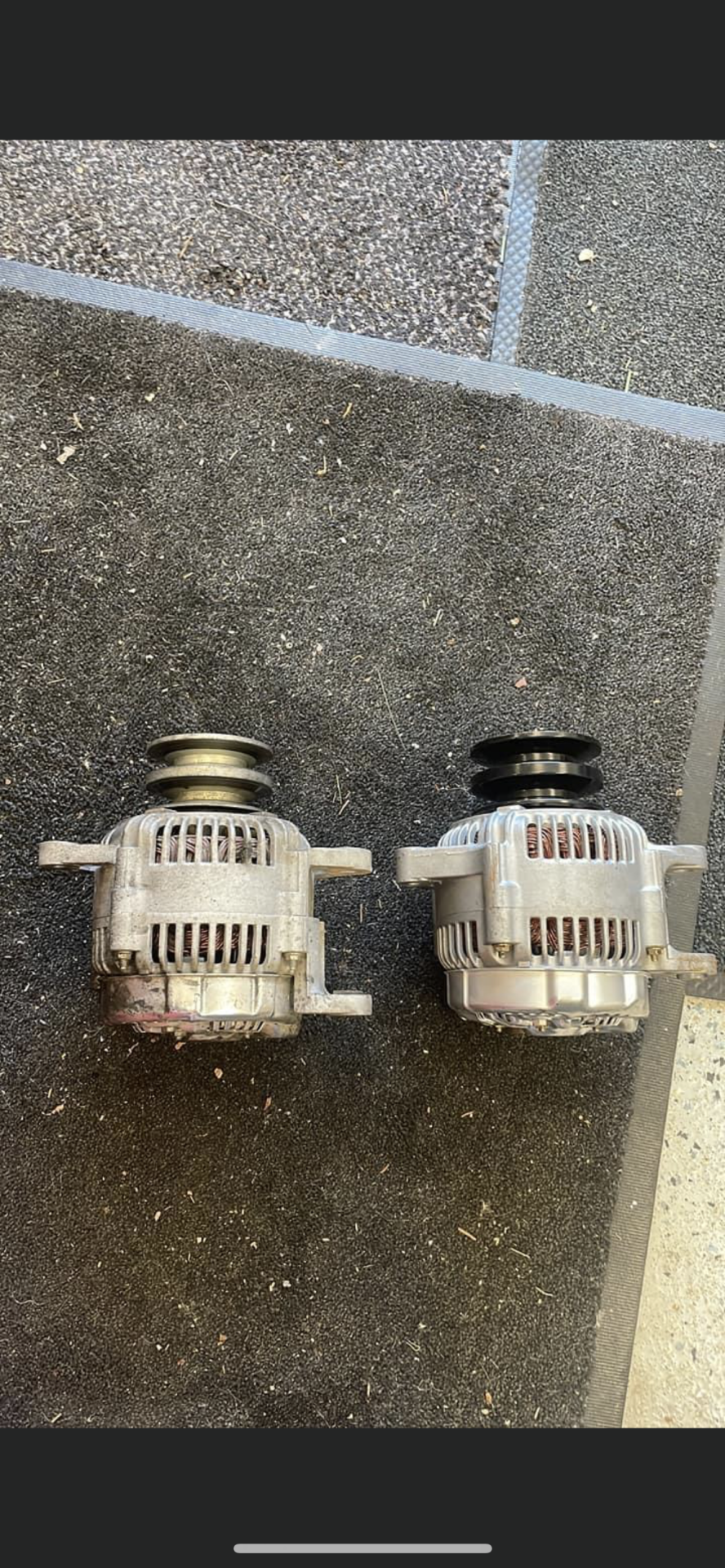

Hey everyone,
So my alternator went boom in my 91 3fe, and accordingly i bought another alternator to replace it (denso 210-0177). After trying to install the new denso replacement (pictured right) I found out that the mounts are to small.
Does anyone know what I am supposed to do? I can’t find any alternator that is correct for it and there’s no part number on the old one (left side) to look it up.

this will solve your parts issue ........
it has the correct lower pivot tabs spacing u need
It looks like your new alternator is a 90 amp and the old is an 80 amp.
Based on part number also
I used the alternator from my FJ62 on my FJ80 when it was hard to get what I needed. To use the 90 amp, you need to modify the upper mount bracket and get or make a different lower mount. I'm going to make a jig and make my own lower mount when I get a little time so I can use the 90 amp I have sitting here. Or, good luck finding the parts. Toyota made them, but they're NLA.
for posterity's sake- I had this same issue after purchasing a new 90 A alternator from cruiser outfitters. An hour or two with a grinder and i was in business. I took off some of the new alternator and some of the mounting bracket.
