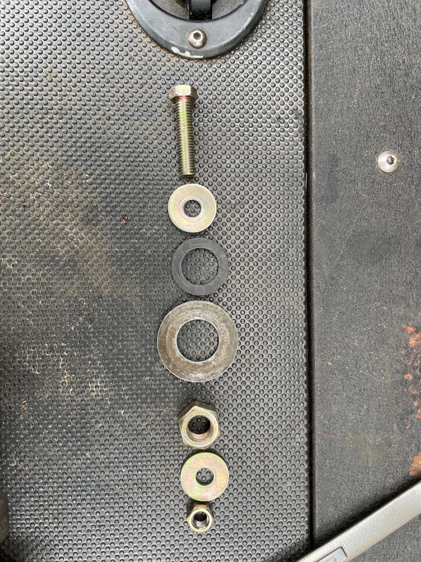

Rig up a bolt, nut, washer affair and you can push the spacer out enough to install the alternator. When you bolt in the alternator the spacer will be pushed back in.
