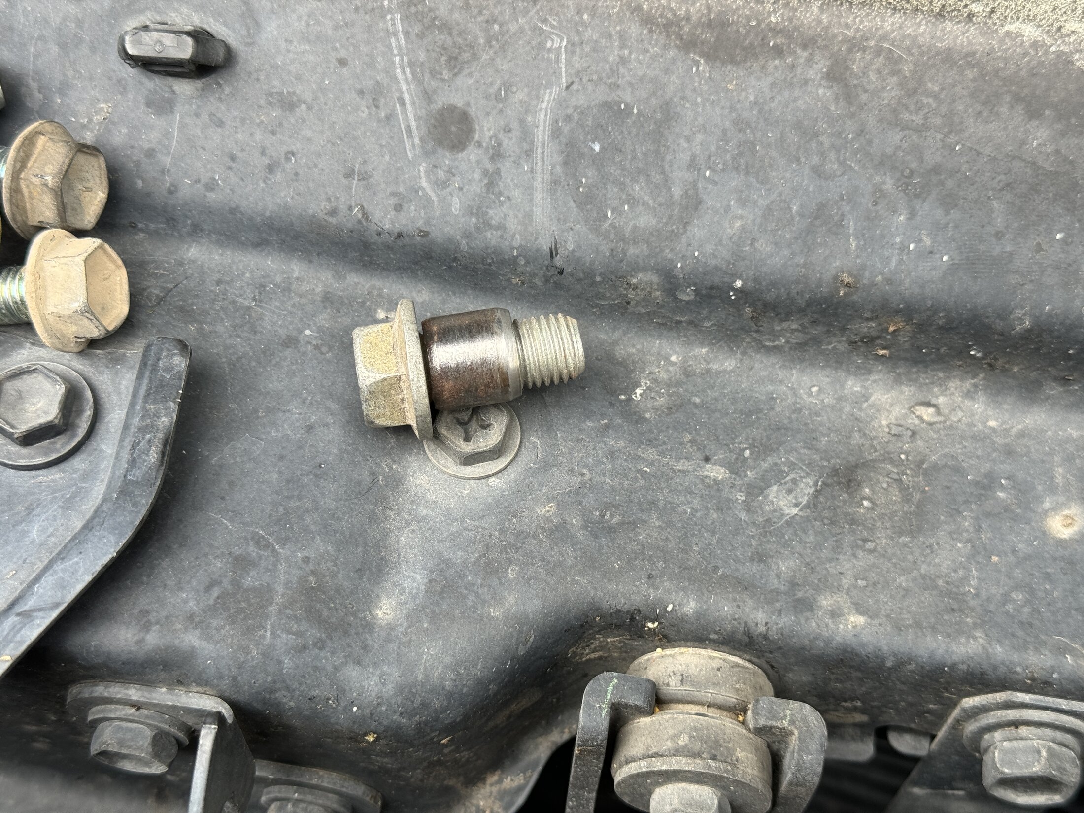

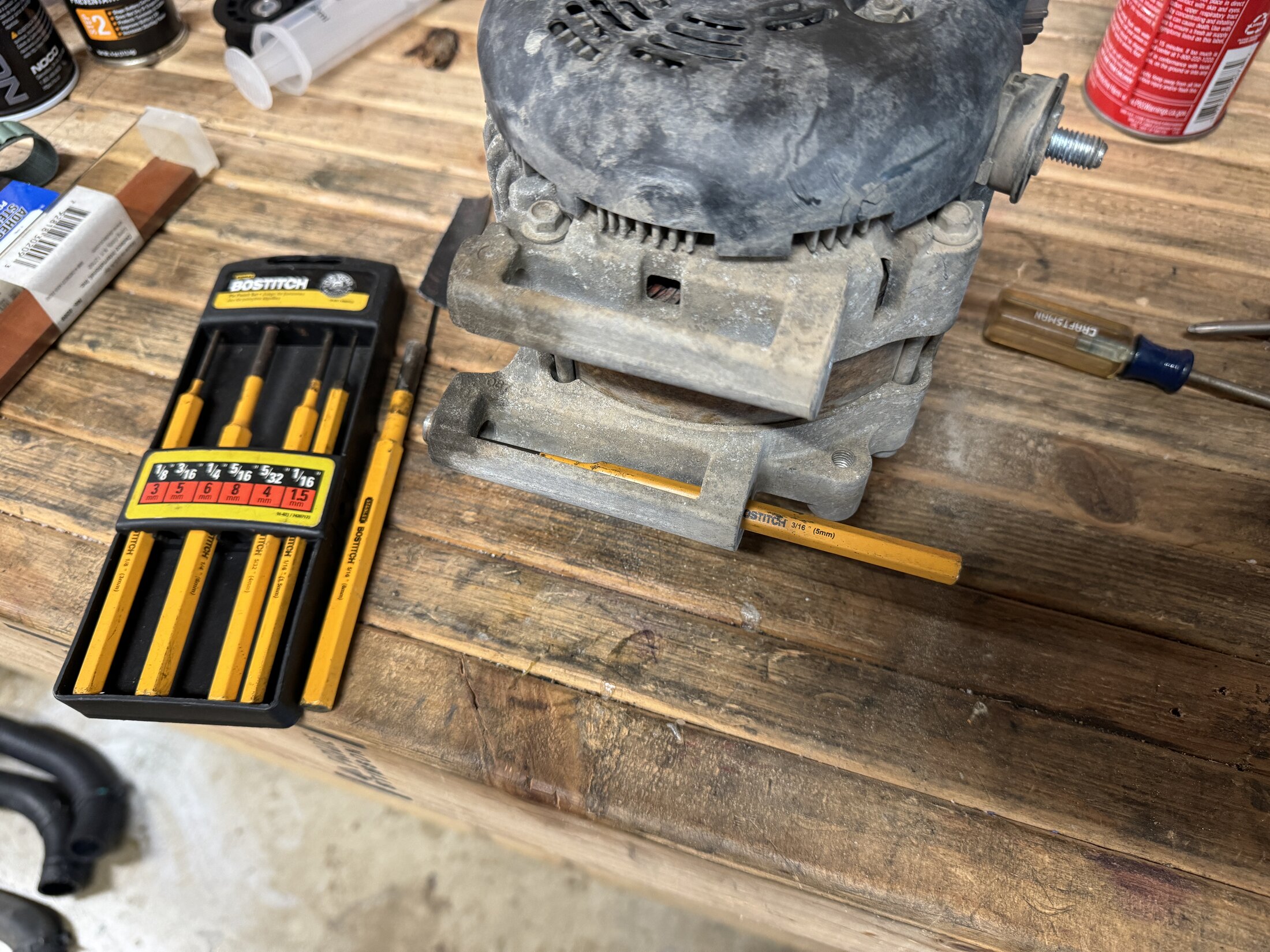

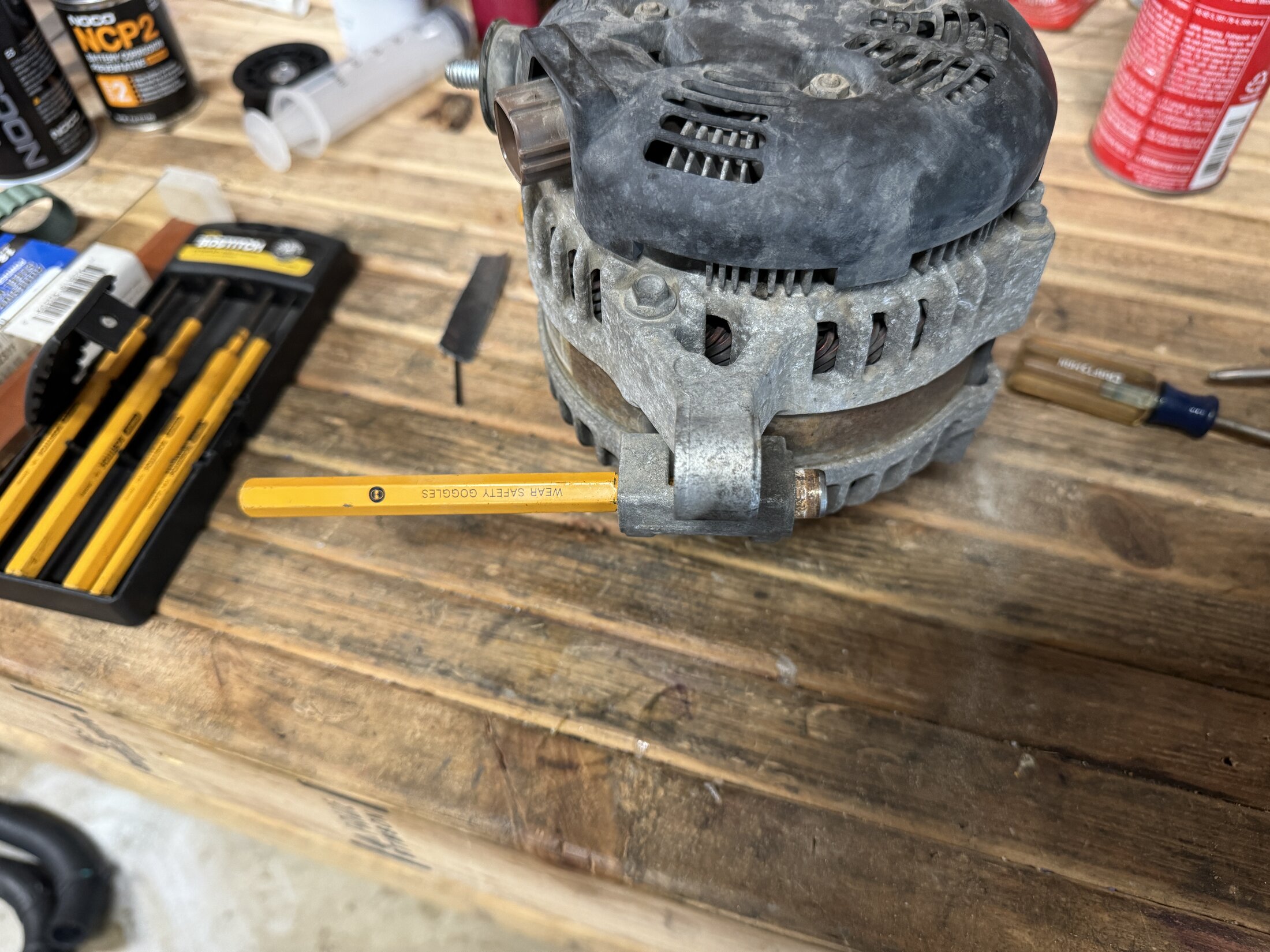

I and at least another person @Bryanmc had difficulty getting the alternator away from the block even with all of the bolts removed. It turns out there are some locating sleeves pressed into the timing cover that ensure the alternator is in a spot that will keep the serpentine belt in line. Those sleeves can corrode into their spots in the alternator, and pull out of the timing cover.
This little guy isn't supposed to be on the work bench with the alternator..

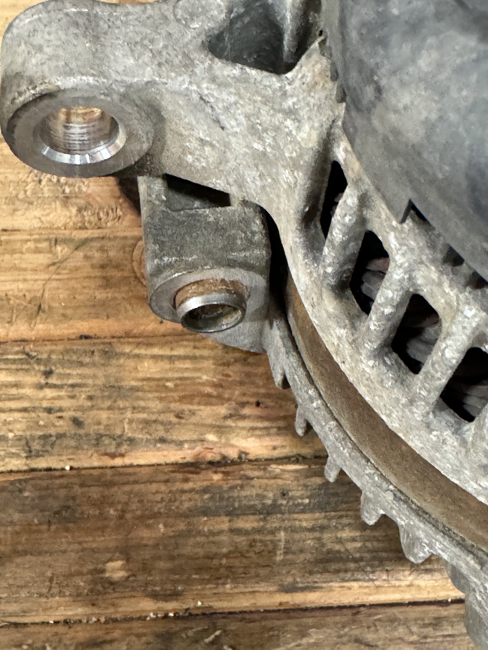

A couple of different size punches were able to get them out without damage
I then cleaned them up and used spare bolts and spacers to pull them back into the timing cover
