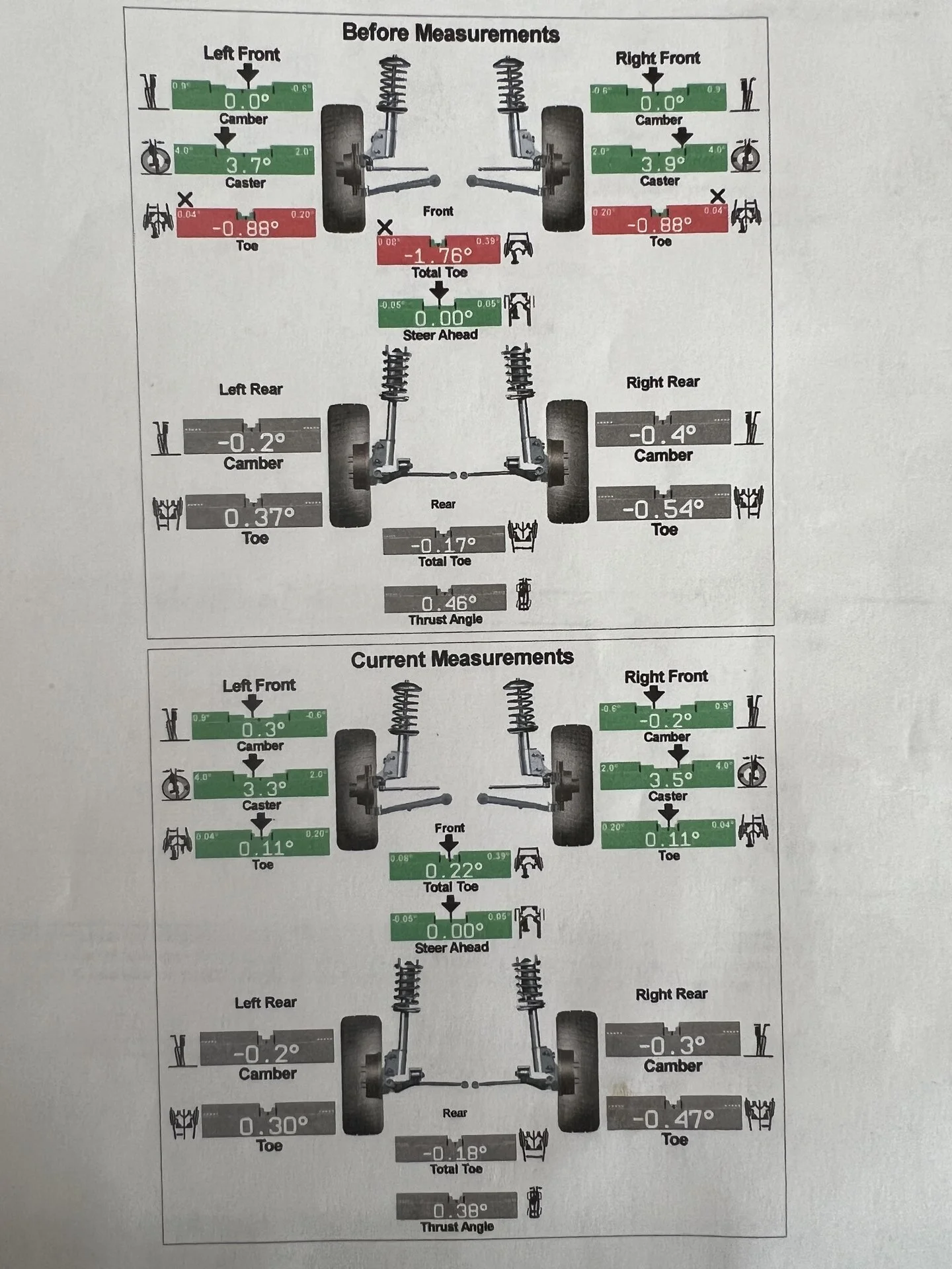

I'm looking for some alignment advice. Sorry to start another alignment thread, but I've read through as many as I can with search. I have a 2" Dobinsons MRA lift with Dobinsons UCA. I'm getting some tire wear on the outer edges, squeaking on the pavement when turning sharp at low speeds, and things feel pretty squirrelly when hitting a bump/pothole on the freeway. I'm taking the LC in for an alignment tomorrow, what would you recommend asking the tech to change?
Here are the specs after the most recent alignment about 6 months ago after installing lift. Based on what I have read so far, I think I would have been happier had they just corrected the toe.

You want as much positive caster and just a little bit of negative camber, Caster is a non wearing angle so it's ok to be out of specs. camber on the other hand will chew up tires. Do you have a rear track bar? I noticed the after reading is different, is the rear independent suspension? Give it as much toe in possible being an AWD vehicle.
I don’t know why the rear changed. I have an adjustable panhard and pck, stock other than that. Not independent in the rear. I didn’t think they would touch the rear so I missed that.
Just use it for reference when you get another reading, Just for chits, ask the shop if they could set the adjustments with a person on the driver seat close to your weight and get a full tank of gas if you drive with a passenger it's also a good idea to have someone sitting there too. You will get a different reading for sure, i use to align my vehicles like this.

Well, there's not a lot to report back. This shop only adjusted the toe even though I asked for caster closer to 4 degrees. They said the only reason to do that is if you're rubbing on the body mount and the truck drives well. It's tough to find a shop that cares about your vehicle as much as you do!

Did you discuss the issues with the service writer or talked to the mechanic? So they just took your money, I would bring it up with the person in charge if you want it done right. Could you post up the readings?
Thanks for the advice, but I think in this case it's better to not waste anymore time with them. Service writer seemed to genuinely think that caster was only for tire clearance. Toe had moved out of spec after I removed a shock for maintenance and they fixed that, so they did not just take my money. I was just hoping to get the alignment dialed in better when they were fixing that issue for me, but they are a toe and go shop apparently. Won't be back for future service, but I will probably call to speak with a manager tomorrow to ask why they didn't attempt to raise the caster or decrease the positive camber like I asked.
Your caster is fine. A bit higher is typically preferred for lifted trucks but 3.2 to 3.4 degrees should handle nicely. If you’re having issues with the vehicle not tracking right it sounds like it’s because your ball joints are worn. I needed new upper ball joints on my SPC arms after 75k. The truck felt like it was wandering on the highway and not as precise steering. New uppers fixed that. OEM joints seem to last longer.

Here is my alignment done at Slee. I would call this ideal for a lifted truck, but if your caster is a half degree lower and your camber is 1/4 degree higher or a tenth or so lower I don’t think it will have a huge impact on handling.
