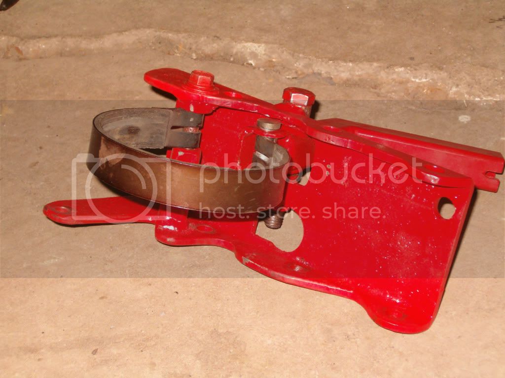

Out of curiosiity, explain the logic on the grab handle, you're using it for the e-brake, correct, or something else?

The grab handle came about from a failed attempt at a tranfer case brake that used a go cart drum and band brake.
It functioned but did not have the holding power I had hoped for. I didn't expect it to hold on a steep climb but more of a parking brake.
Back to the question, since the parking brake did not work well enough, I switched the handle to the other side for the wife to use as a second grab handle. The logic comes in at anything that is held in two planes will be more secure than a single plane. With the dash mounted one that keeps her stable front to back the side mounted one keeps her from rocking side to side. This also is a great way to keep her hand away from grabing onto the window frame. The handle does not appear to be very strong for that application with as much as I have cut off the base but there is a piece of the ratcheting plate that is 1/4" thick inside the handle as well. I will not second guess the safety for the wife. She loves it and uses it constantly.
