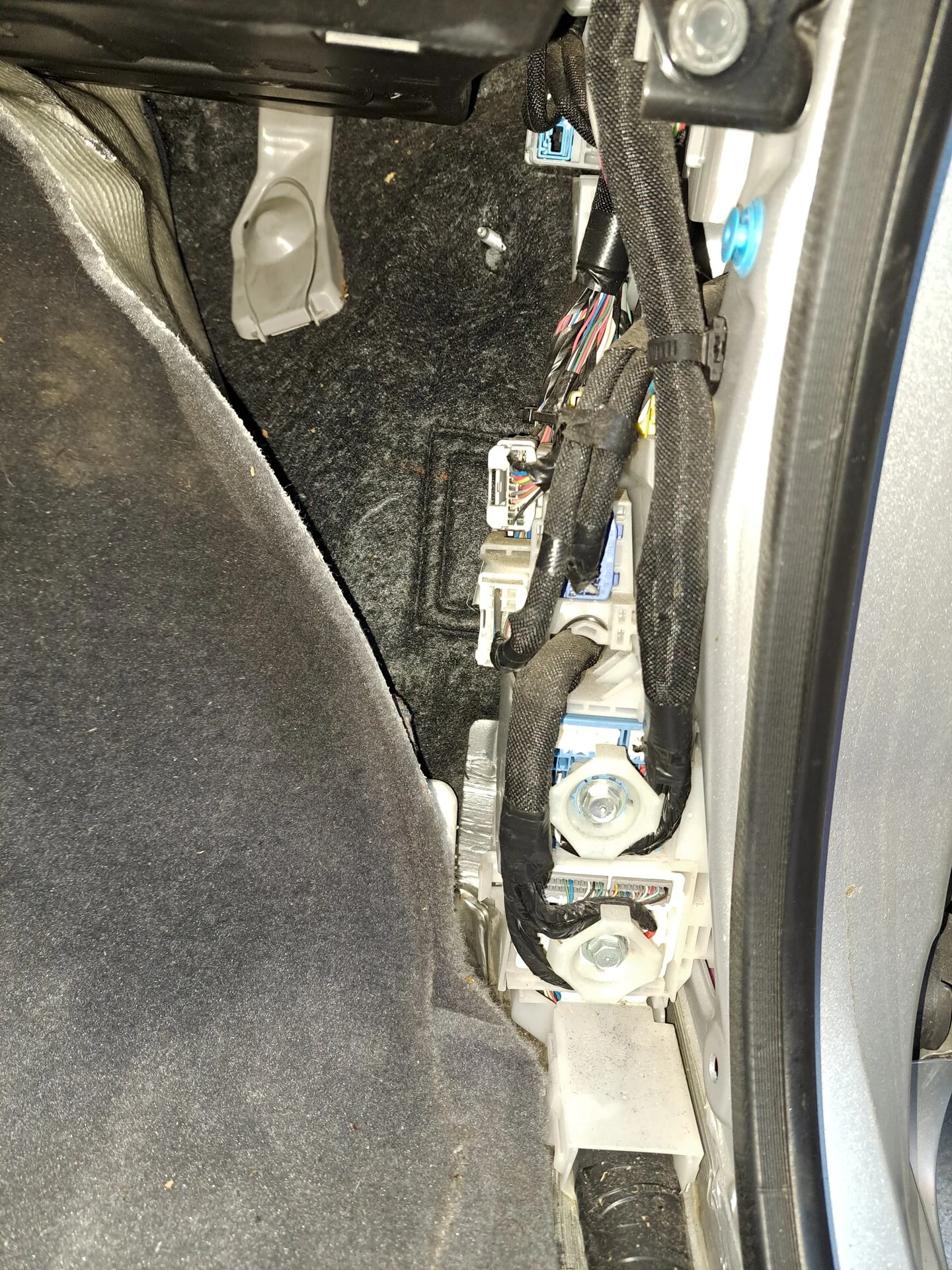

Update: cleaned all connections and applied dielectric grease at passenger side kick panel and everything is up and working. There was no sign of water intrusion but i did install a roof rack and new Windshield and will look into those places.
This morning my key fob wouldn't open door. I was able to use the actual key to open the door and start but alarm won't stop, mirrors don't function, steering doesn't move to preset and red key light flashes on dash. I changed fobs, new batteries and able to drive with alarm horn disconnected. It rained last night but passenger floor board is dry. Now what ??
You might not be seeing water that has gotten into the connectors behind the passenger kick panel.
Would be worth taking off the panel to have a look, the symptoms are pointing to this as the likely problem.
I had the same problem, took a look and sure enough this was the issue. Cleaned out the contacts with a hair dryer, added dielectric grease, problem solved.

I did pull the panel and didn't really see any moisture. I will pull it apart further and look with more detail. What is best way or procedure for cleaning sunroof drains ?

If you didn't see any moisture when you detached the plugs you took a picture of, or green corrosion from former water ingress, then it's probably not the issue.
