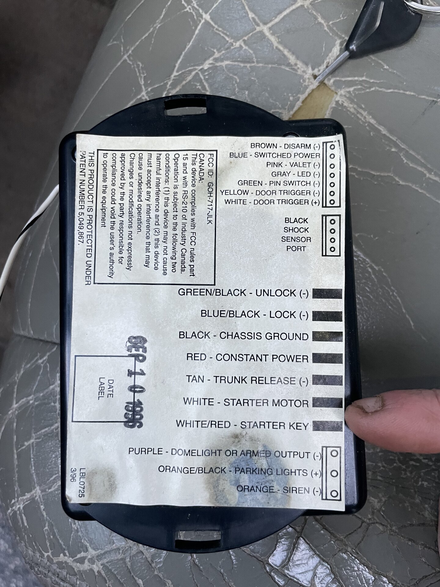

I’ve got a 96’ 80 series with an alarm system that is killing me! It is so sensitive and I want to delete it. I took apart power dash to discover the module and sensor with all the wires, was able to cut out the speaker, but still trying to figure out how to delete the module without any issues.
When I unplugged the wires from the unit, and then reattached the battery, the truck had power but won’t turn over or start up. Thinking it had to do with the starter motor and starter key wires slots (pictures below).
Any insight into this?

Usually there is only one wire that is interrupted, probably those white starter wires. You need to follow those and re connect. The rest will tap into other wires and will need to be removed and Usually a t tap cleaned up.

Stop guessing. The answer is in your 2nd photo. You need to reconnect the original circuit. Not much different than factory alarm removal. It's 90s technology. Get a voltmeter and learn the basics of 12v auto electronics. Certain things have constant power, and certain things have power only when you turn the key.
And please don't leave those wires just taped up like that.
Follow then back and terminate then correctly
White with Red should be connected to the ignition switch circuit. Turn ket to "Start" position and check for 12V.
Ohm meter set to continuity check white wire to starter (pull from the starter connector). If continuity, connect white to White/Red.
