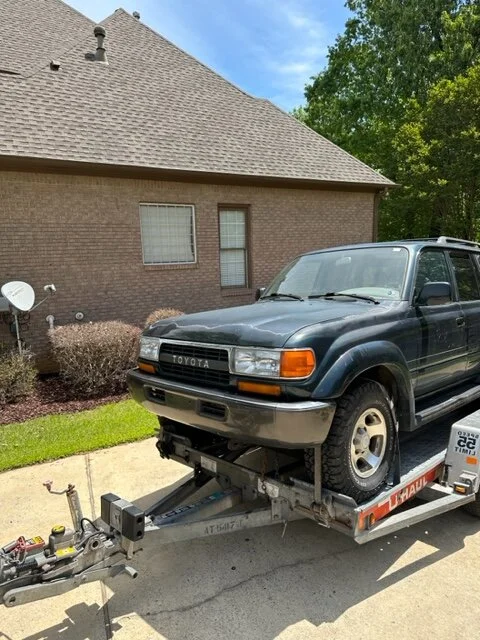

Another resto-mod. Starting this thread to document (for me mostly) everything I am doing. And since I have less than one banana skills, I will certainly hit dead-ends and have questions; help always appreciated. Maybe this will help when I sell it one day (lol). I have had five land cruisers, all bought on impulse without much thought, investigation, or research. This is my first 80. I have been wanting one for a while, found this truck here on Mud, and off I went to Michigan.

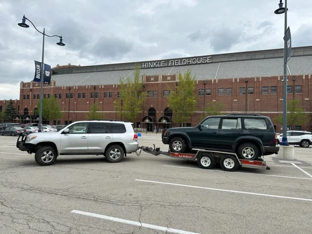

Loaded up 04/22/2023:
Got to see Hinkle Field House (from the movie "Hoosiers") on the way home:

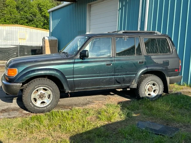

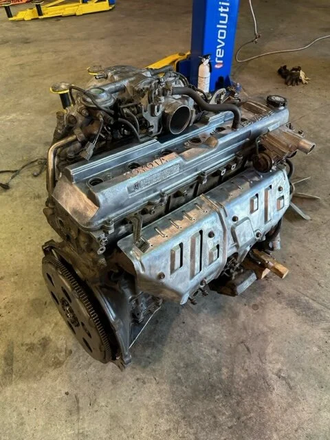

One week later (04/28/2023). Mud member @fourtrax had a spare 1FZ-FE, so I took off to NC to pick it up. He already had it palleted up for me! Enjoyed shooting the breeze with him in his shop for a while then hit the road.
This is what it looked like when we set it down:
Story on this motor (@fourtrax please correct me if I get it wrong) is that this was in a LC until it got about 120K on it, then the cruiser was rolled, and it then spent about 10K in a buggy of some kind), so it has about 130K on it.

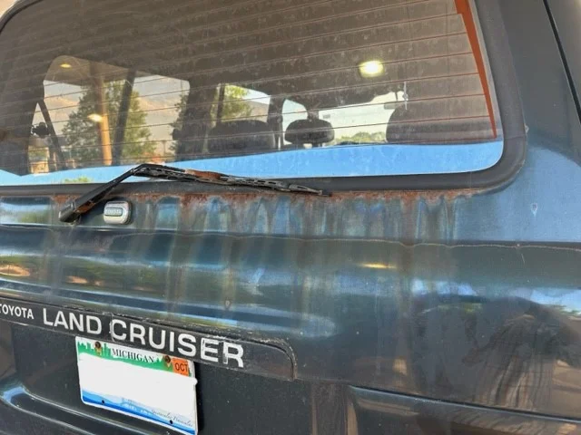

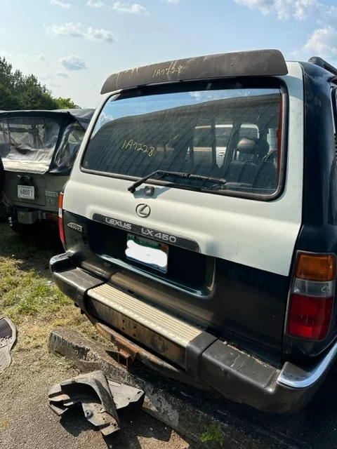

This was the one body panel that was going to be unworkable:
05/26/2023 - After a trip to the junkyard in northwest AL:

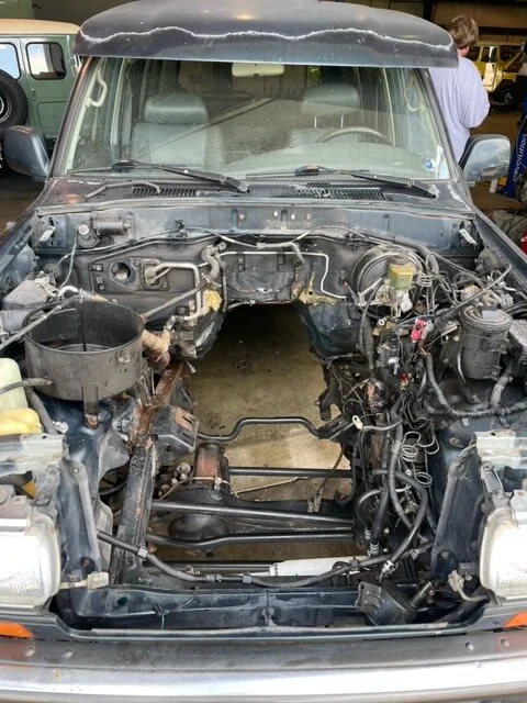

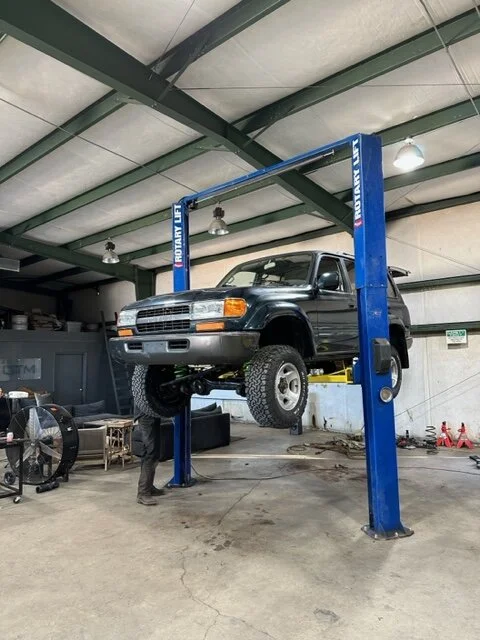

Flash forward to mid-June 2023. Truck is at OTM Cruisers, who just opened up their third (big, bigger, just right) shop in two years. They are setting things on fire around here with the new shop just east of B'ham in Leeds, AL.

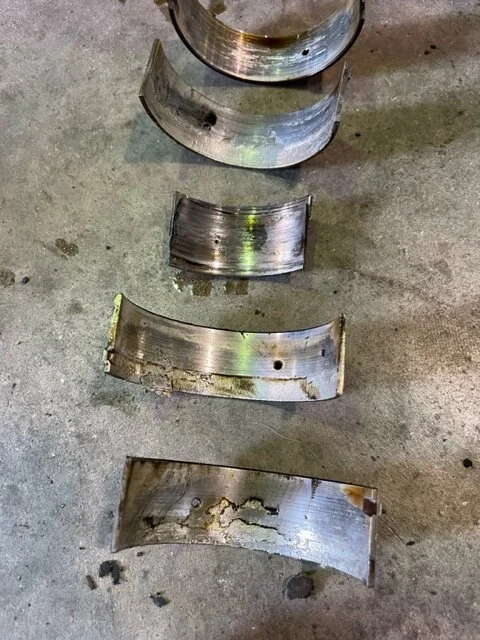

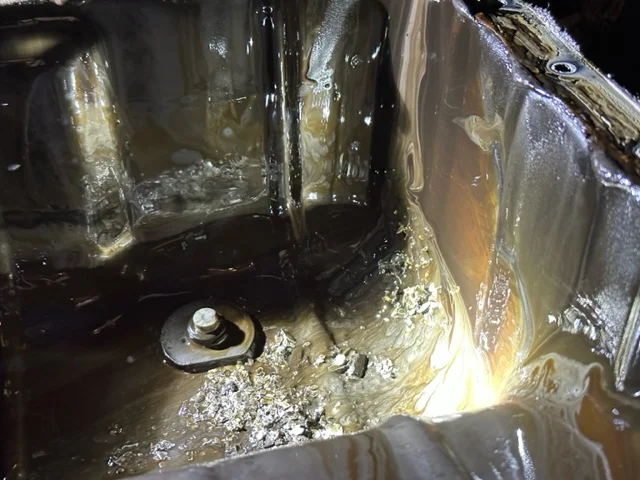

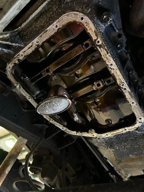

Found out why the motor was seized:
Yeah that's not good.
Like looking into the chest cavity of a dead person:

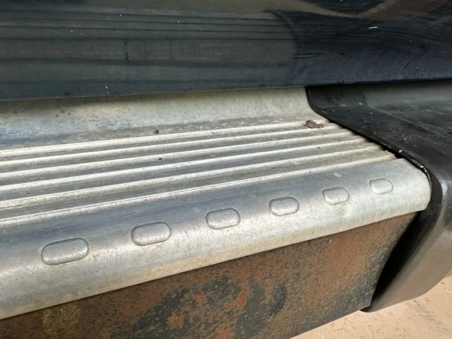

Also deleted running boards:

OTM got the new 1FZ-FE in and running about three weeks ago. New seals, gaskets, belts, hoses, starter motor, battery, long list. No leaks so far.

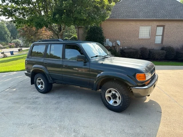

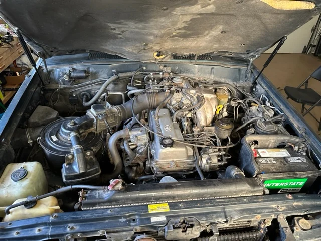

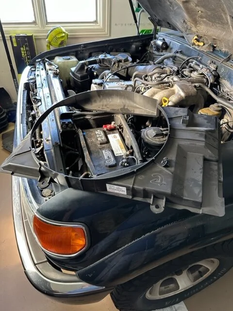

Fan shroud 16711-66031. Two bolts 90119-08539.

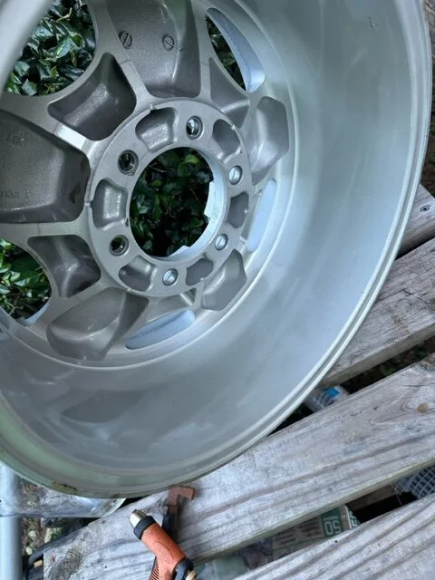

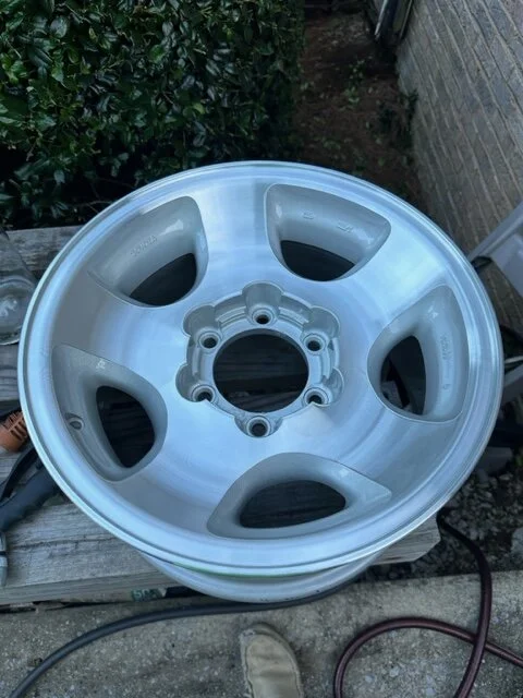

Wheel was down to the metal in some places. After some rehab and Wheelskins:

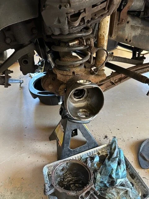

All of a sudden my driver's knuckle started spewing. I am attacking the front axle this weekend and emptying diff oil, doing both knuckles, changing rotors, and refilling diffs. This is a big deal for me because again I am one banana. This is a new to me truck so needed to be done and don't know what I will find.

So I did this several weeks ago. It was a major undertaking for this 1/2 banana paper-pusher. Glad it is done. Don't want to do it often.

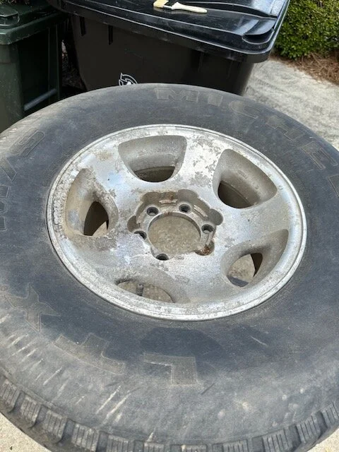

Spare under the truck was in very bad shape.

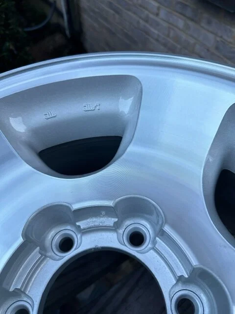

I tried my best with stripper, sandpaper, even a brass wheel, but it was beyond my ability, so I took it to a local wheel restorer:
Beauty. I can make do for now with the others as-is, but one day I may treat myself and get the others done like this.

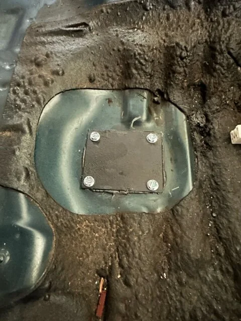

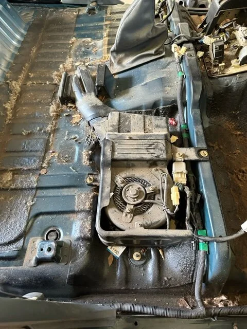

Rear heater was capped off previously by someone, but still in the truck. No more.

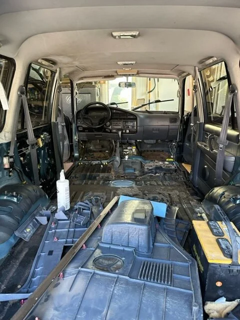

Interior is out. New carpet and seats inbound.

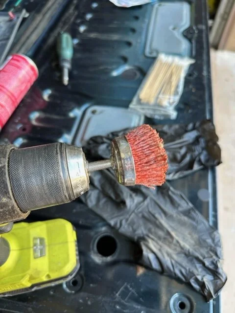

Don't know if this will help anyone, but a couple of tips:
This nylon brush is the bomb for getting old carpet mat fuzz off both the truck floor and the carpet itself.

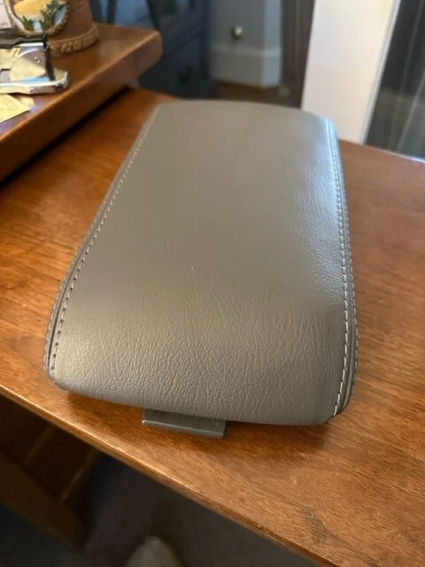

Baby steps to DD status:
Before:
After:

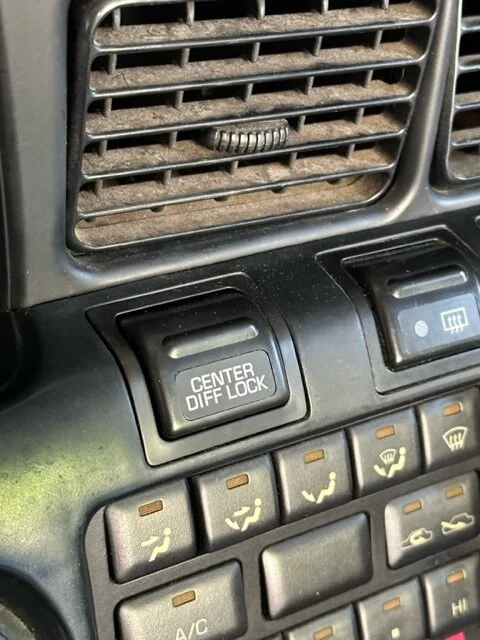

Got one of these in this weekend (I will hit the vents soon with the AC refurb):
