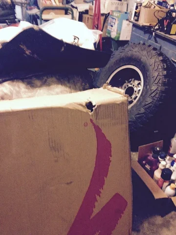

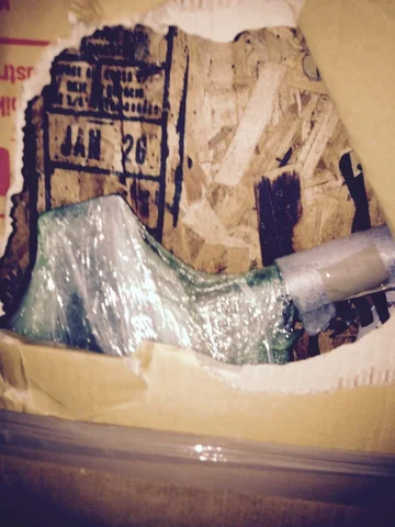

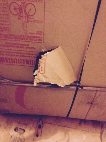

small tear in box corner.webp big tear in middle.webp inside big tear.webp cant wait to get home from work, mine has been marked as delivered......
note on the door says any problems call......looked inside the big tear and its packed well so it seems to be alright, been too busy to unpack it last night but should be doing it later tonight...depends as the water company has made a mess on the end of my driveway and im waiting on a call from a supervisor to inspect and correct the crap they have done to it...........

View attachment 1122744 View attachment 1122745 View attachment 1122746 cant wait to get home from work, mine has been marked as delivered......
My shipment arrived in similar condition. Contents were just fine, though.
Mine too. Contents were just fine! I did have to use two 12x1.25 mm bolts for the two threaded upper pintle hook holes. The supplied bolts didnt fit, no biggie since I had some lying around.
