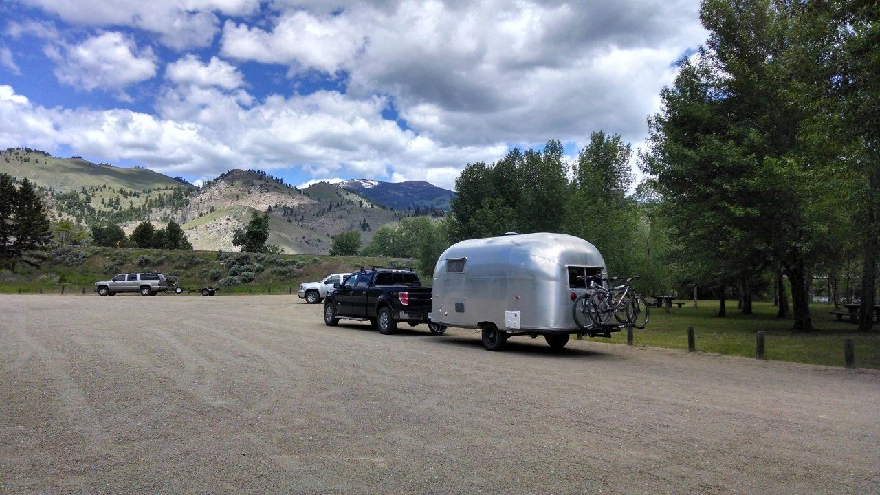

We have a 1960 Caravell that we had gutted to the core and refurbished. Its got a lift over stock and larger tires. We have taken it on many rough roads camping in MT. I'll post some more details, but here are some pics...towed by the F150 not the Cruiser.
We have a 1960 Caravell that we had gutted to the core and refurbished. Its got a lift over stock and larger tires. We have taken it on many rough roads camping in MT. SNIP
Nice, classic trailer.:clap: It really is a lot easier to do one of these on a single-axle trailer. Not that you can't do a dual axle, just that there's complication you don't have with a single axle modification.

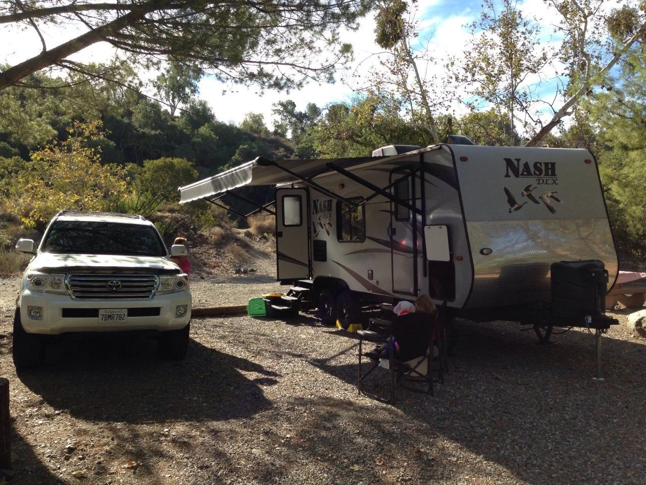

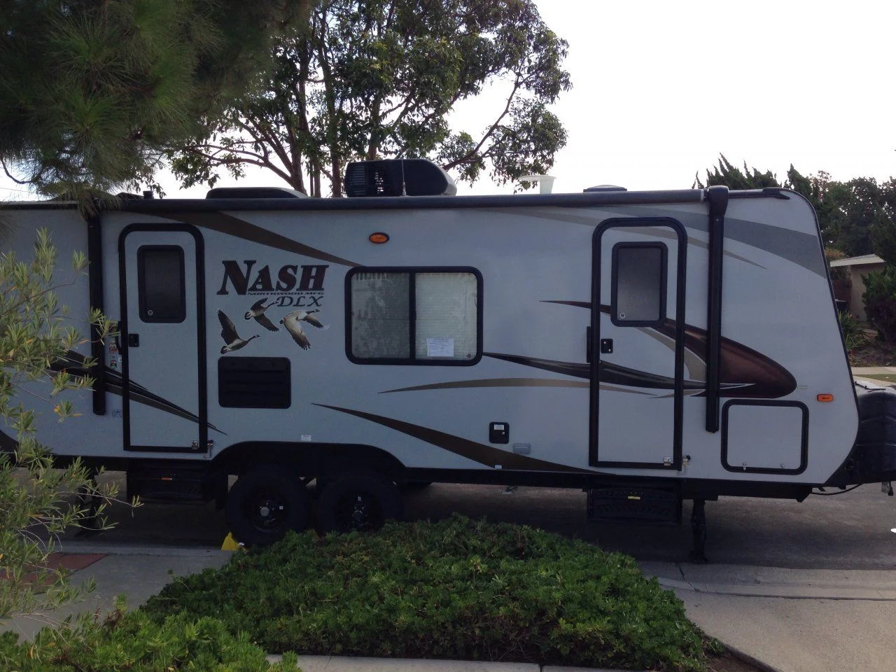

Try looking at Nash trailers - made by Northwood, same as the Arctic Fox but lighter. They have 17 and 18 footers but we went with a 23F for the large bathroom and no slideouts - definitely something you want to avoid if you're going off pavement.
Their claim to fame is an in-house built "off-road" chasis.
We flipped the axles and put on bigger tires (225s).
The built in LP generator, ducted A/C and heating are nice as well.
