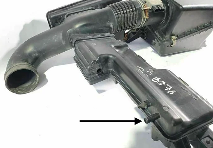

Hi
The nipple in the photo has broken off my airbox assembly - currently I have the hose taped on (not satisfactory) - Has anyone repaired this / similar and if so how did you do it?
The shop's suggestion was $1000 for a new air box.....:oops:
Thx
Jim

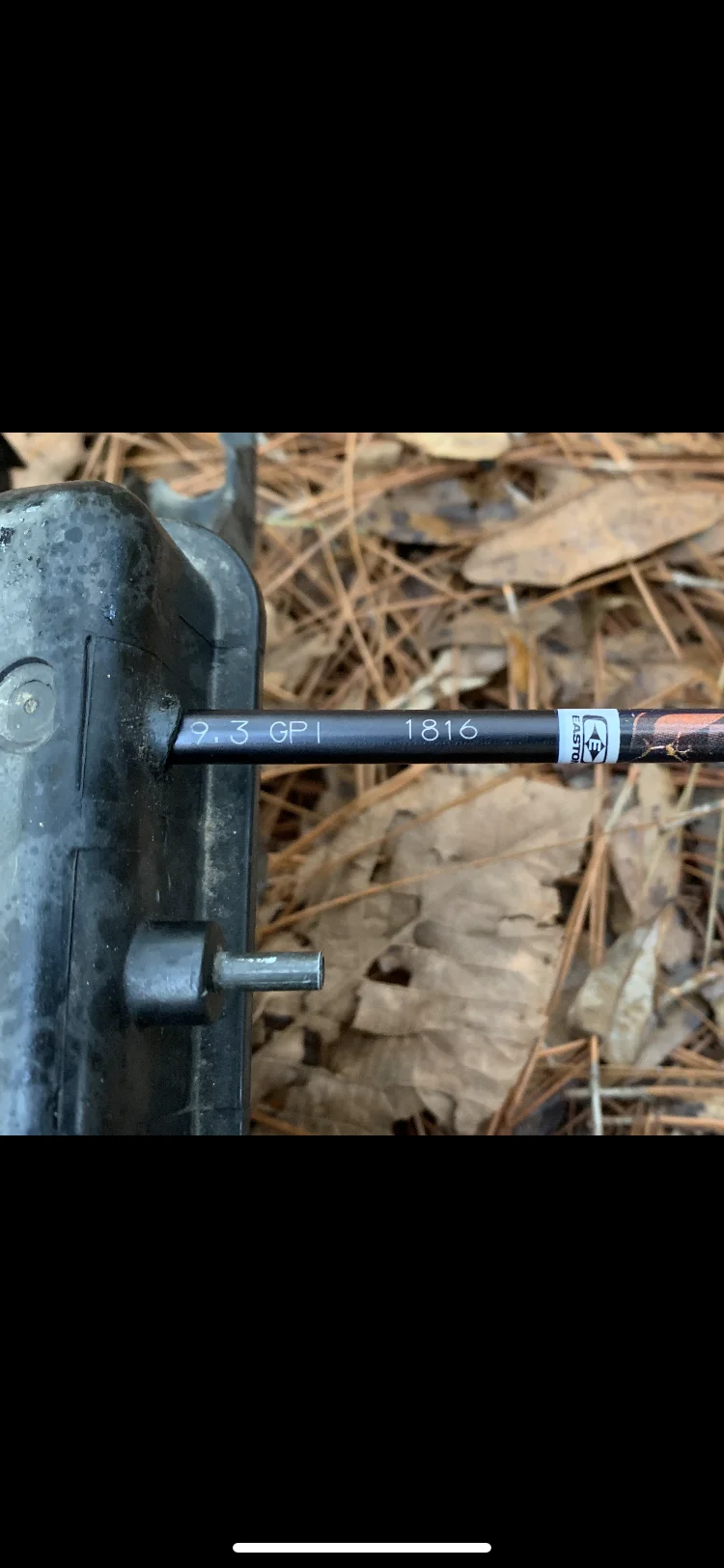

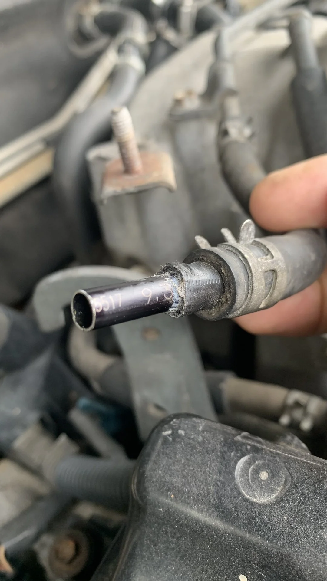

1.5” of 1816 aluminum arrow work well …if you’re a bowhunter and happen to have one. It will fit perfectly nice and tight inside the broken off nipple and then slide the hose over. No JB weld necessary.
that is more than awesome - exactly what I was looking for - someone who had fixed same issue - right off to raid the boy's arrows.....
I also used a small hose, electrical tape on this one, on other end to make hose fit tighter.
