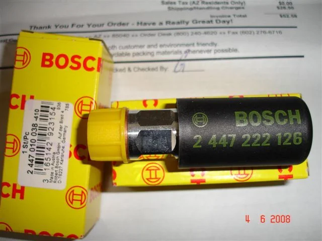

Which Bosch part number?
That's odd too - because I've been impressed with the el-cheapo Bosch pump I'm using. And I found the copper sealing washer that was supplied with mine was "perfect".

My mistake - it's a "Bosch replacement"
eBay Motors: Mercedes Diesel Primer pump,Bosch Upgrade 300D (item 350104710173 end time Mar-01-09 08:14:38 PST)
Very nice to not have to un-screw it!! the pump is working fine, just the seal of the copper washer. We'll get it eventually!
By the way in which that Ebay advertisement is worded, I think one would reasonably expect that primer to be "genuine Bosch".
And it is common for Ebay traders to avoid disclosing "supplier part numbers" on their sites (presumable so you can't by-pass them easily or compare their prices easily).
But all the Bosch primers that I've seen display the Bosch wording and a Bosch part number on the actually primer and the boxes are yellow and covered with the Bosch logo. For instance these are ones I got from Autohaus Arizona: (I know - Why would I get mine from Arizona? Well you folks over there have such good vendor-competition and therefore such cheap prices!!!)
So I'm not saying that what you got definitely isn't Bosch or is poor quality - But I am saying that if it isn't Bosch then your supplier is dishonest (by placing deliberately misleading advertising).
