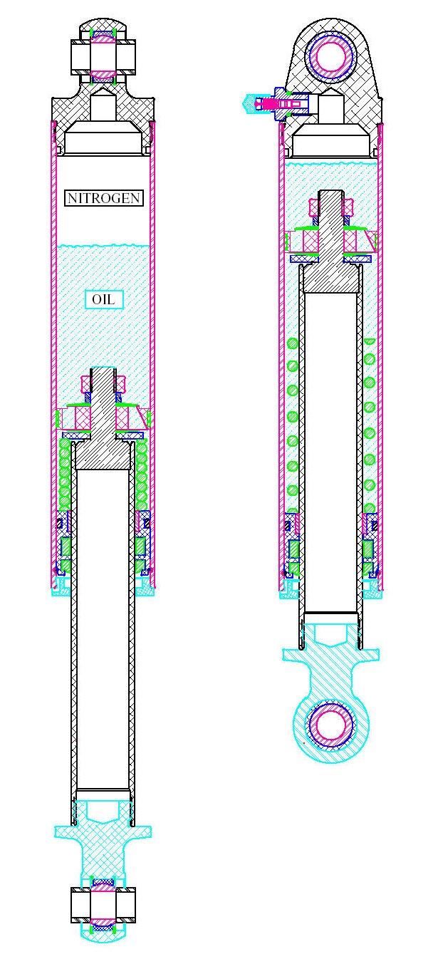

Dude, Air shocks have oil...
If they didn't, they would have no dampening and would be called a pogo stick :) They are basically an emulsion shock. PIC:
The coil/air hybrids are basically a threaded body airshock. I think the idea is to be able to run lower pressures and be easy to tune.
