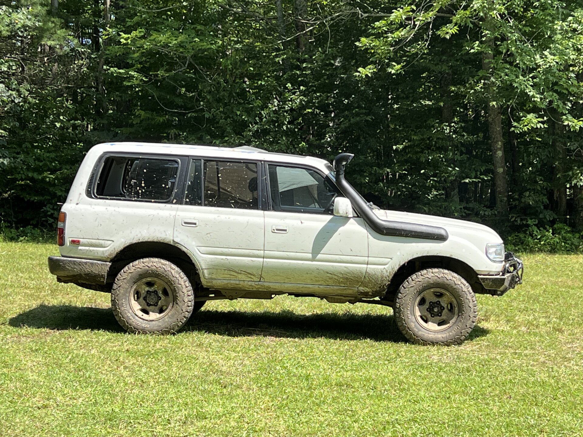

Beauty shot of the beast:
(Sliders in garage to be installed next. Spare tire and tow hitch coming off after that.)
