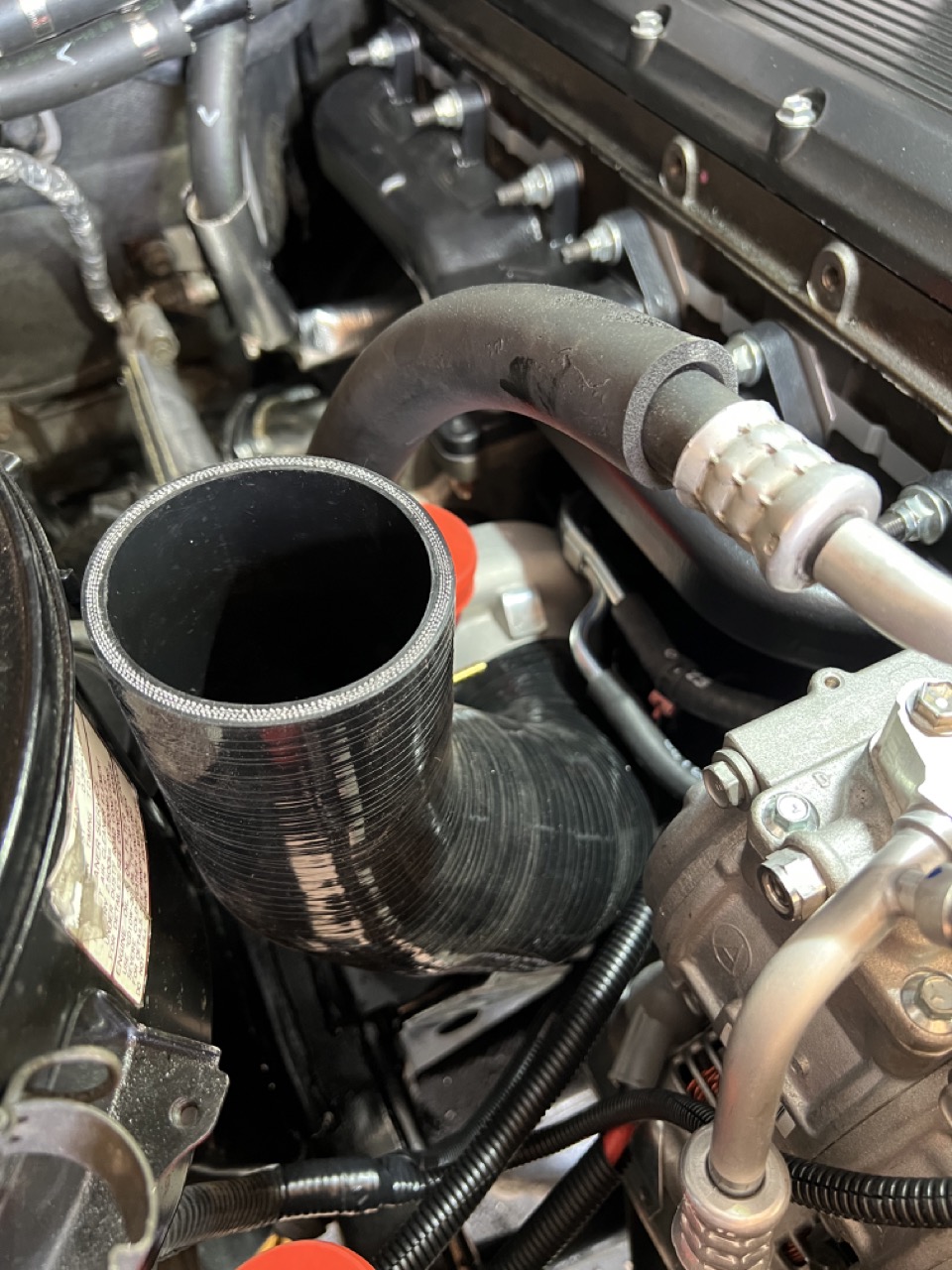

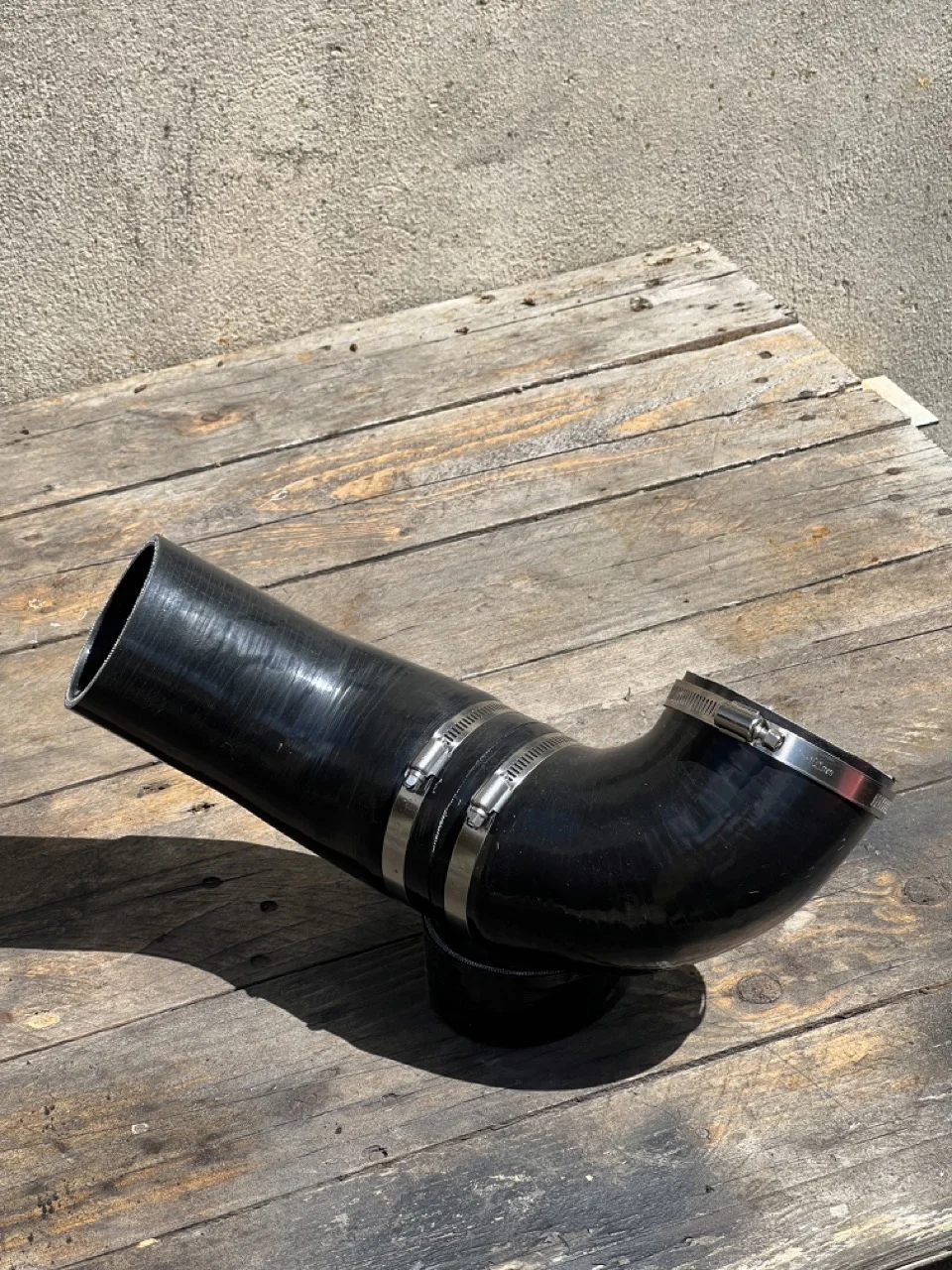

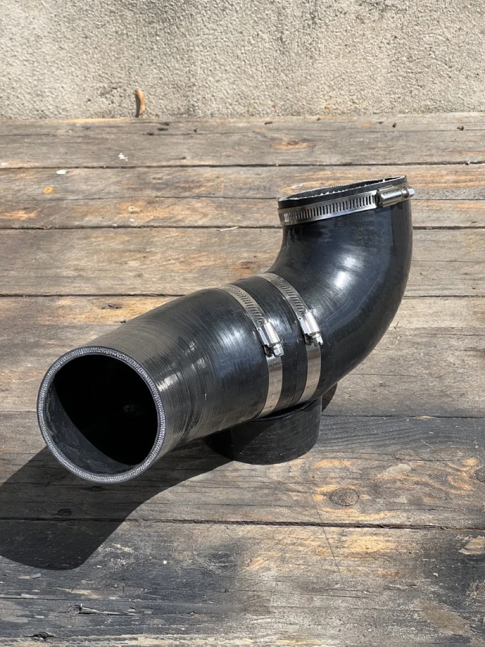

Hi expert folks,
I'm still working on rebuilding my 1993 LC80VX 1HD-T.
I've just added a GTurbo green wheel and kept the factory air filter box.
As Turbo inlet diameter is bigger than the original CT26, my plan to just renew the factory rubber pipe down not work. I've read some guys warm it in boiling water to have it fitted, but I don't trust that method.
So I've decided to build a proper pipe with 3 parts from an online pipe retailer : One 45° elbow reduction + I alloy coupler + 1 90°.
I'm about to install it, but my concern is :
- airbox is linked to the chassis
- turbo is linked to the engine
As engine can slightly move separately from the chassis, is this pipe flexible enough to last and to avoid any damage around because of various kind on strained ?
Here are some photos :
Thanks for your feedback.

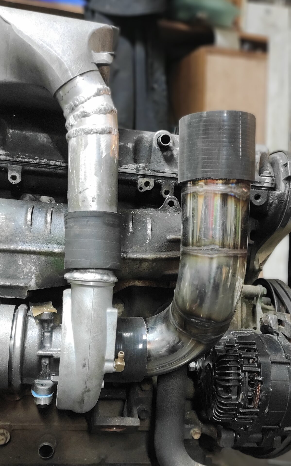

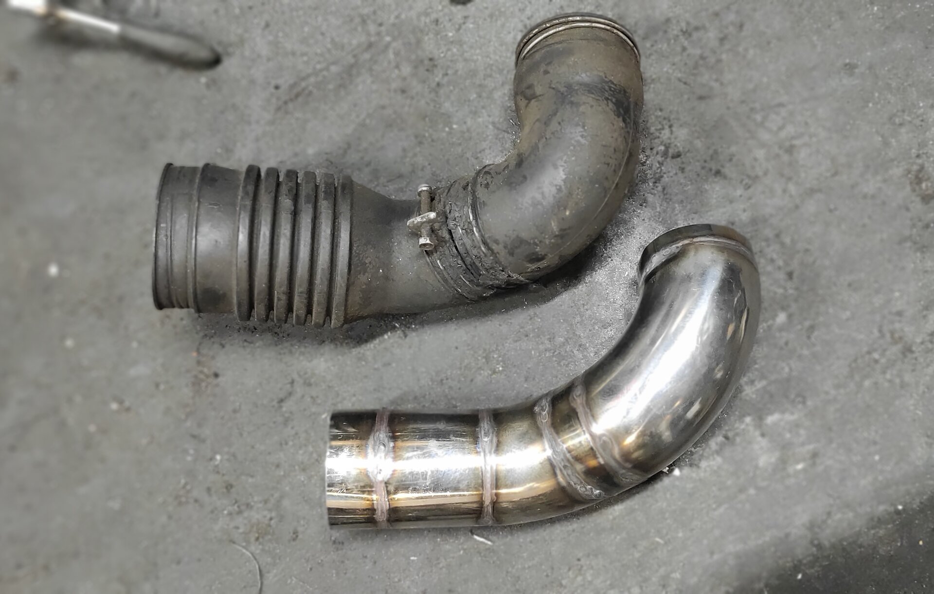

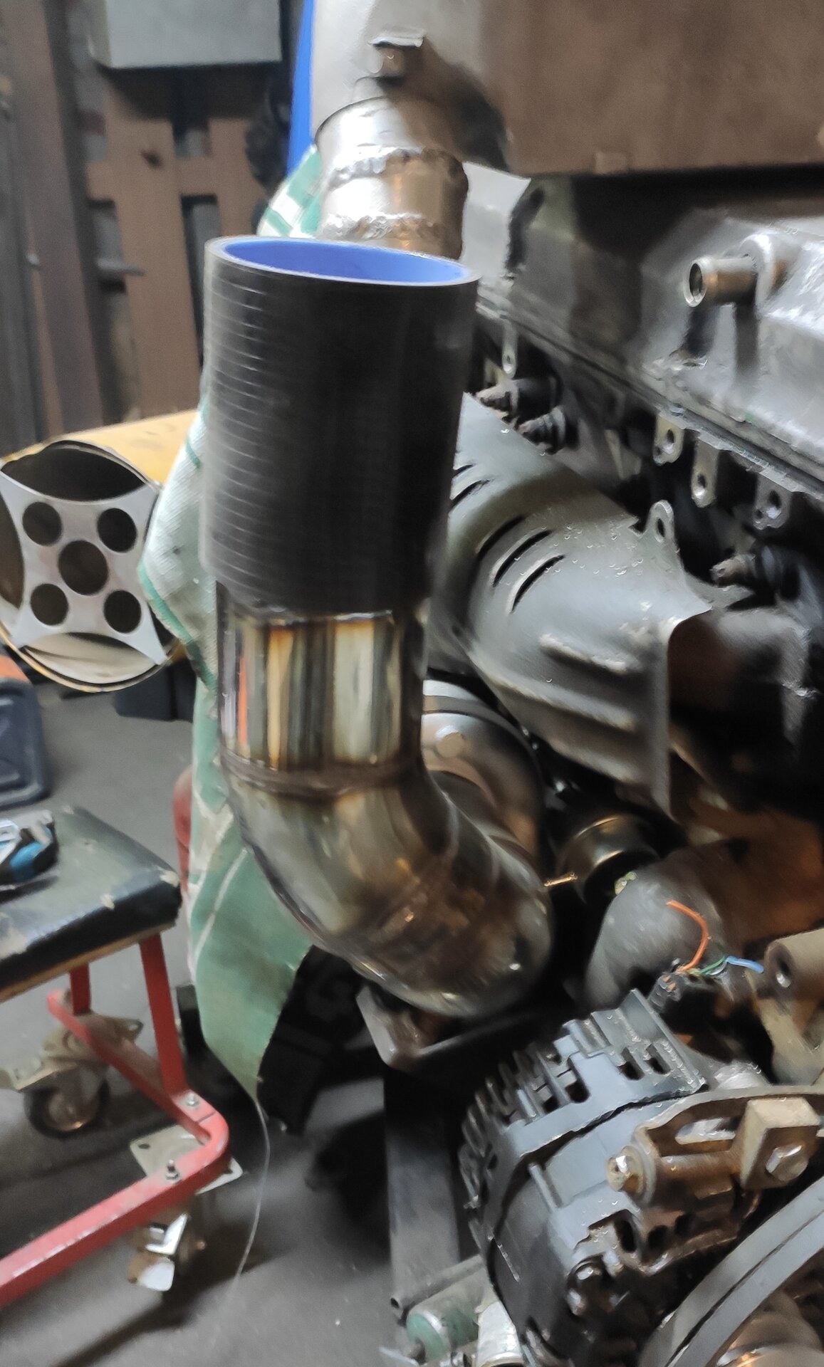

@Obrokoff, Any reasons you made it out of stainless and not aluminium and weld it directly to the turbo housing? Would save the need for an additional hose/clamps?
Otherwise I like it
Otherwise I like it
I hate aluminium. it oxidizes and looks lousy, it's hard to paint. And I like shiny parts )

I used a silicone nozzle on one car, the air discharge squeezed it and blocked the flow in front of the turbine
