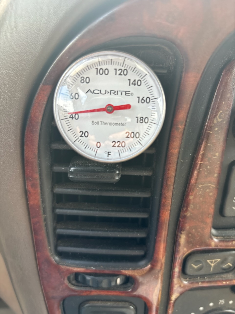

Still no A/C ... Check the pressures they are good

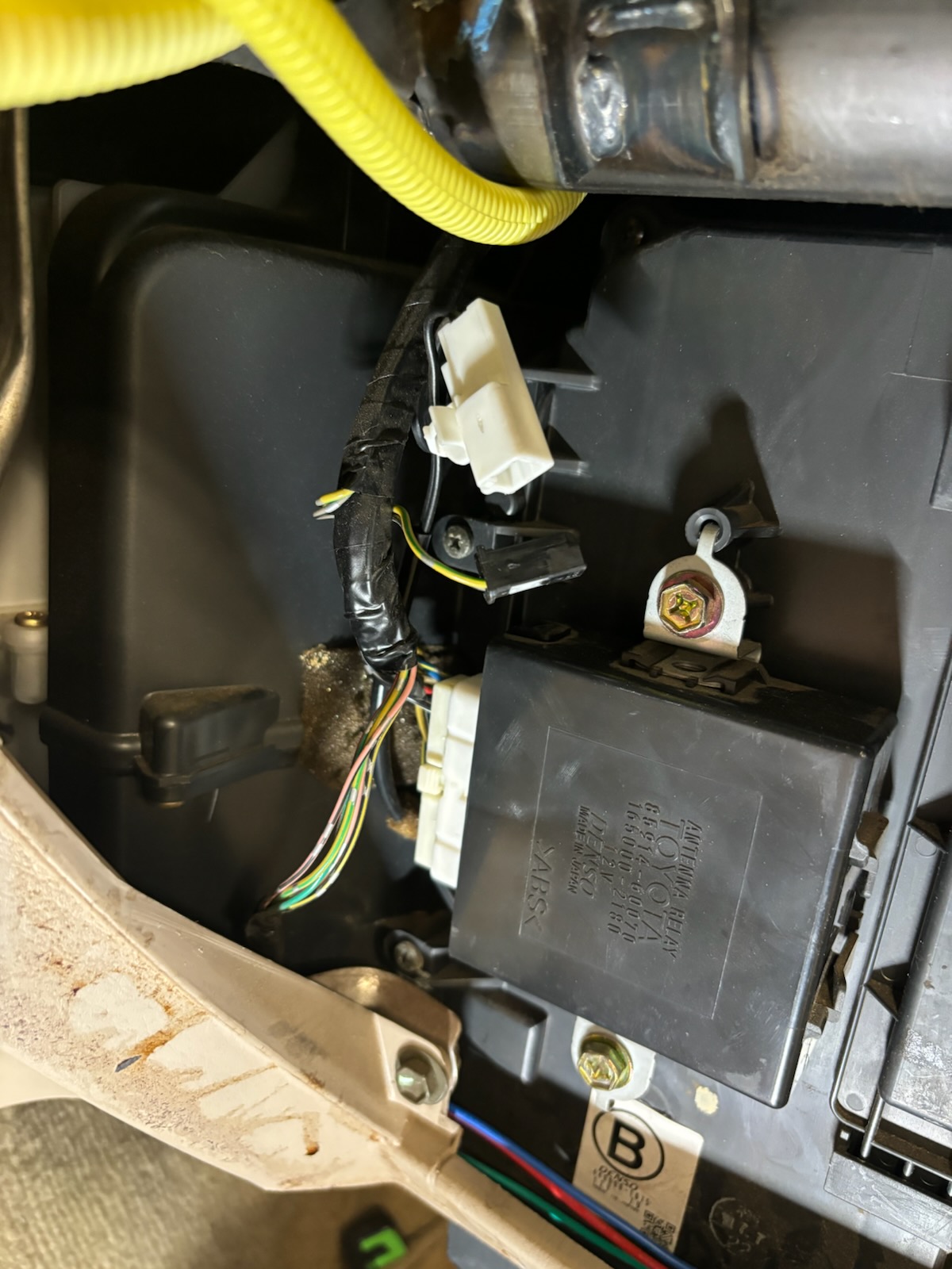

Bypassed the pressure switch still no luck put a different computer in the car behind the glove compartment and the HVAC computer behind all the controls.
Techstream is still getting a signal for "AC cut" and I don't know what else to check
Did you swap relays? Check high pressure and low pressure switches.
I bypassed the switch that is located drivers front side right next to the frame rail. ... Are you saying there is a 2nd one?
I am not too familiar with the 100 series system but it will have at least one pressure switch, some will have a low pressure cut off and high pressure cut off switch.
Just too add some compressor are variable which means there is another switch in the compressor.

If your compressor kicks on when bypassing and pressure is good then you should check all the electrical connectors related to ac, if you’ve done any ac work elsewhere.

Because my system doesn't have any leaks when I check the pressures the pressures are exactly where they need to be. I believe my problem is electrical not mechanical. It's a lot cheaper to try and diagnose electrical stuff with a multimeter then just start throwing parts out of vehicle hoping it'll get fixed. Step number one is identify the problem and I've ruled out any type of leaks by verifying pressures are good.
