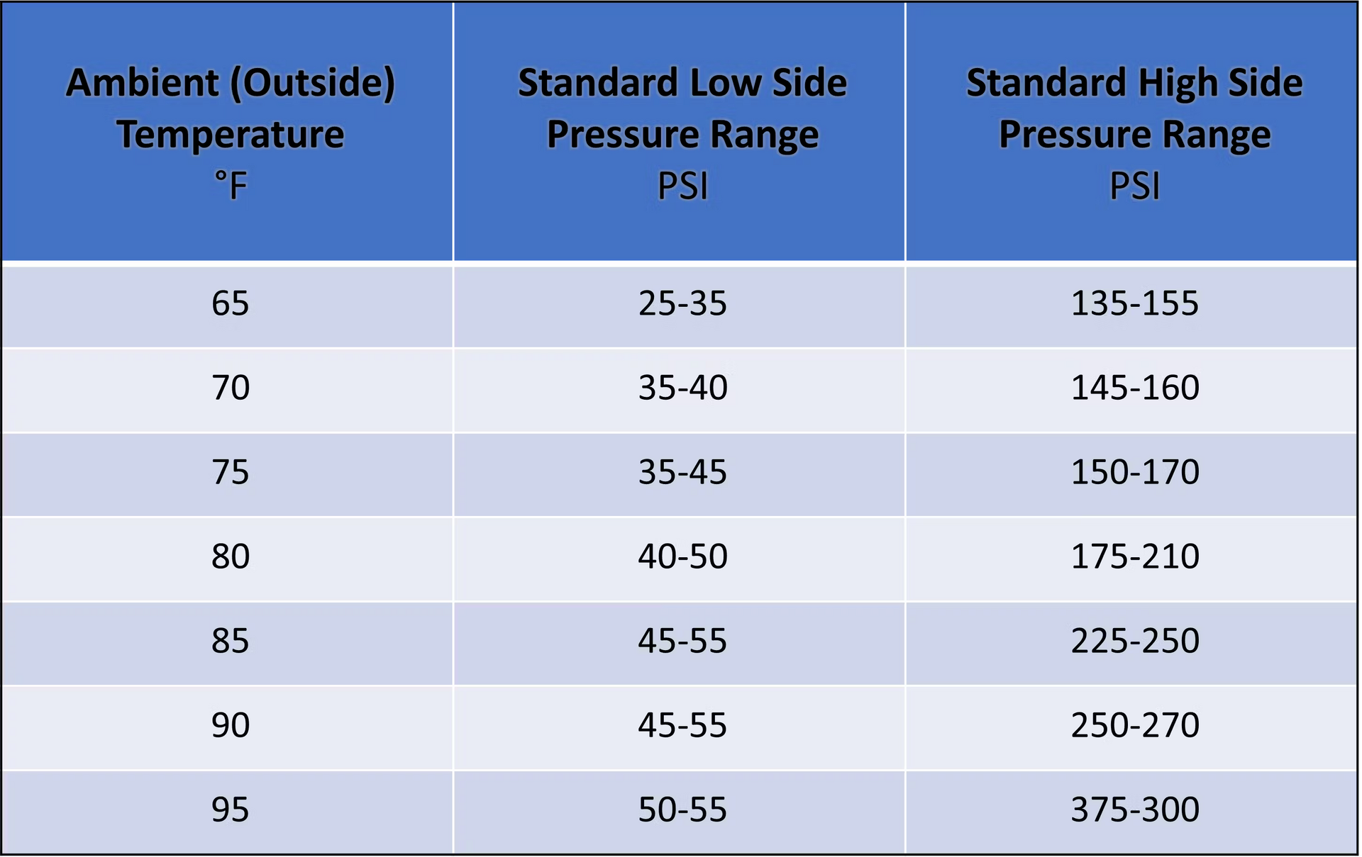

This chart is engine running AC clutch engaged. This is a baseline chart for R134 if your low side is less then 25lbs the low pressure switch will cut off the AC clutch if the high side goes to high a high pressure switch will also cut off the AC clutch. With engine off the low and high sides will equalize if they do not then you have a problem. This is a start. There are some really good troubleshooting charts on line showing how to read the gauges to isolate a problem. Typically a plugged system, bad compressor or both.
Yeah that chart is not accurate.....
