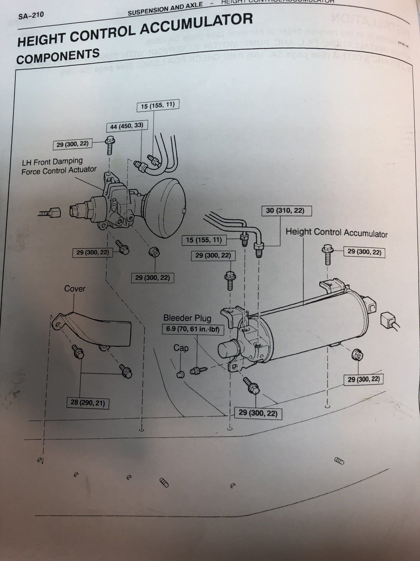

Does anyone have any tips on draining the fluid so as to make the least amount of mess as possible? I expect to get covered but I'd still like to try and manage it best as I can.
Fluid Reservoir: Get some tubing and syphon it out into your drip pan. You will likely get some in your mouth, but it really doesn't taste too bad.
Globes: Each globe has a bleed valve. Hook up some tubing and bleed the valves directly into a drip pan. As you slowly unhook the hoses going into the globes, make sure to have a drip pan under it and go slow.
If you decide to cut the hydraulic shocks off, just be prepared. They will spray everywhere. That was the biggest mess for my particular process. Wear safety glasses.
Hopefully that all makes sense.
