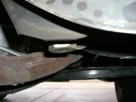

I recently lifted my truck with the AHC sensors and thought I would document it for others. My goal was to increase ride height about an inch and attempt to keep ride quality with the minimal lift.
First was moving the front sensors to the top of the slider. I have not messed with the heim joint yet.
Second was to move the rear sensor to the top of slider.
Next, you need to trick the AHC into thinking it is stock and remove some of the pressure from the system. Since the sensor slider adjustment basically raises it an inch, I added 30mm spacers to the rear coils (not in the above picture) and cranked the TB's 3 turns for the front. There is no mechanical or scientific reason for the 3 turns, just test drove it several times and got it to where I thought it was comfortable.
Eventually I will measure the pressure when I change my AHC fluid here soon and adjust the TB's so the system is back in spec. Who knows, it may already be close.
Measurements are as follows from bottom of wheel lip to fender lip:
DS F 30"
PS F 30.25"
DS R 31"
PS R 31"
Here is how it looks in AHC normal mode
