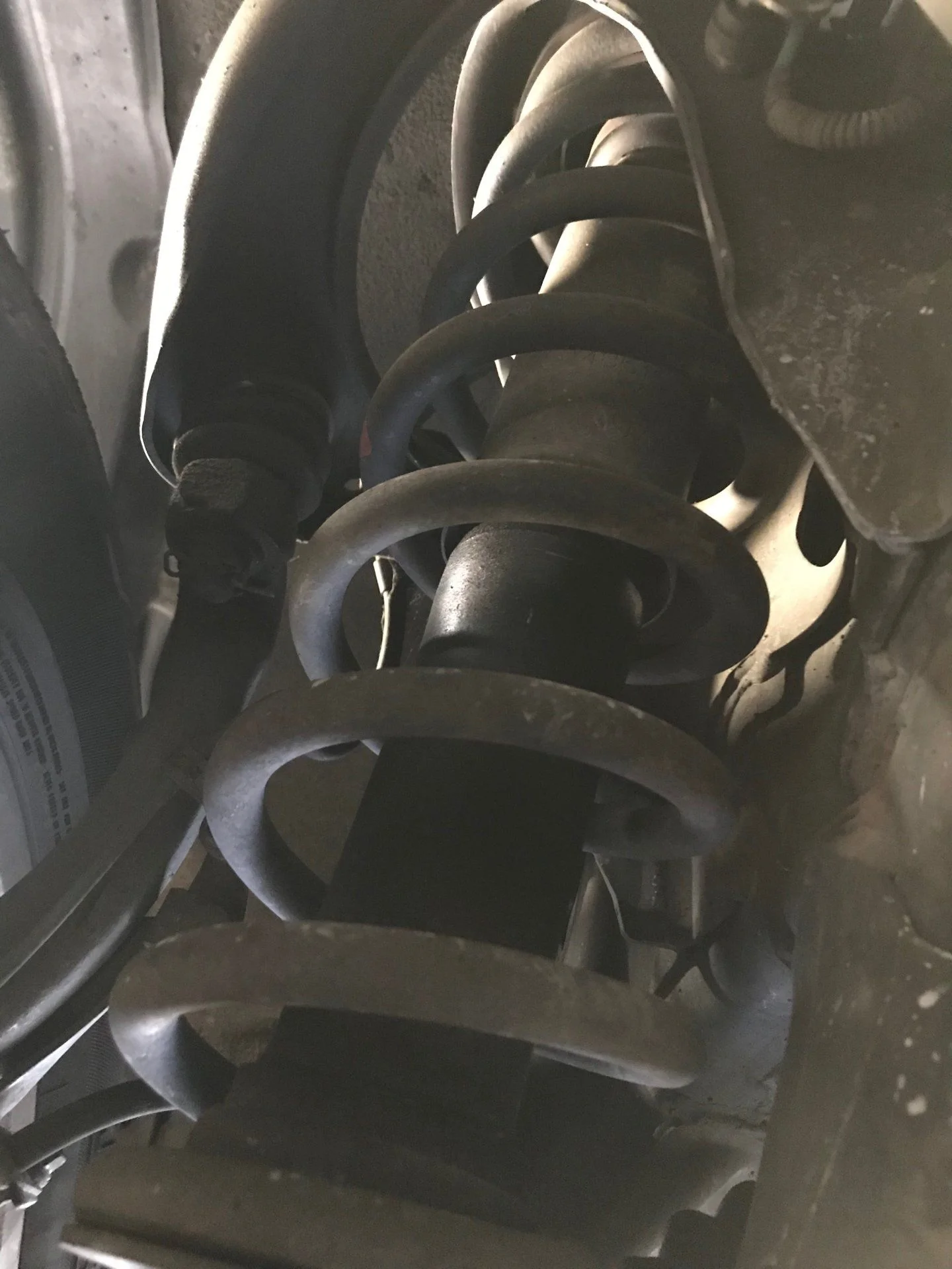

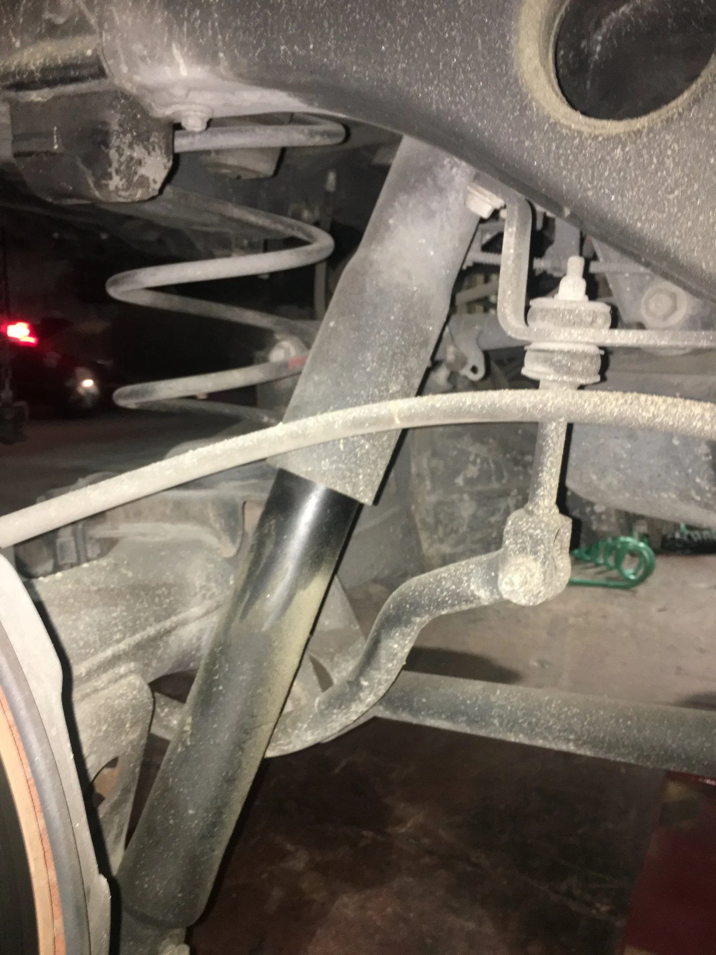

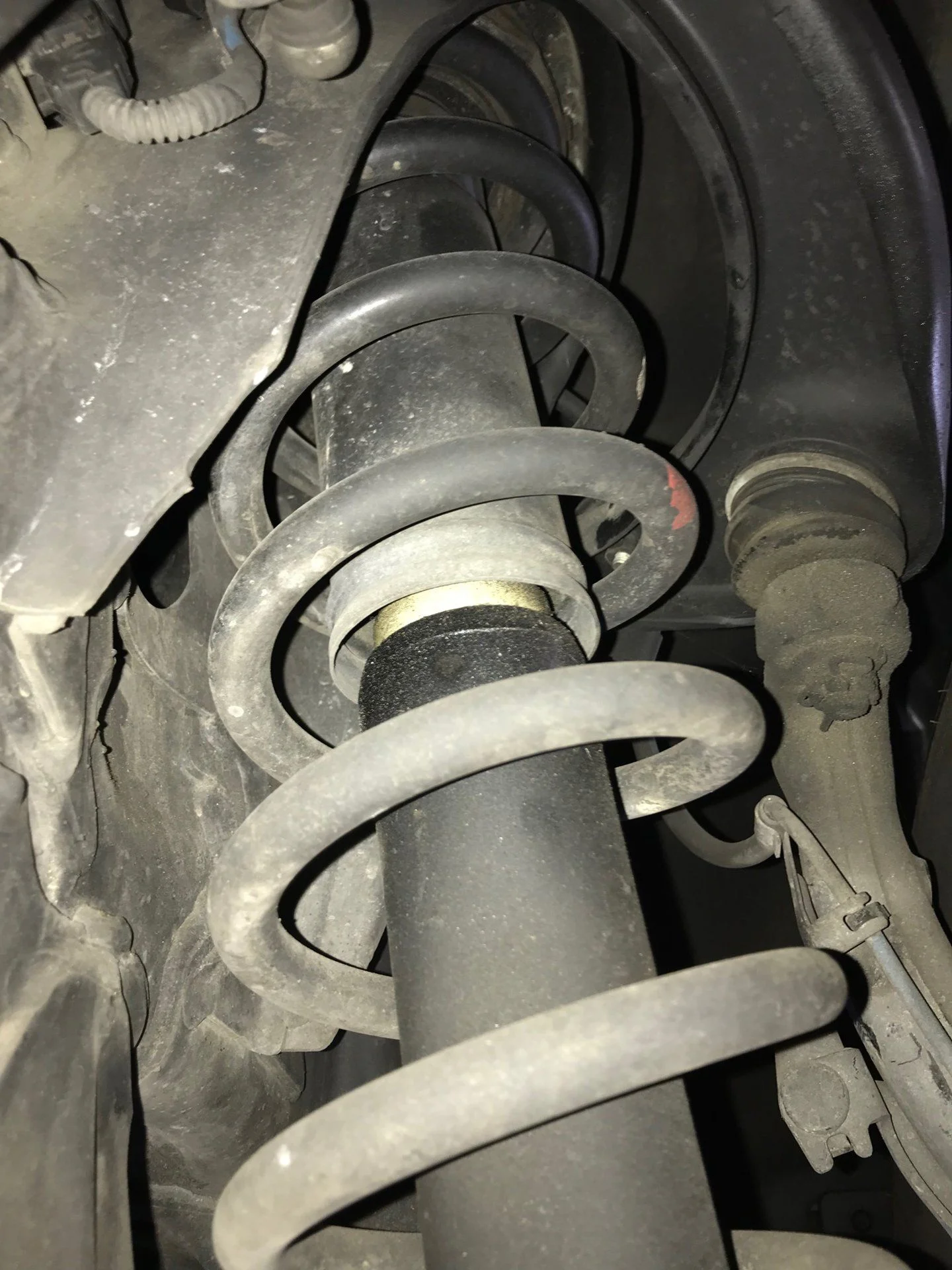

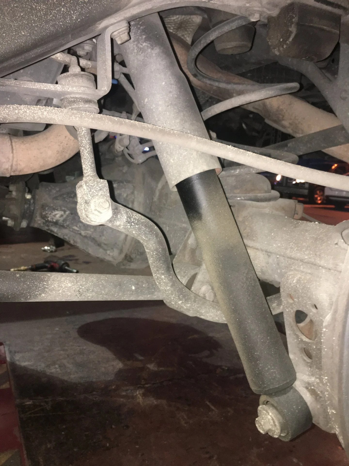

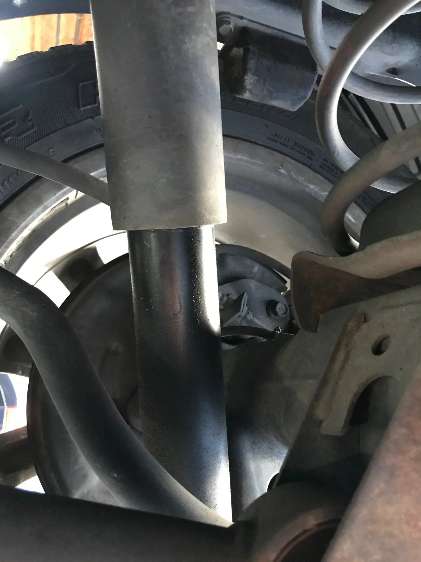

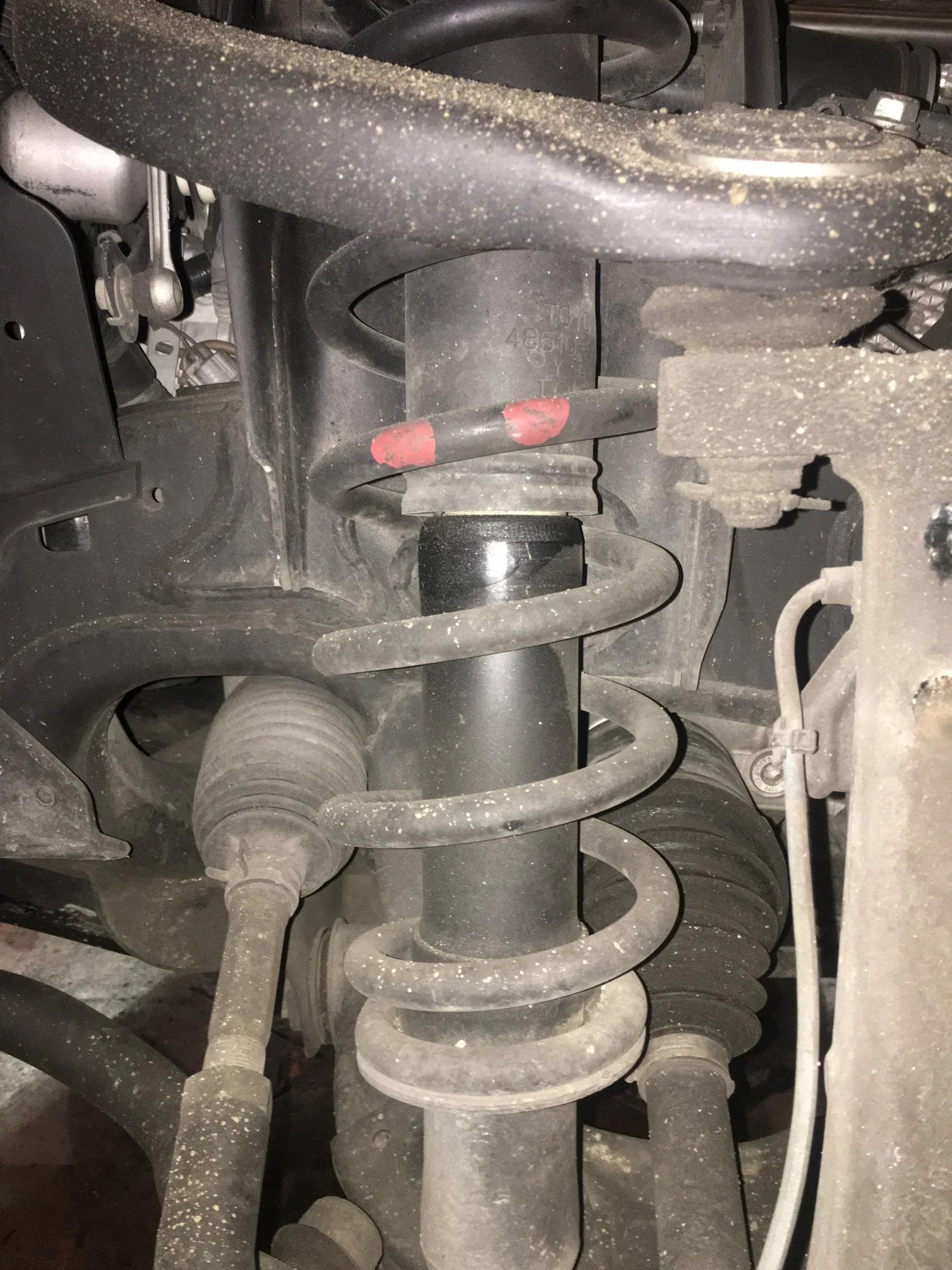

OK - need some advice on how to proceed with the AVS/AHC on my new to me 2008 LX. I just purchased my LX a couple days ago, and before I did I had some concessions made in pricing due to apparent AVS/AHC leak. (It's a 2008 with 113k, full Lexus service history). Based on pulling the service history from Lexus, it was recommended to the PO (at 110k) to replace at least one of the "shock absorbers" due to a leak. After taking a look and mechanic review, it seems more like "seeping" instead of actually full on leaking. I took it out for a couple hours of trails the day I bought it as a sort of mini torture test. Fluid Level stayed constant, and no additional evidence of leaks appeared.

Keep in mind this is not an urgent repair. with that said, if you plan to keep the rig for another 100k miles, I would do the repair on the two fronts. Especially if the dealer is paying. This is about a $1k+ job. You might consider upgrading the springs or adding spacers while you are in there, especially if you plan to build the truck, ultimately adding weight. Rear springs/spacers are easier if you decide to DIY. But the fronts require breaking open the hydraulic lines and require bleeding. And the dealer is already going to do this for you, as part of your purchase agreement.
BTW, when I purchased my 2010 LX with 100k miles, I too had the seepage issue on one of my front shocks. I paid to have both fronts replaced and the fluid flushed. To be honest, flushing the fluid made a huge difference in performance. Very noticeable.
Good luck with your LX! AHC is really amazing on these vehicles.

You are not saving much in the way of labor costs by doing the rears now. They seem fine by the pics. Wait until next ahc flush and evaluate the rears at that time. Other things to baseline now include exchanging fluids (brake, steering, trans, diffs). This would be better money/effort spent at this mileage, IMO. Especially if you have no record of these things being done.
