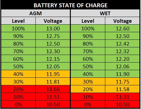

EDIT: found this on the internet. I guess fully charged AGM resting voltage is 13V if this is to be believed.
^ yes, that is right. The AGMs show slightly higher voltage than the FLAs. Out of curiosity, I just went out and checked an AGM battery that I have had stored unused for at least 2 or 3 weeks after charging, maybe more, and it showed 12.96V at about 80F. That is also why I charge it at 14.6V for bulk, not the usual 14.4V that I use for FLAs. (And OTOH I have never seen a FLA showing more than 12.6 or 12.7V at normal room temps after resting.)

It is worth noting that these resting voltages are inherent to the physical chemistry of the materials pair, nothing much you can do about those. (Of course, they are a function of the temperature and the level of charge but different story.) The common 14.4V of the charger / alternator during bulk charging OTOH is an arbitrary setting chosen by the manufacturer (because it makes sense for those materials). So it is entirely possible that a charger or an alternator would be poorly designed / out of specs / damaged / odd and give a different voltage (like 15V or more), but such a high voltage would be something to look into IMO if it's just a common alternator. That is also why I think that your usual alternator is set for 14.4V because the manufacturer expects you to use a FLA as a starter battery. Departing from that assumption by substituting other types of batteries may then give rise to problems. And that is also why relying on a typical 14.4V alternator to charge an AGM battery may not be optimal as far as keeping the AGM fully charged. (I'm talking about dumb alternators here.)
