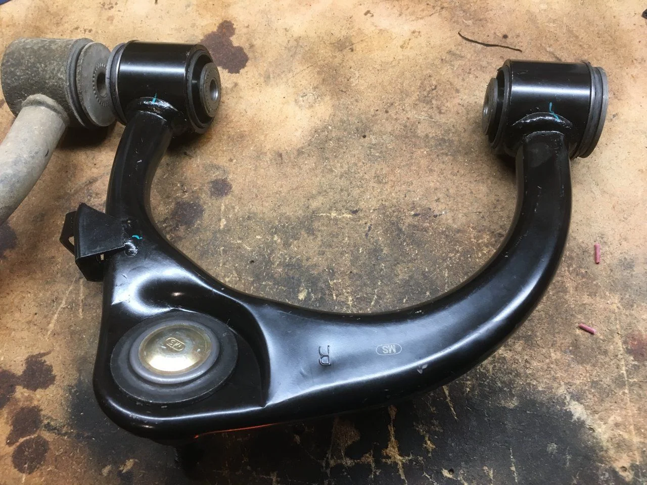

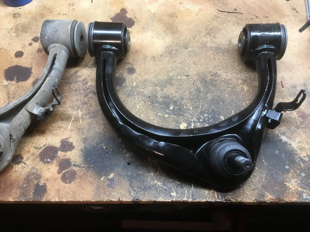

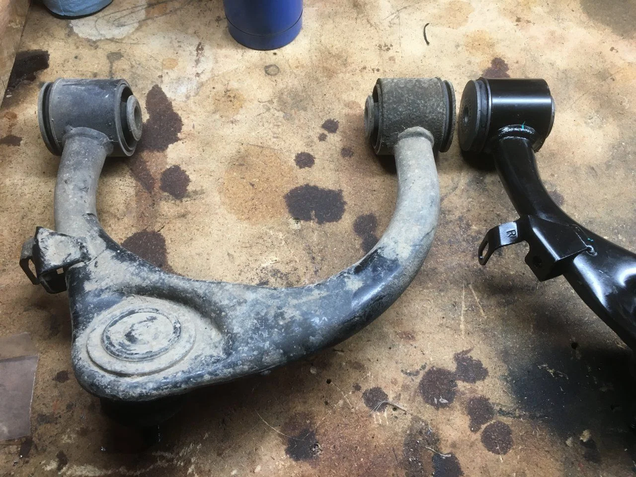

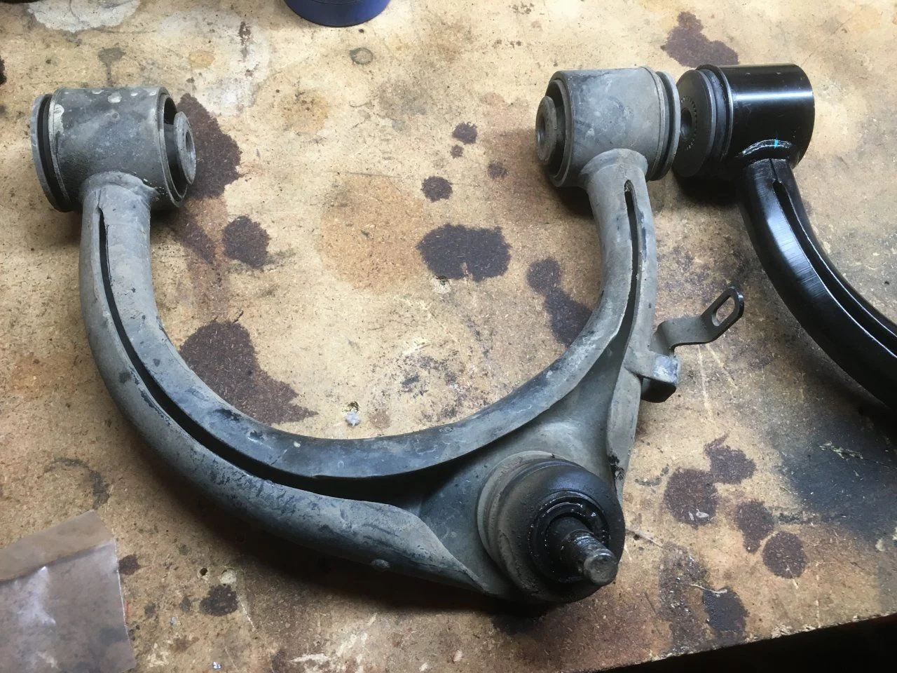

Here's a side by side shot of the original factory UCA's next to the napa "premium" replacements. So I decided to replace a few things in sequence as opposed to all at once. My lower ball joints are only about a year and a half old, so I put off on replacing those for now.
As you can see in the pictures, the UCA bushings were shot. They were original to the truck as near as I could tell, and with a 180k on the clock now, they were definitely past their service life IMO. Wish I would have have done this sooner since it takes about an hour tops but I don't normally travel above 45-55 tops for my daily commute so it didn't really bother me or cause problems.
This has completely remedied my sporadic road feedback/steering wheel shimmy at highway speeds.
Everything on the replacement arms seem high quality. Only thing I didn't like was the drivers side castle nut was not the same 19mm size as the factory and other replacement arm on passenger side, but I used it any way.
