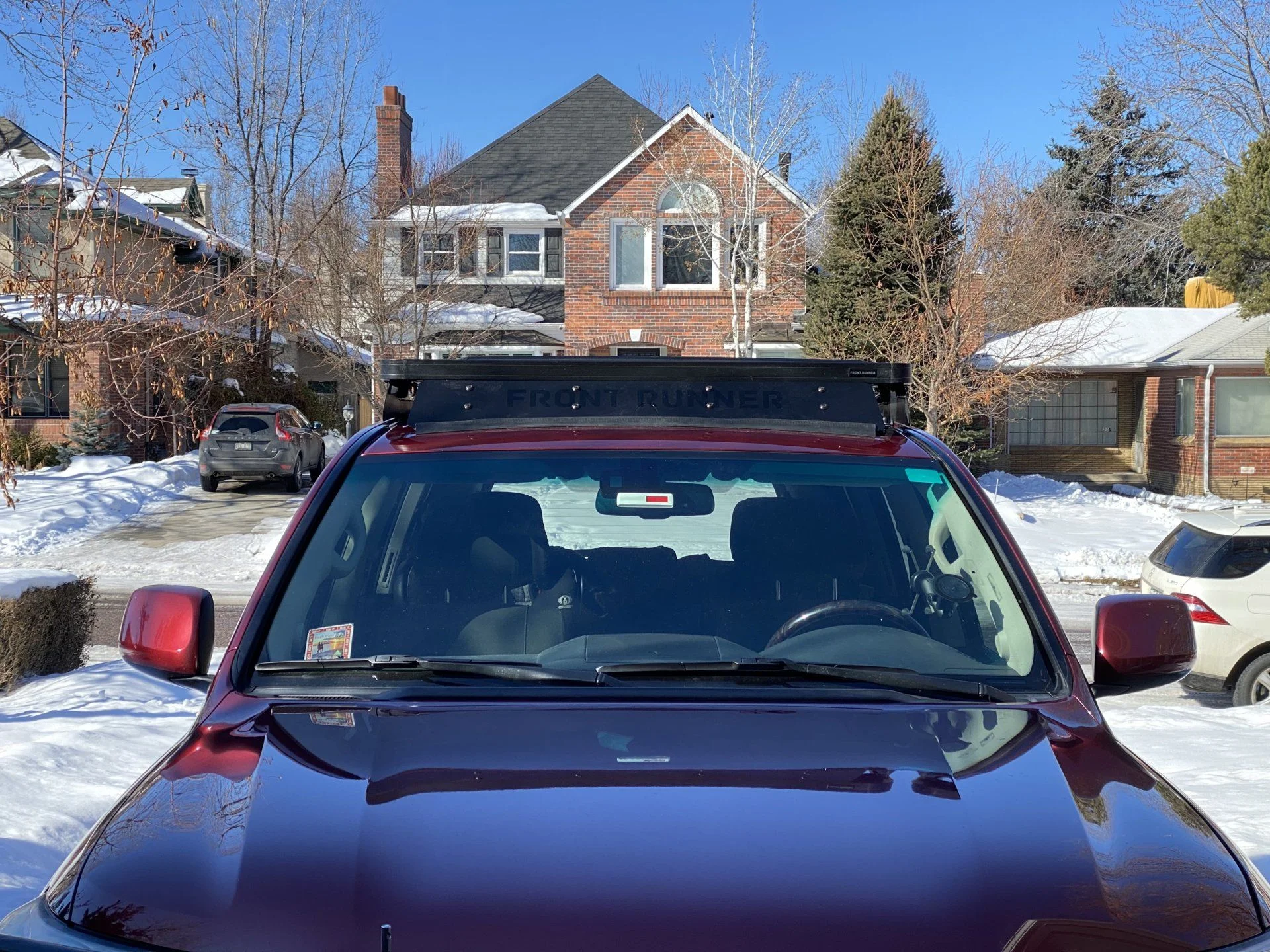

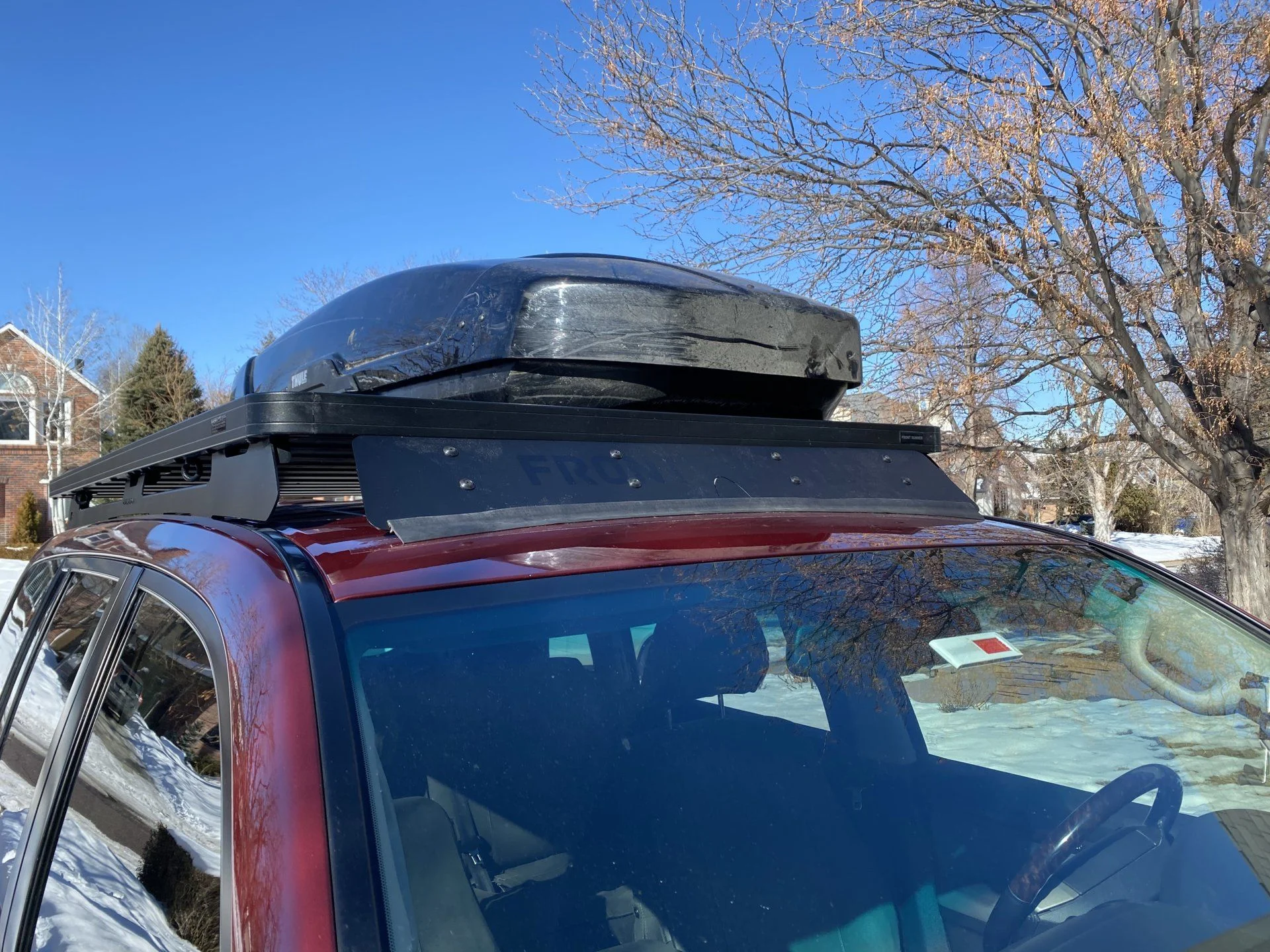

Major improvement. First test drive with ski box was noticeably quieter. Haven’t driven without the ski box, that obviously creates a ton of drag and noise itself, but overall this was a great upgrade.
And yep, as others have said, this should be the stock fairing that comes with the FR SL2. (Don’t mind the muck from I-70 ski traffic)

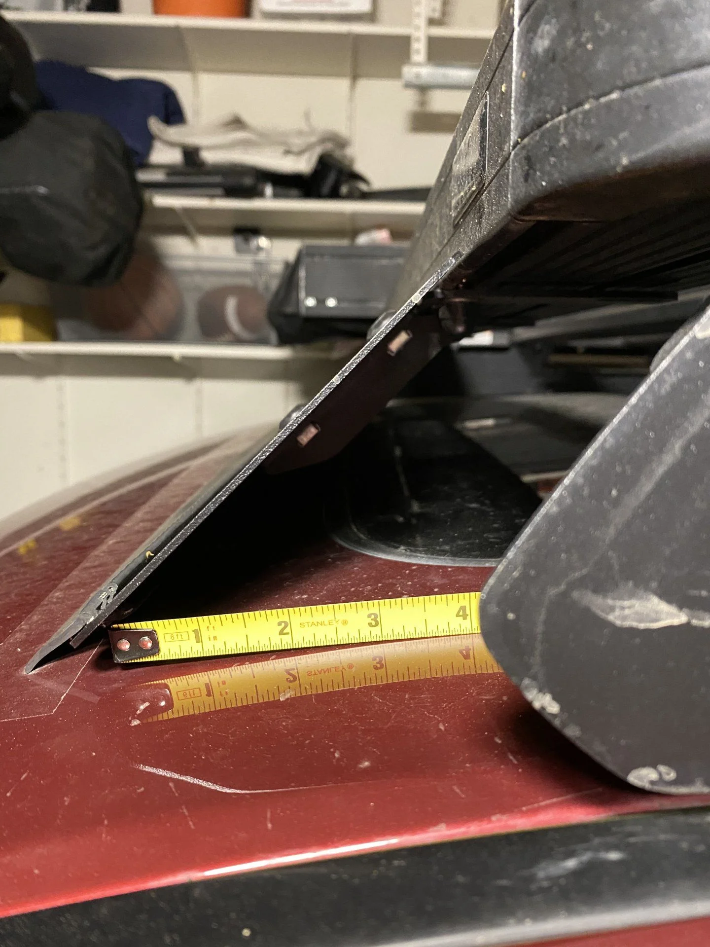

Looks great. Does the fairing sit on the sunroof glass (if you have a sunroof)? I spoke to FR and they said it may sit on the glass which seems like another poor design. I have about 4" of glass exposed in front of the FR rack so the fairing would have to reach out pretty far forward of the rack to not make contact with the sunroof from what I can tell. thanks

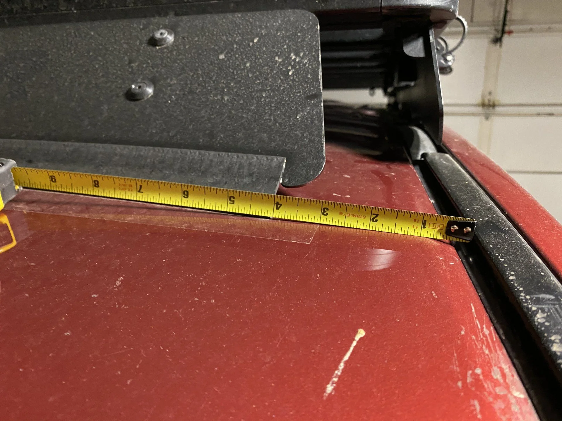

Here’s a photo showing the outward angle of the fairing relative to the glass of the sunroof - fairing makes contact with the roof about 2 1/2 inches forward of the glass and seal.
I suppose there might be some ability to slide the entire rack forward or backward but then you need to monitor the position of the rear shark fin antenna so it doesn’t contact the cross bars.
pay no attention to the dirt

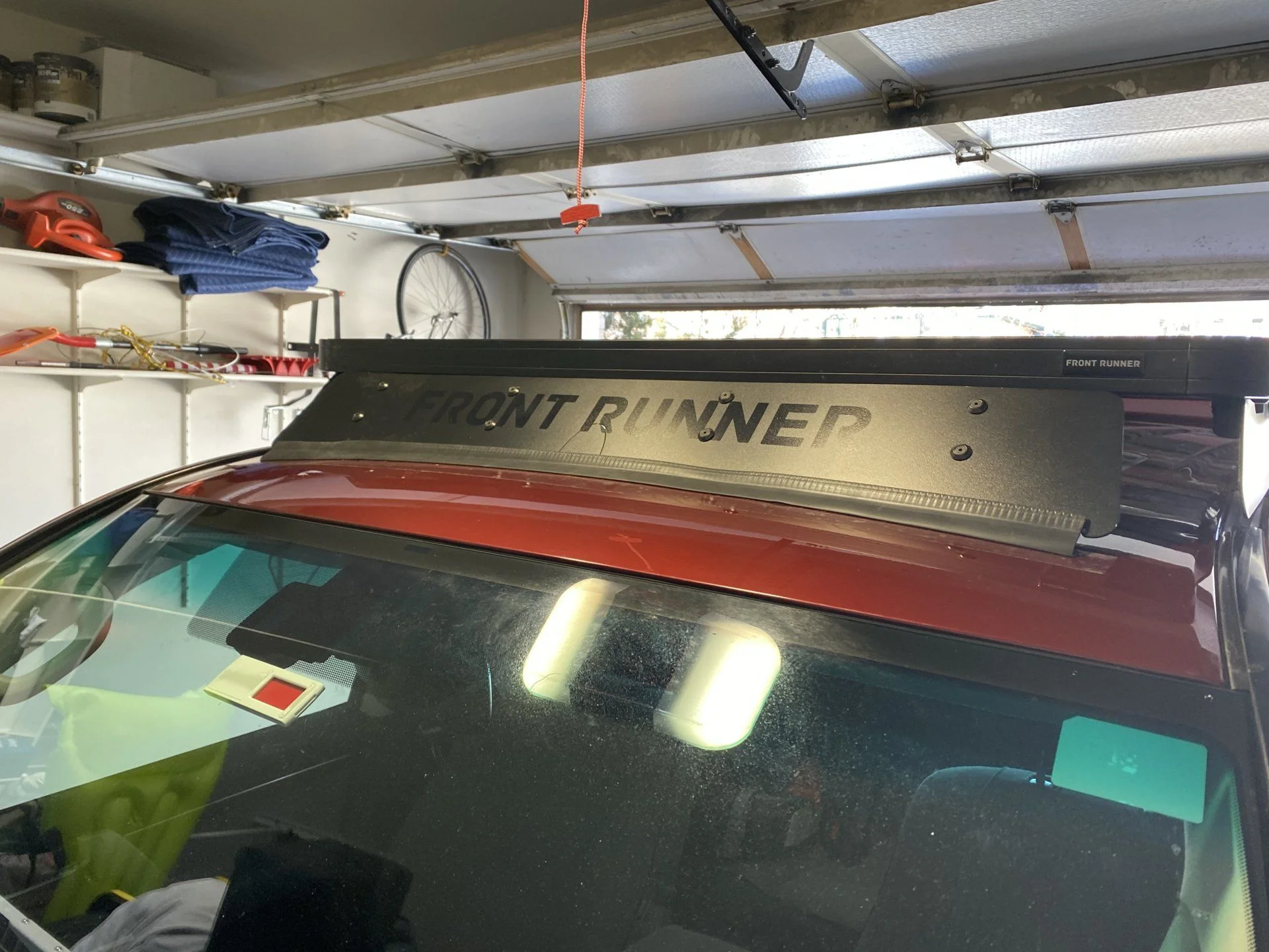

looks like it should have been a few inches wider so it went gutter to gutter.
To be honest, I wondered myself. I think they offer wider fairings? But they suggest this for the 200 S2 setup and others had installed this width so I simply followed the crowd.
Maybe the gap is this wide to avoid whistling? Plus it still allows you to bolt up accessories and reach the t-slots in those forward corners - perhaps that is by design?
fwiw about 4” between rubber seal and gutter or about 3” between fairing itself and the gutter.
I started with the wider faring thinking I wanted it to cover the entire race front. Too wide according to FR. I now have the same width as you are showing.
