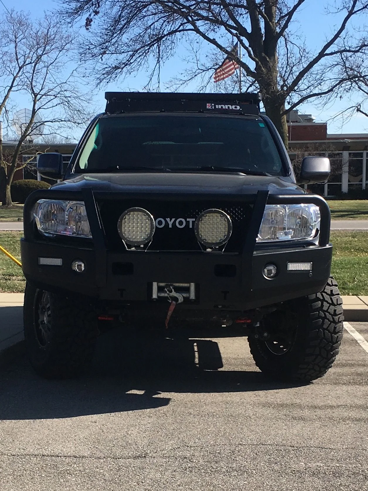

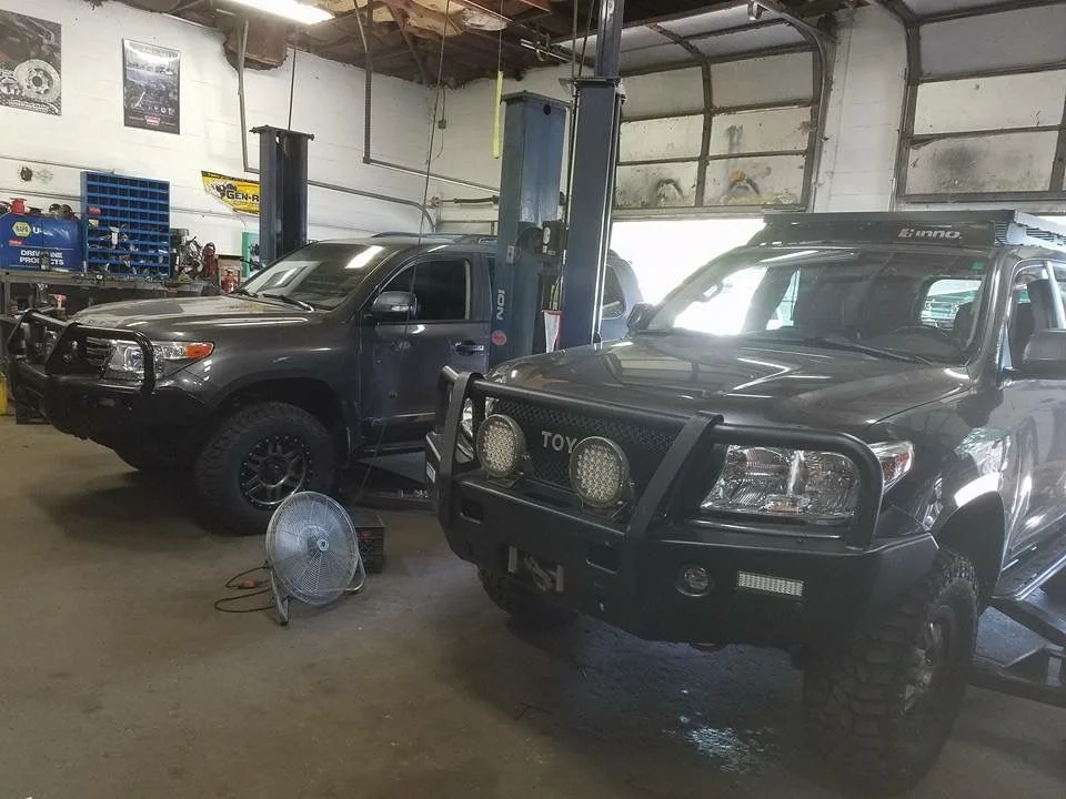

title says it all. has anyone figured out a cool way to improve upon the lame fairing that comes with FrontRunner Slimline 2? The 200 on the right has an Inno wind fairing attached. Looks pretty cool. Anyone have any information on it?

I bought and returned that Inno fairing because it was too short, and let wind get caught between the rack and made a whistle.
That said, I ended up making my own brackets and used a thin sheet of aluminum as the fairing. I also keep the fairing off the body (the inno lays on the paint, and it's just a matter of time before it shows wear) and cut it to send wind over the rack.

Due to the inno brackets being so adjustable i clamped them down over my led light bar and it killed a lot of the wind noise i was experiencing. Without the light bar being there I dont know how stable the fairing would be. Its easy and quick to remove if i want my light bar unobstructed and worked for my application so theres another school of thought on the inno solution. The stock front-runner wind deflector leaves alot to be desired.

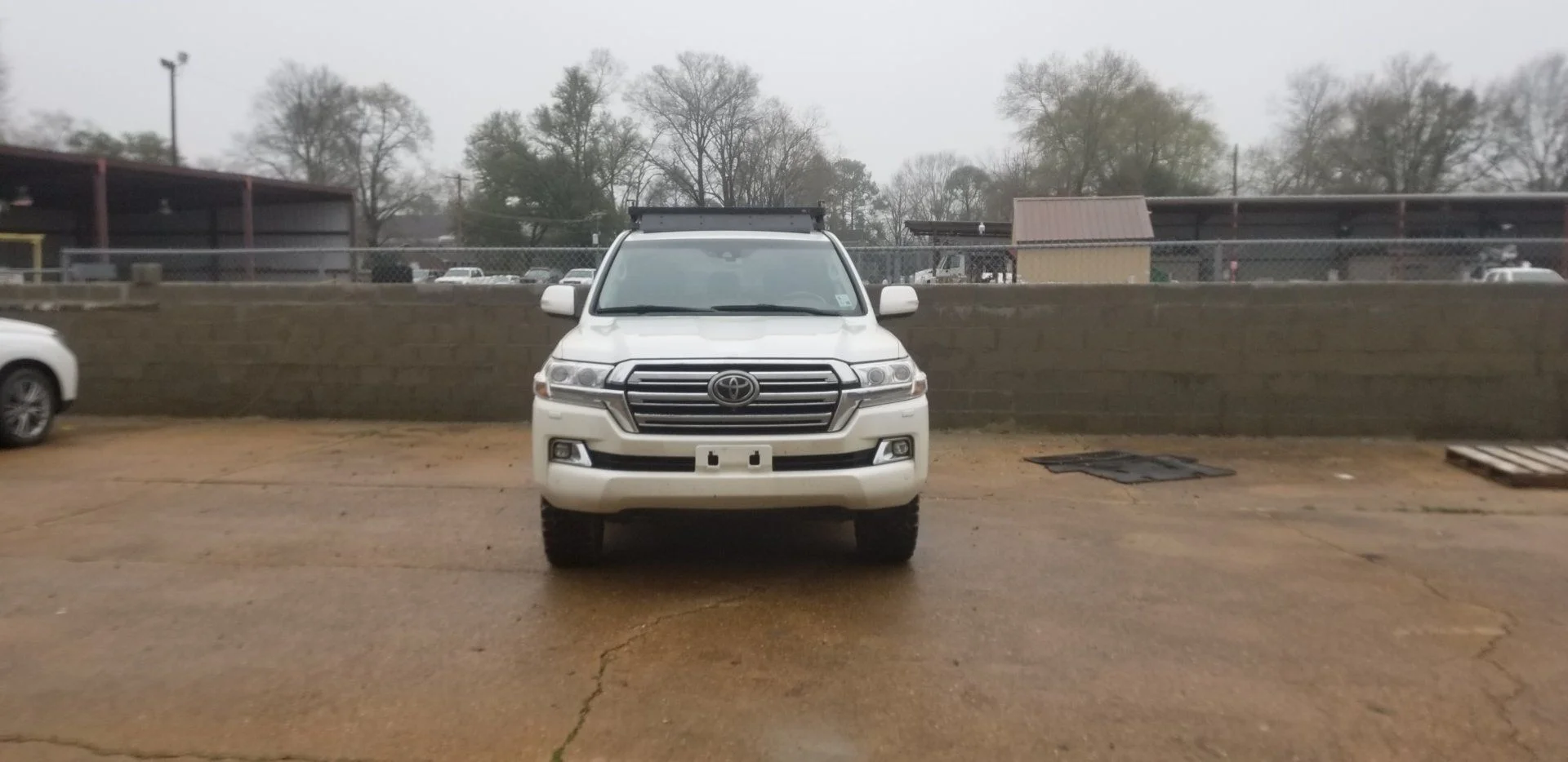

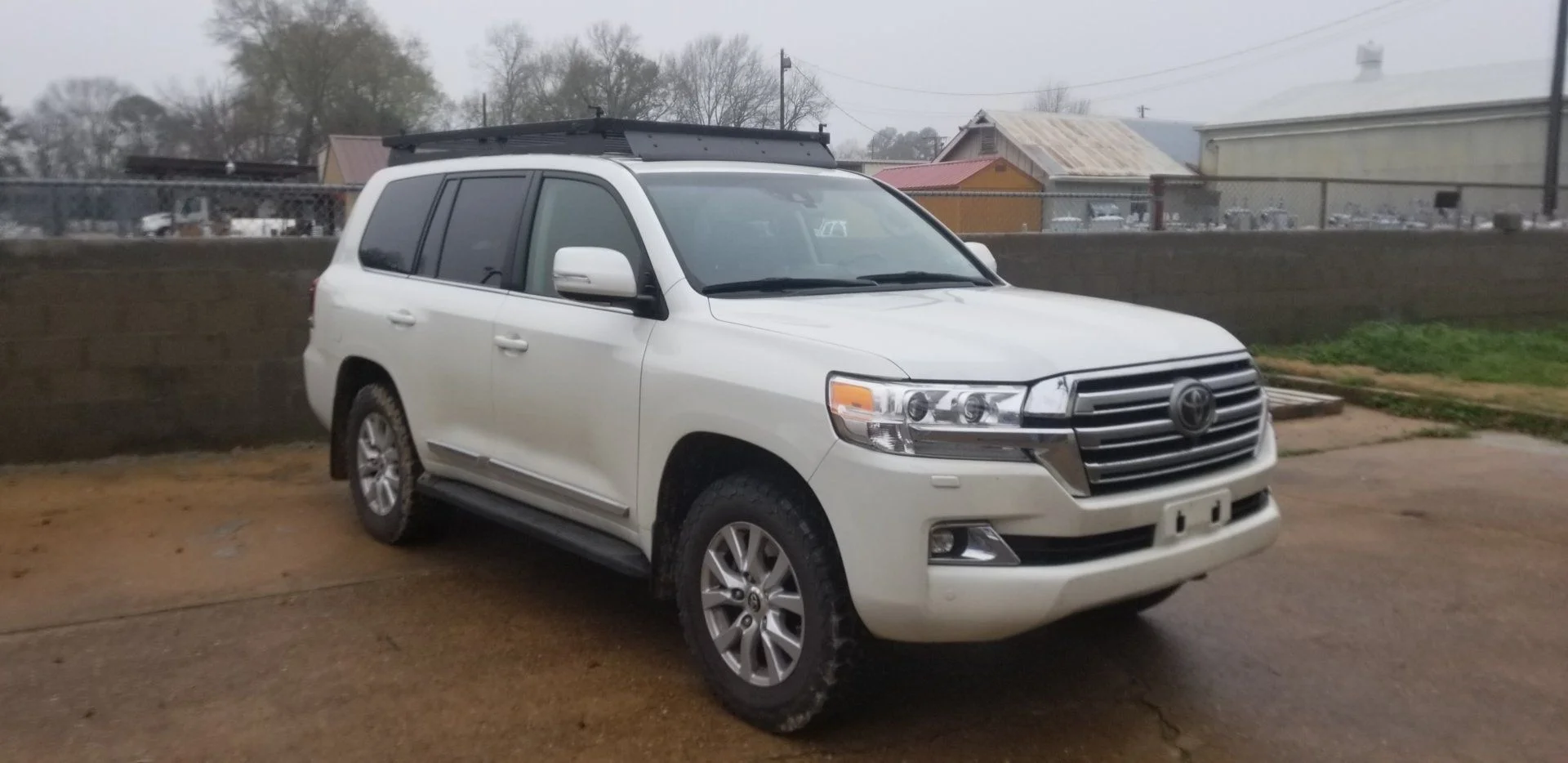

Installed in less than 30 minutes (including removal of standard fairing). I understand this product came out after the initial rack product, but this really should be the new standard fairing included with the rack. The difference in my 30 minute test drive was night and day. The noise is greatly reduced and I can open the sunroof with little to no air blowing inside at 60 mph. MPG numbers remain to be seen.
Pics suck because it's misting outside and not the greatest environment for a photo, but here ya go. You can't tell from the pictures because the quality is so bad, but it does say FRONT RUNNER on the fairing.
