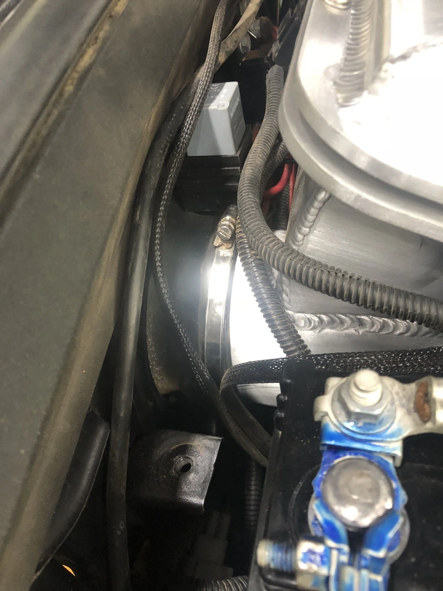

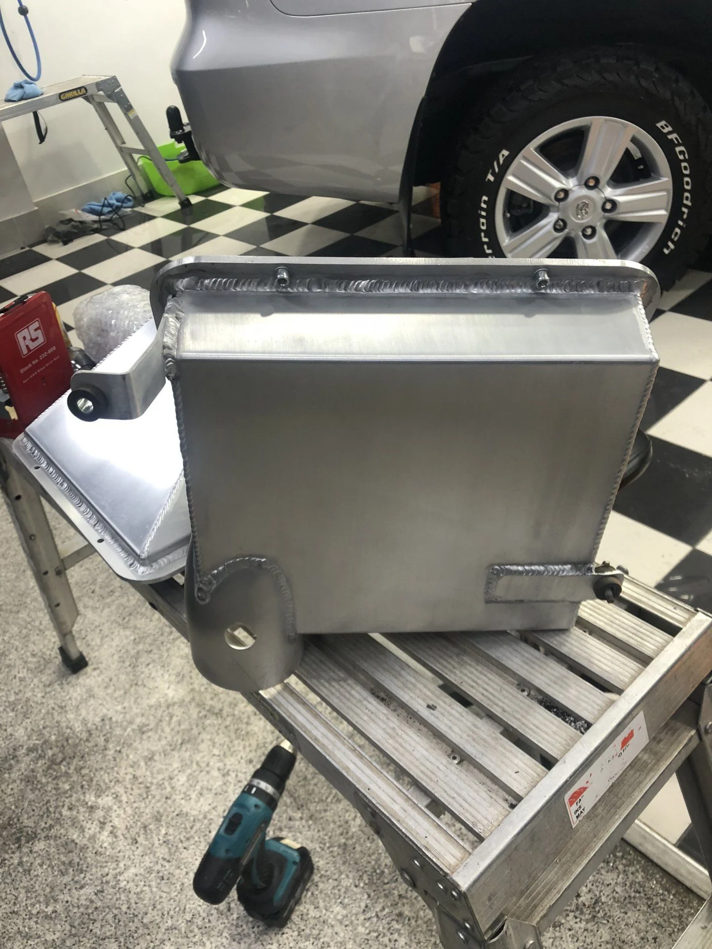

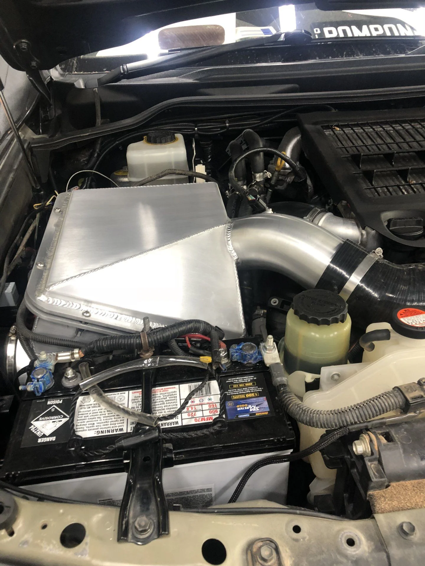

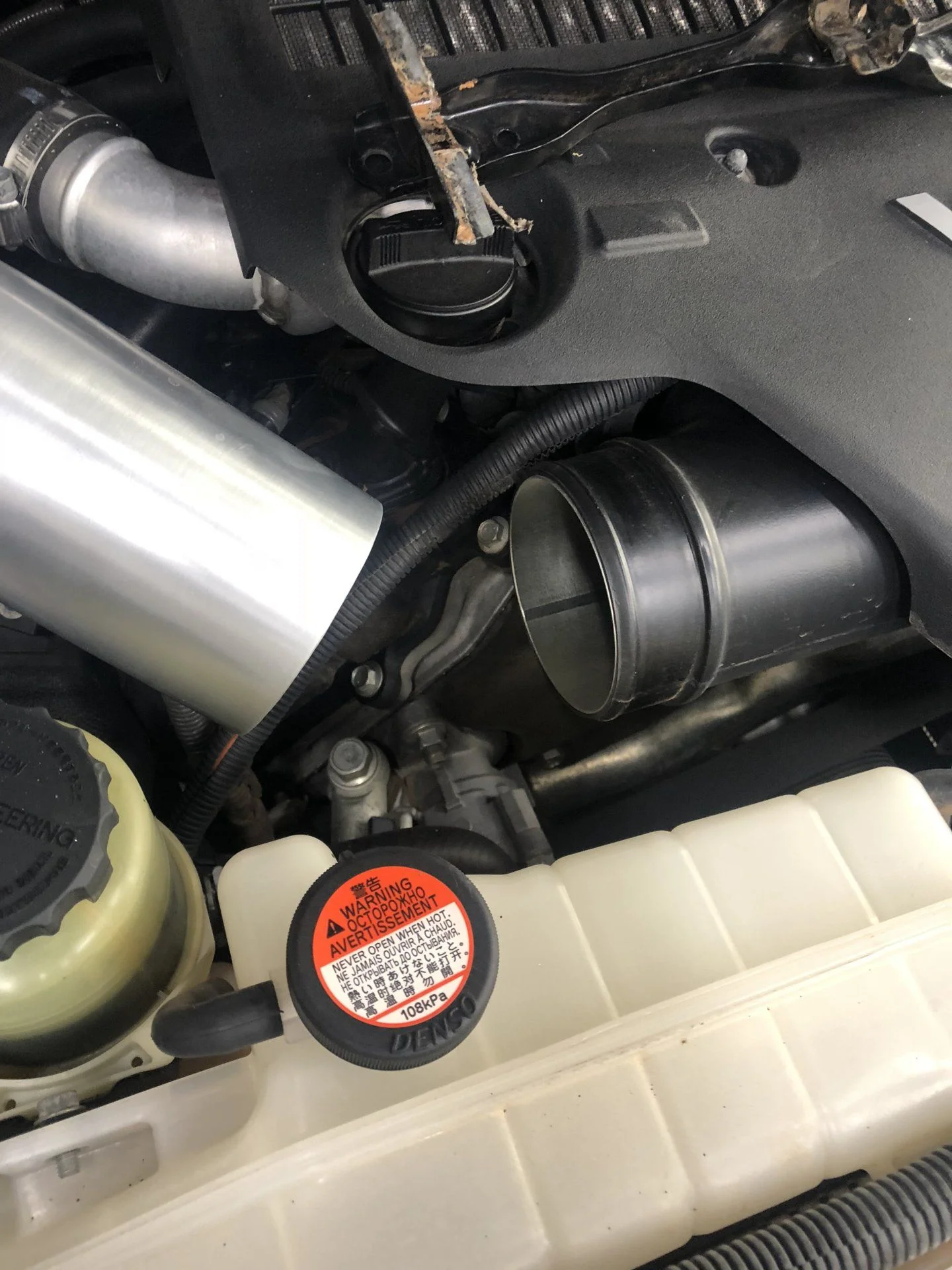

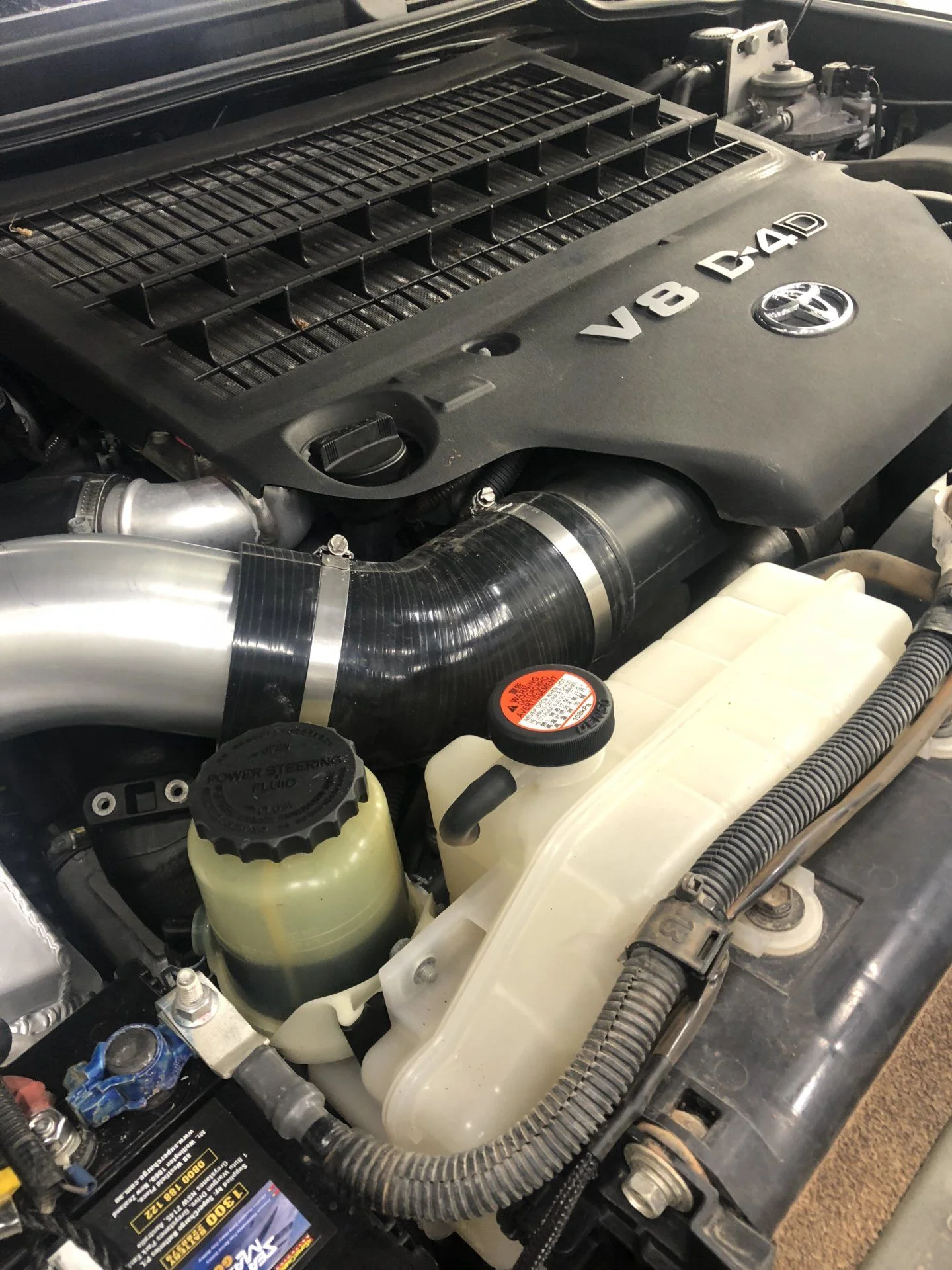

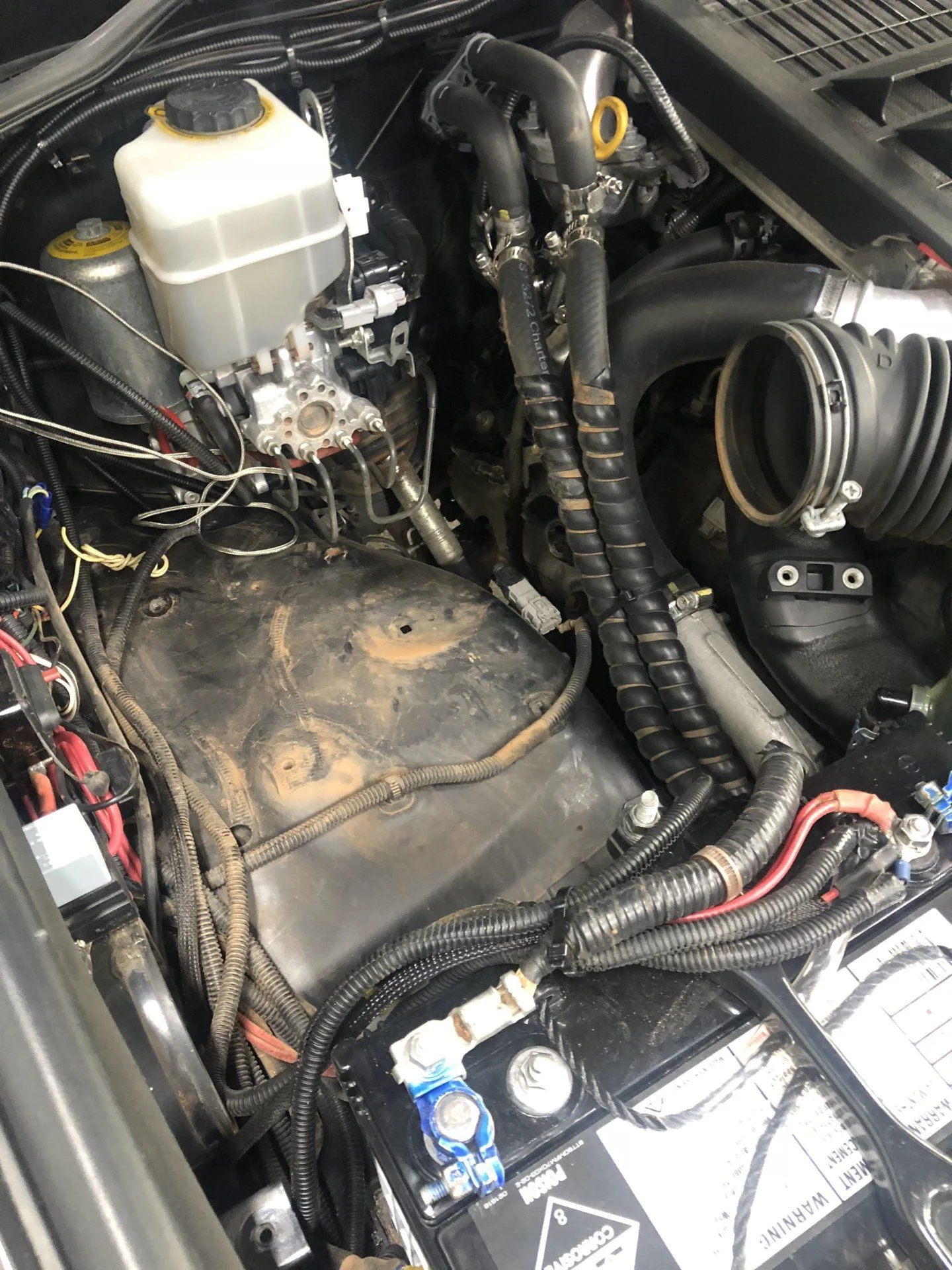

The issue with the airboxes is that they can warp with the heat and allow dust to enter from around the edges. The factory filter is average at best and can allow fine dust to pas though the filter as well. After a lot of testing, the Unifilter seems to work the best. K&N worse than factory. Ryco is hit and miss

Thanks for this mate, really helpful. Who makes that airbox? Looks pretty straight forward to install as well. So you run the Unifilter with this Airbox?
LOL, you already know me... This ones a AAA box, a lot cheaper than the moonlight fab one but they do great work. I know their ones with the window so you can see the filters are a very sweet setup
