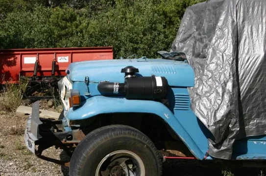

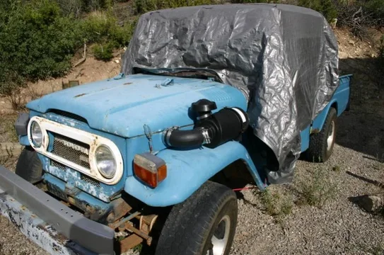

Here's one I purchased today. Sitting on the fender of my 45.... FPG070017 is the model. The FPG is the series.
Look closely behind the fender. The small tube pointing down at an angle is a dirt/dust drain and is the only part that must point down. The rest of it can be rotated just about any which way along it's longitudinal axis. This drain tube is one of the features of the new Donaldson filters. It's supposed to make the filter element last even longer.

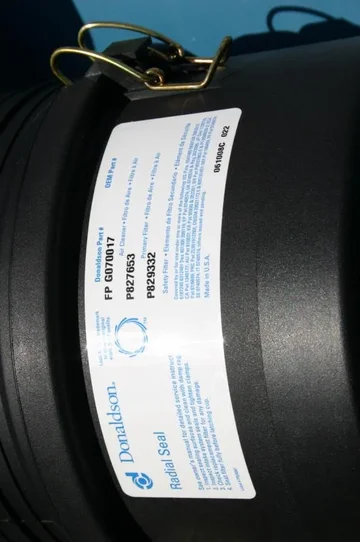

And here's the details on it. This is a kind of big model, but it has a 3" outlet, which matches the inlet on the turbo for this truck.
I purchased it locally at Albuquerque Filter for just under $120. In addition to the filter, I've got an intake cap, and a 90 degree tube attached to it.
Further note: this setup will, I think, be installed under the hood of Dad's 40 (with a 3B/turbo in it--see the sig for more info).
In addition to what you see here, there's a clamp that goes all the way around the filter and mounts it to the truck.
