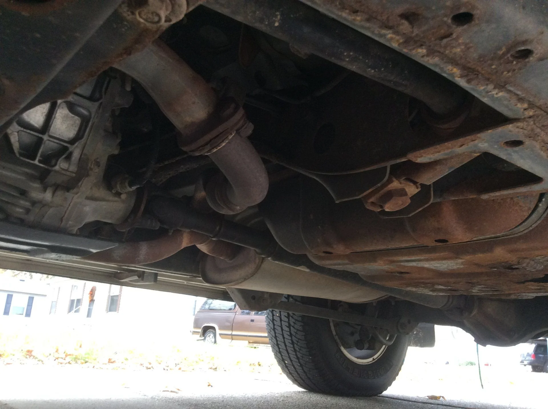

Hey Guys,
I had my car up on the lift and was changing the oil and greasing the zerks and noticed that the under carriage is starting to rust. I have had it just over a year and it was really clean underneath and no rust. I got the car from near riverside and I live close to the coast in San Diego so I am assuming the salt in the air is getting to it. Anyway, I am looking for advice/help with recommendations on how to treat this and what I should use, por15,fluid film etc...I know there are several post about it but I thought I could get better advice with the pictures for an accurate solution.
Its a 2000 LC with 81,000 miles
Also when I was under thee I noticed there is a connector that is not connected to anything. It's right above the oil pain and under another connector. Any idea what it is?
Thanks for any help!

What rust? I do not see any rust.
Automatic carwash with undercarriage flush once a month.
Yeah I know it's pretty light in most areas but it is a big difference between when I first got it last year. The original exhaust didn't even have rust on it.
Just want to catch it early. Maybe I am over reacting...?
You are over reacting.
This is my truck, I am not worried in the least.
I live in the rust belt.
My truck will be long gone before this is an actual issue.
The rate at which your truck is "rusting", you have another 100yrs of life left in her.
