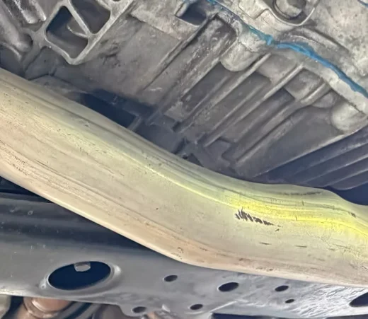

I don't like the way they ran the exhaust below the t-case. It is just a regular exhaust shop job....nothing special.
The cats hang low... Mine are tucked into the frame.

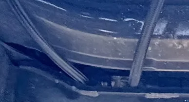

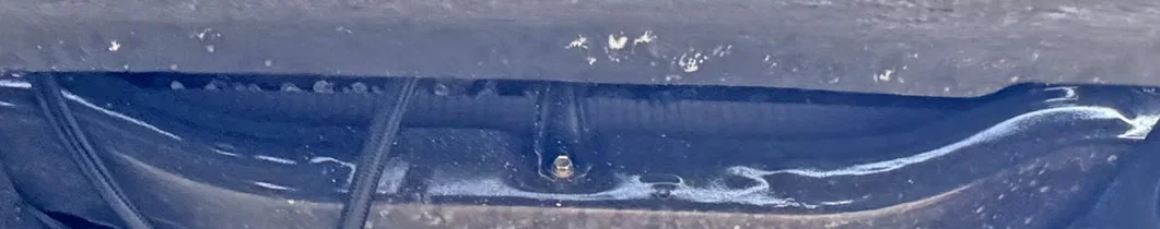

The fuel lines, running outside the frame, look sus. Band Clamps?
The rear brake lines are also run outside the frame....??? This is asking for big trouble...There is a reason why factory run them inside the frame, away from areas that tires can send road debris.

The oil pan looks really close to the front diff. The clearance there is something to watch for if you take it off road.

Found another pic of the fuel filter from the other side. They did run the high pressure line across to the passenger side...the other line on the other side with band clamps might be the return. I prefer using factory fuel lines like I did. The factory goes to great lengths to keep the fuel lines out of harm's way . Running them above a driveshaft is not a good idea.
The rear brake lines are also run outside the frame....??? This is asking for big trouble...There is a reason why factory run them inside the frame, away from tires.

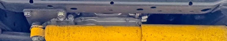

fix. Other things like the rear driveshaft looks original, didn't even bother to paint it, and a used steering stabilizer just slapped back in place.
