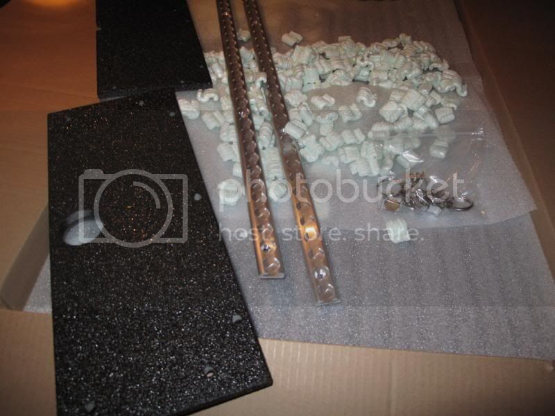

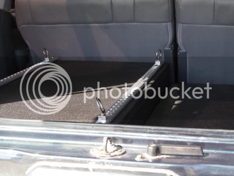

Included in my order was a Versitrack Lashing system. This consists of two, 36" long aluminum tracks, four anchor points and the mounting hardware.
The drawers arrived via Fed-Ex. As hard as they tried to demolish the contents of the box as evidenced by the box's being totally thrashed, the contents were damage free. A testament to Adventure Trailer's excellent packing job. It was one of those moments that your afraid to open the box and your debating on calling Fed-Ex back to pick them up. I don't know if I would have signed for them, but since I was at work she signed for them without even looking at the box's.
Be wary if the Fed-Ex guy offer's to put your packages in your garage for you. :rolleyes:

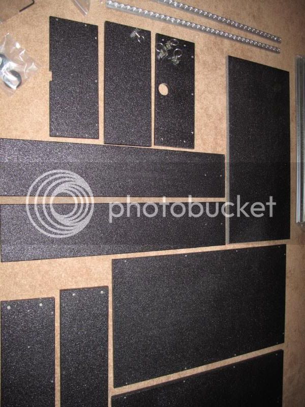

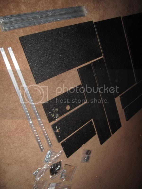

Enough ranting about Fed-Ex, back to the drawer's. The drawer's arrive in kit form. They come with detailed instructions, high quality hardware and even the required allen wrenches.
Immediately I noticed how heavy the slides were. For some reason, I didn't think they would be that heavy. They are stout for sure. The rest of the hardware is also top notch quality. The Line-X type liner is sprayed on evenly, but had a strong chemical odor when I opened up the shipping box. I'm happy to report that the odor has disappeared over the last couple of days.
The construction process went well on the first drawer and really well on the second drawer.

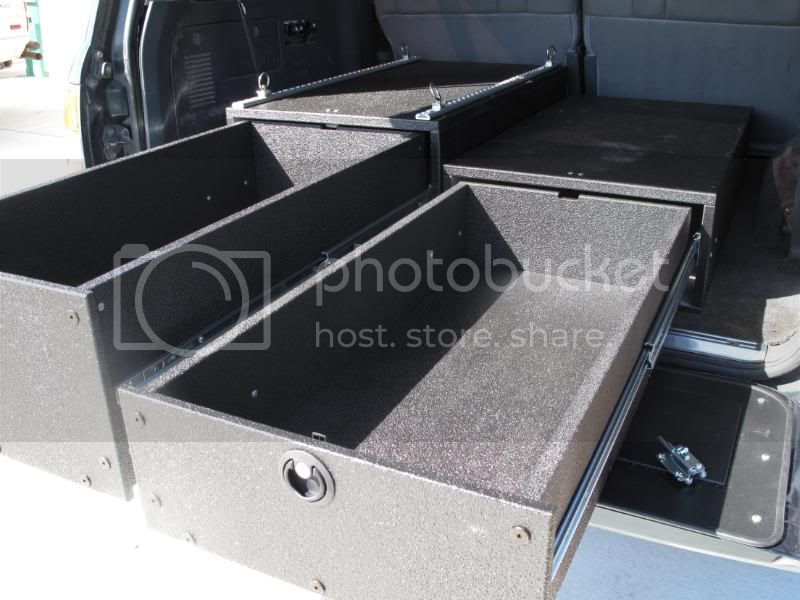

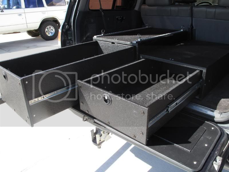

Here are some pics of them installed in my 80.

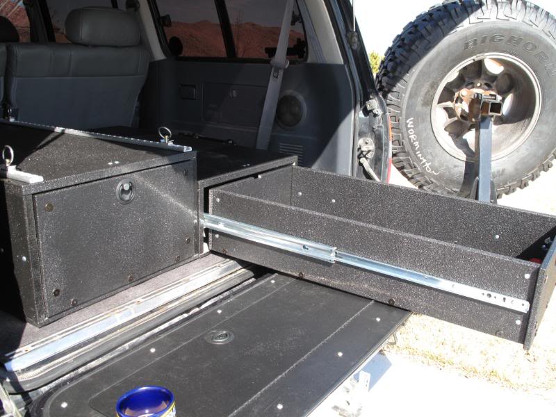

You can see that the drawers enjoy full motion of the slides. Everything in the drawer is presented right in front of you. There is no ducking and peeking to see what's in the end of the drawer.

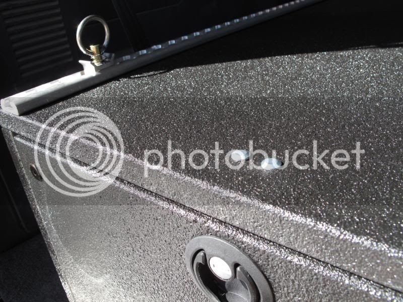

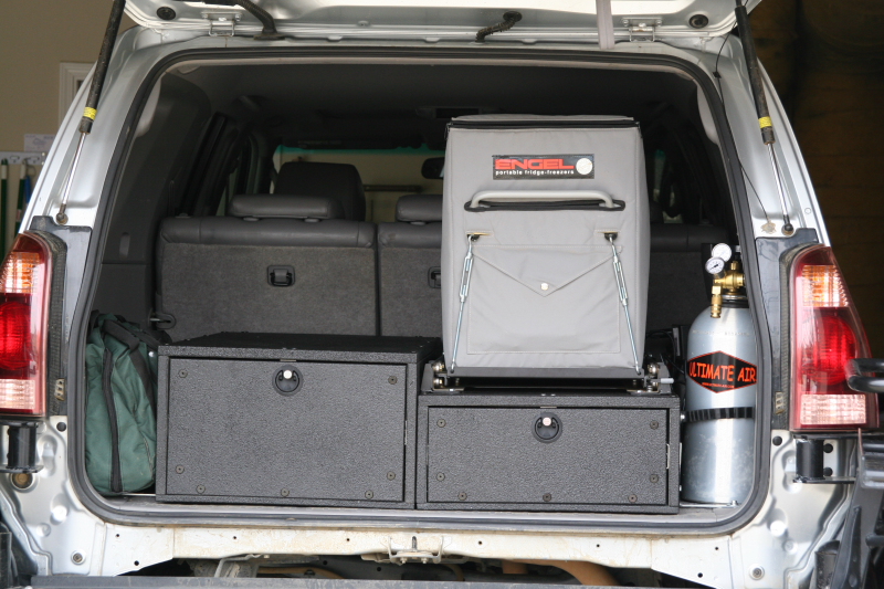

Pictures continued.

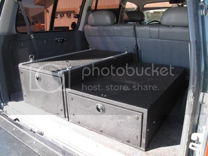

Height difference
Close up
In idea of how high they come up with the tailgate closed.

How did you mount them to the floor? They do look real nice.
Thank you for the compliment. I got in on the group buy of the allen head bolts and washers from 619TOY. I removed the factory seat brackets and bolted them down that way.

The 8.75 box/drawer comes in at 38 lbs. fully assembled and ready to install.
Spresso was over and picked it up before I installed them. He just posted up on ExPo that while installing and removing his African Outback drawers numerous times in the last week, he was quite certain that his frame outweighed both of my drawers.

Andries, unfortunately getting a locking slide of this quality and weight capacity wasn't possible. We are working on a method of keeping the slide in the fully out position. It's going to be an easy retro fit.
Ben, we use a composite made from layers of urethane and glass fiber, called "Fiberthane". It's extremely strong and light weight and is very resistant to water. We finish the composite in Linex.

Yeah Loud- I kept them, but I haven't installed them into the hundy yet. I made a template of the third row seat bolt pattern and transferred it to the drawer bottoms. I then used bolts that matched the factory holes (Pitch & thread) and bolted them down to the floor of the 80.
Since I haven't looked under the carpet in the hundy, I don't know what the bolt patterns look like. I may have to make a spacer that bolts to the drawers then bolt the spacer to the factory holes. The spacer idea doesn't bother me too much, because the drawers would sometimes barely (Like RCH) rub on Kevin's hinge for my tailgate storage unit. Of course that depended on how loaded the drawers were.
If the hundy has the same size holes, I think I ordered extra bolts and pressed washers for the install since they were so hard to source. If I have them your welcomed to them.
Interesting, I'm going to order a pair of 36As this week. I was thinking of using the slee diff drop skidplate spacers on the mounts to take up the room between the floor and drawers that the carpet makes.
