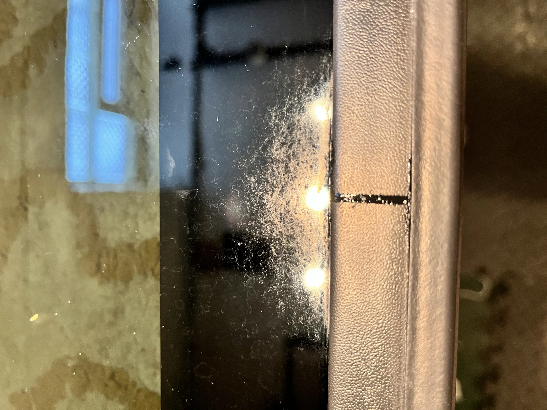

My initial thought was to do just that and replace the whole unit. That's essentially been my approach with all maintenance and repair for the last 15 years. For the sunroof glass, it's not overly expensive and the job isn't really a job. That said, I think if you find the right sealant/adhesive product it could be effective for quite a while. After a bit of research I've decided on a silicone adhesive, basically gasket sealant, because of its thermo properties, UV resistance, and flexibility after curing. I happened to have some that I ordered from a water pump job. Here is a picture of what I used and the repair. Will let you know if it is effective.

Updating this for archival purposes to help the next guy. So far so good on the butt joint repair as shown in the photo using the toyota brand silicone gasket adhesive i had on hand. It's been through the car wash with no leaks.
